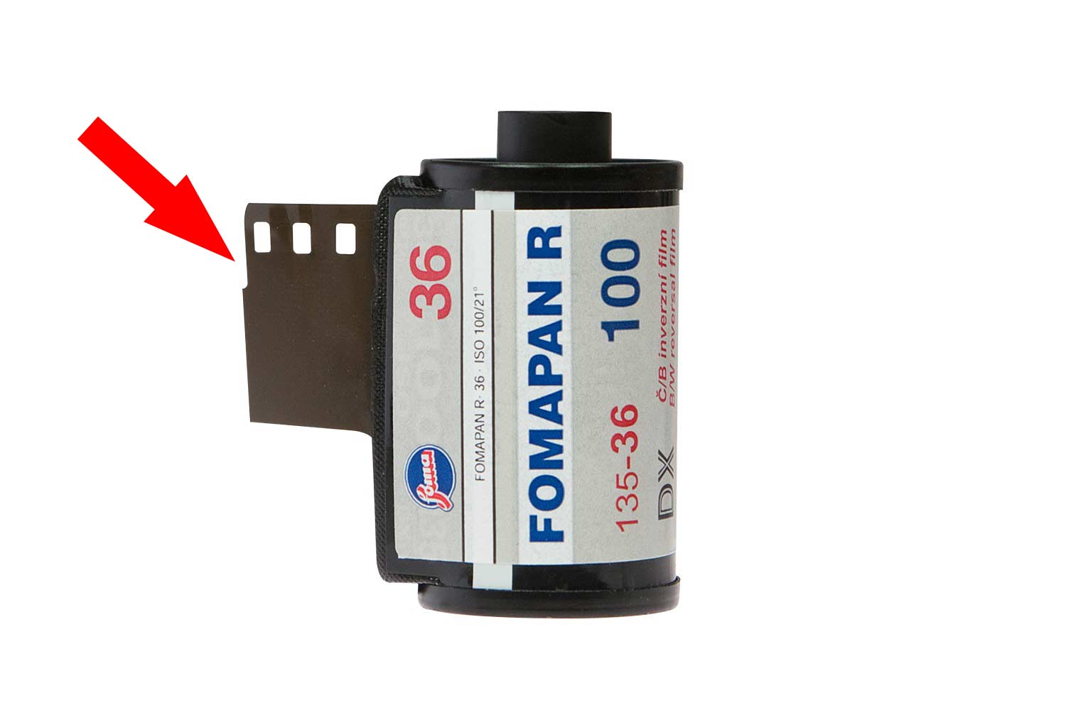

Can you show a photo of the Lomo film with the film tongue showing fully, please?
Does the tongue look like this. (note the notch at the end)?
