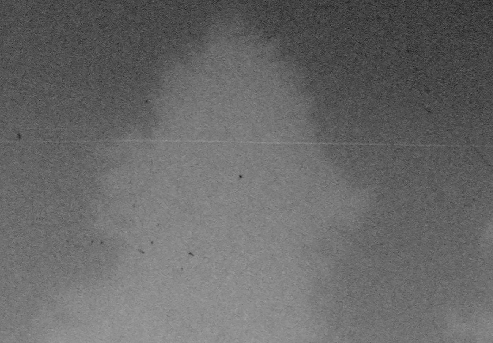

In August, I purchased a 10-roll "cube" of FP4+ in medium format. Every roll from that batch had exactly the same problem: a strange vertical line going across the entire length of a roll, shown as semi-transparent line on my scans without well-defined edges as shown below:
Upon examining the negatives, I quickly found the line on them, so it clearly was not a scanning problem. What was interesting is that it's not an emulsion defect. The line is clearly visible on the back side of the film, i.e. the side which usually is covered by the backing paper.

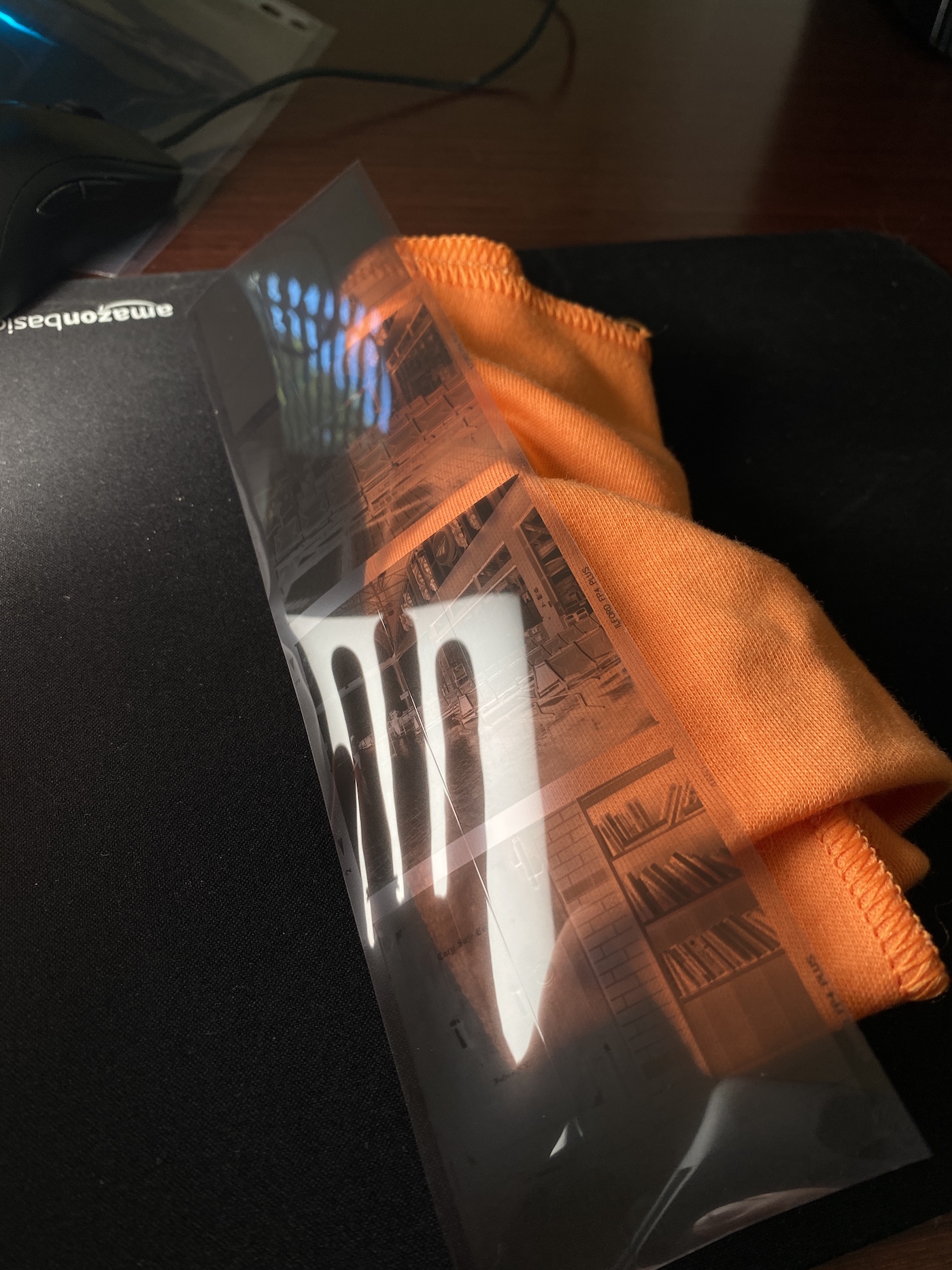

Closer examination with a high-powered loupe (can't share here because I can't take photos at this magnification) revealed that it's not a scratch, but a strange abnormality in the thickness of the film base. It is only visible at certain angles, I did my best to try to capture it on a cell phone here:

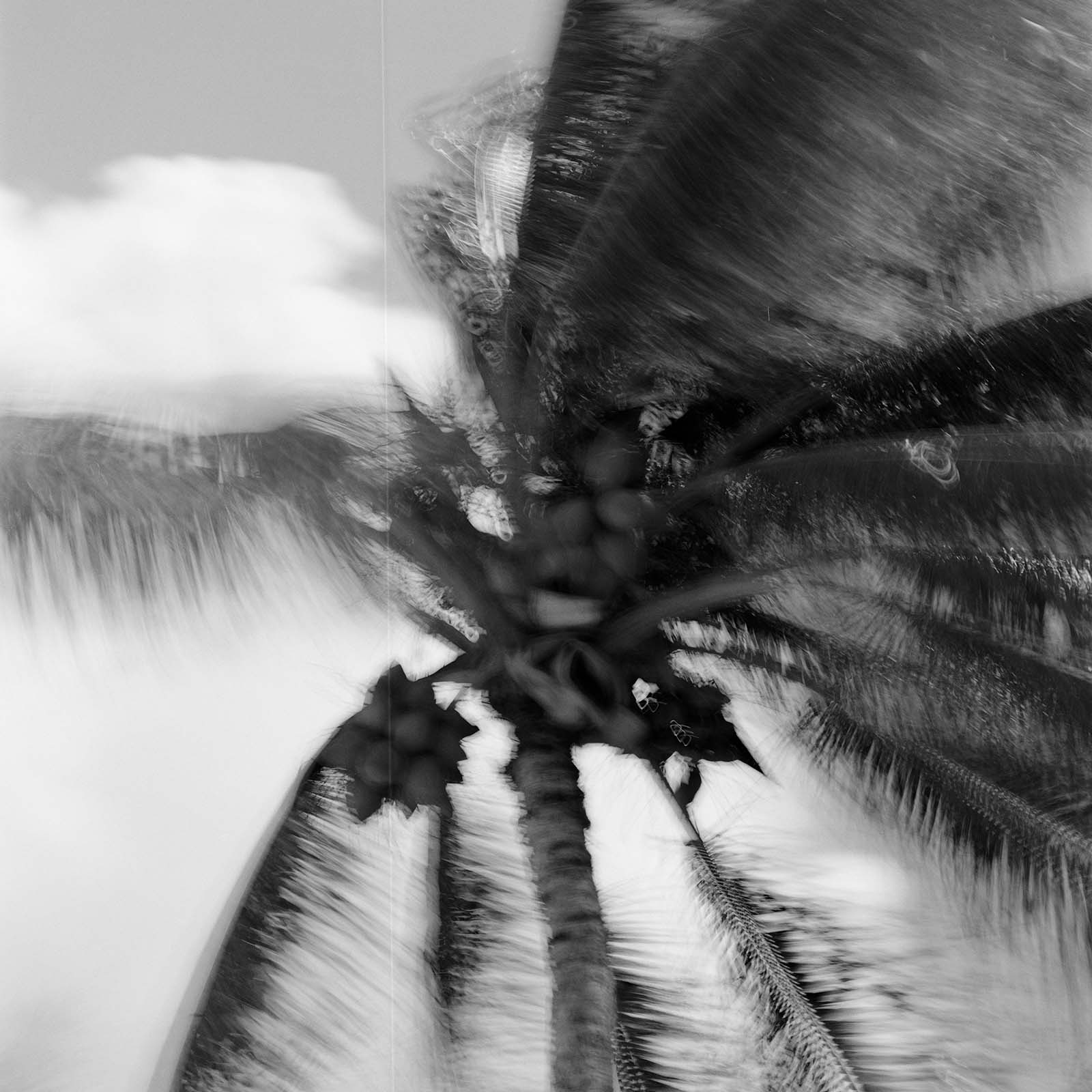

Andrew, that line doesn't look like the one in the OP. For one thing, yours looks wavy, whereas the one in the OP is dead straight.
Maybe it doesn't look like the OP's line, but there is a line that runs the entire length of the film.

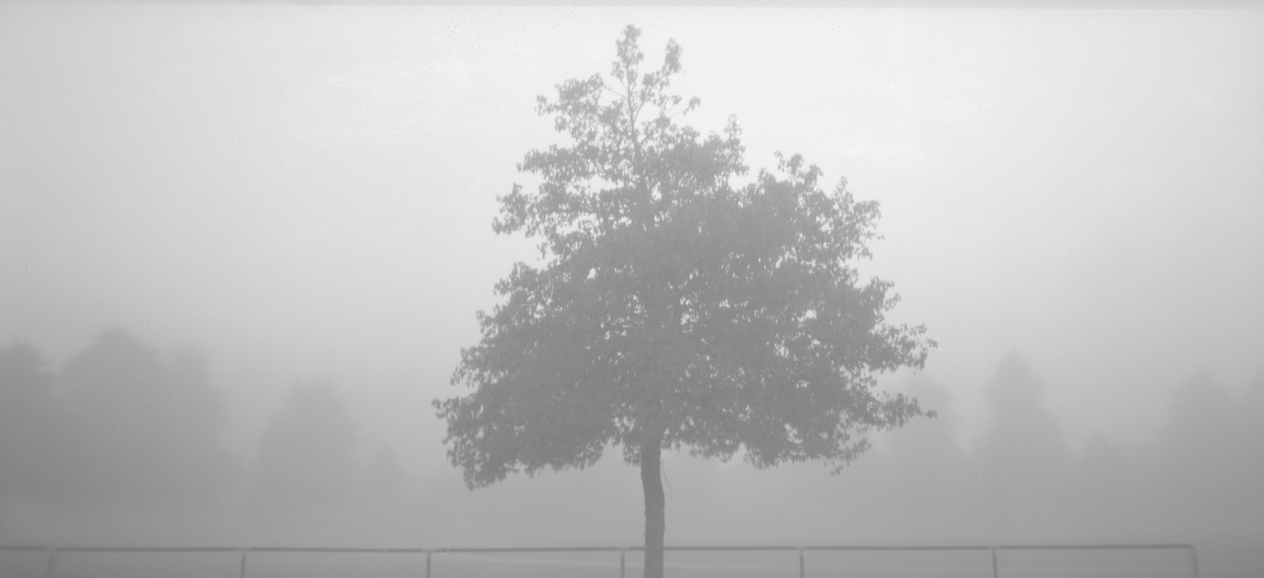

I scanned in one of the images at very high rez. I can only see the line in an even toned area and on when I zoom in. Otherwise, I don't see it.

The line through my negatives isn't as visible as the OP's. Like I said, I can only see it if I zoom in. At any rate, there is a line there so I would like the film's replaced. I've already heard back from Ilford, and they would like me to send a photo showing the defect.

I haven't made a print yet but I can clearly see the line at about a 4x enlargement, especially in smooth toned areas.

The negatives arrived in the mail today. I set-up my enlarger to make an 8x10 print, and then I exposed a 5-inch long test strip. The stray line is clearly visible from top to bottom. Diffusion did not hide it.
I tried rubbing acetone on the back-side (between frames) to see whether that would remove superfluous gel. It had no effect.
Upon examining the flaw closely, I see that the line is rather wide, considerably wider than a scratch one might get from a microscopic piece of grit in the camera. Naphtha might or might not hide it.
At this point, I suggest that Steven try naphtha if he has a glass carrier. Or re-shoot the scenes.
