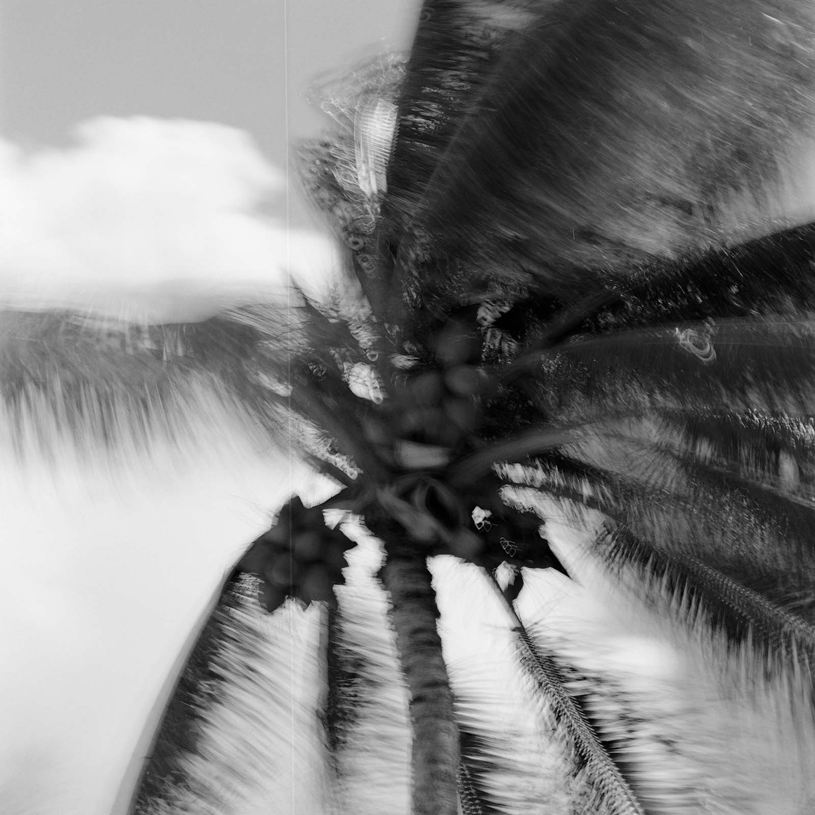

In August, I purchased a 10-roll "cube" of FP4+ in medium format. Every roll from that batch had exactly the same problem: a strange vertical line going across the entire length of a roll, shown as semi-transparent line on my scans without well-defined edges as shown below:
Upon examining the negatives, I quickly found the line on them, so it clearly was not a scanning problem. What was interesting is that it's not an emulsion defect. The line is clearly visible on the back side of the film, i.e. the side which usually is covered by the backing paper.
Closer examination with a high-powered loupe (can't share here because I can't take photos at this magnification) revealed that it's not a scratch, but a strange abnormality in the thickness of the film base. It is only visible at certain angles, I did my best to try to capture it on a cell phone here:
So I reached out to Ilford, and yes indeed - they had a manufacturing incident recently. Here's their response:
"I can confirm that the defect was unfortunately as I suspected - its a gel backing line. So huge apologies on behalf of our company - a sI apprecate its disappointing for you to have ruined images/films. Your signed number 4651 - links to carton batch 05CFN1C01-2/01-2"
They are exchanging the defective rolls.
Sharing here. Be aware.

What Ilford, strange enough, did not say is that one still may save the image.
possible means:
-) diffuse lighting
-) laquering the film
the most likely sucessful one
-) removing that backing layer chemically
I was thinking about using drum scanner fluid on the negative carrier when i saw the picture of your damaged film.
This fluid makes a lot of damages invisible. Maybe it depends on the refractive index and the shape of the unevenness.
Liquid scanning it will probably make it close to invisible.

@mshchem not quite, because a crease would affect both sides. This is more like a very slightly etched uniform groove. Extremely faint and hard to see at a straight angle, but quite apparent if the light bounces just right like on some sections in the photo.
Ilford provided more detail:
"... one of our newer QC staff who wrote down the position of a gel backing line (yours) to be rejected by finishing, but in error got its position out by 100mm. So finishing actually rejected what was in reality a good slit, and the slit with your line, went unseen..."
So they caught it during QC but sometimes humans make mistakes. Things happen. No biggie. And I applaud Ilford for same-day response and transparency. Will continue to shoot exclusively Ilford B&W films.

A check probably won't help. Based on Ilford's explanation, only one slit out of several slits was faulty in that batch. So if there were 10 slits coming out of the machine, for example, then a roll would have only a 1-in-10 chance of being bad. I suggest asking Ilford whether they will replace your brick. Or assume that naphtha in a glass carrier will conceal the flaw.

But this also shows that at the final product testing to catch such fault nonetheless at least a sample from each pancake would be necessary...
A completely automated system, detecting the position and lenght of such scratch should have got out the respective strip at converting.
