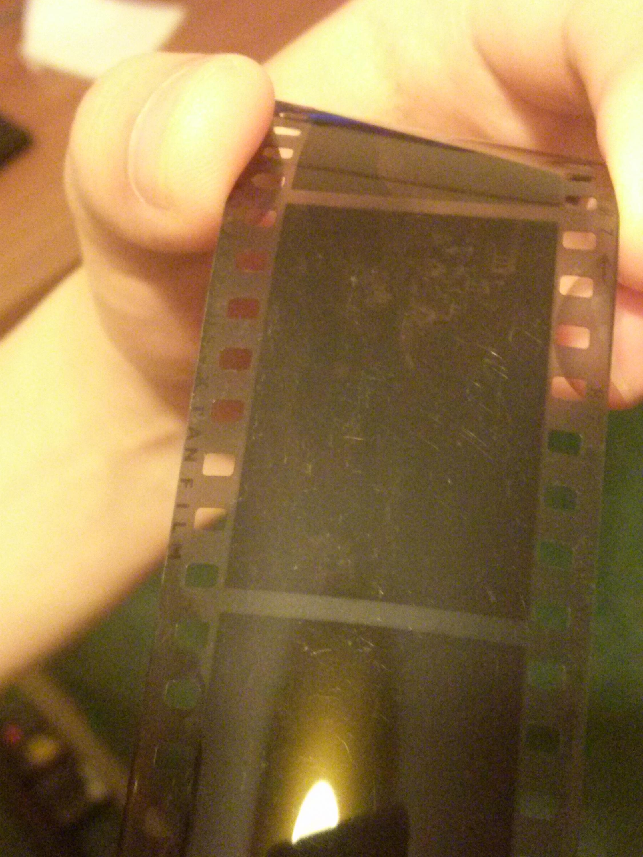

Regarding y-day-s events something also scratched my film. I guess both Zorki and cassette need some serious cleaning.
