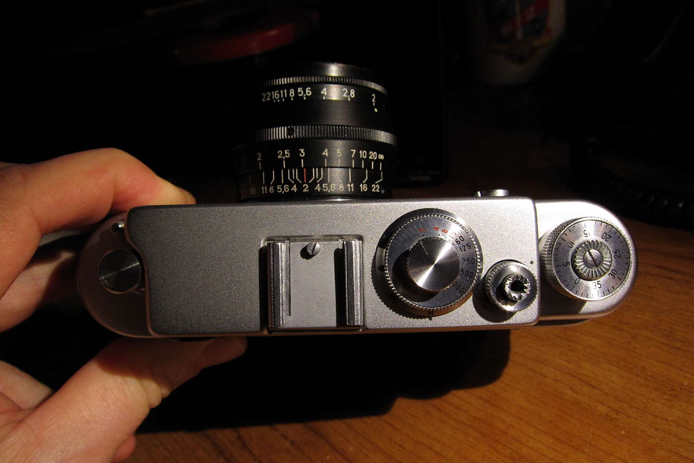

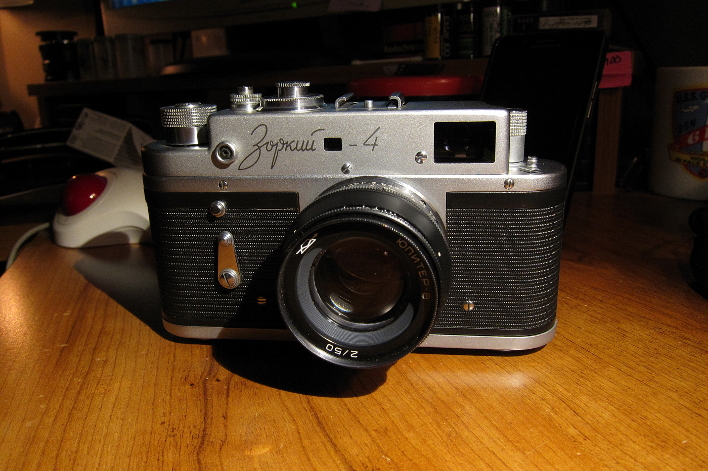

My Zorki-4 arrived today. Beautiful camera as I had hoped. Almost no wear even on the case so aesthetically speaking I am very pleased. However..... comma........ there are two issues that concern me. The shutter speed indicator line does not appear to line up correctly with the indicated shutter speed. I can find the correct shutter speeds by going to B which is kind of by itself and notching down, and the speeds seem right. The other issue is that on the 1/30th speed, which is the flash sync speed and located differently on the dial, the shutter curtain does not close when the flash sync selector is set to X. It seems to close ok when its set to M though. I'm trying to decide if this is a show stopper or not. I'm running a roll of film through it today and tomorrow to see how that turns out.
No wear often signifies a broken camera. Nothing to be happy about. What I'm picking up often looks like it collected a lot of mana through it's lifetime, and such cameras make me really happy.

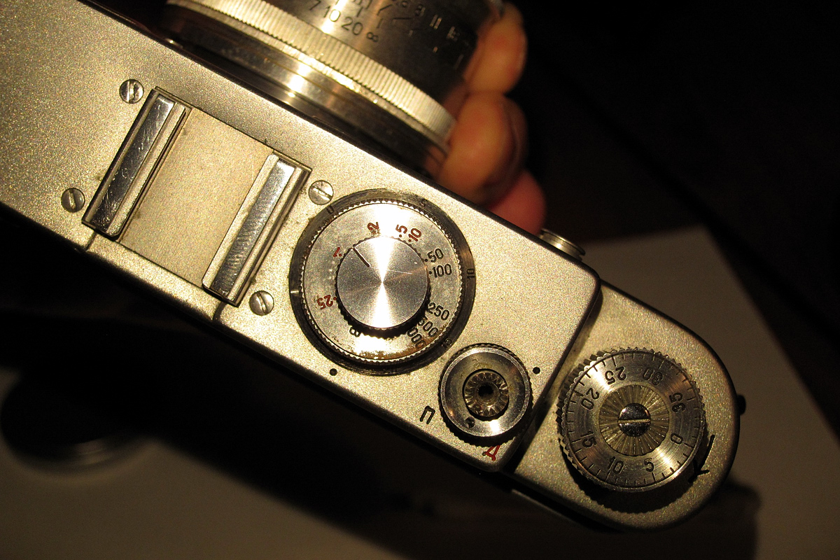

To correct positioning of the shutter speed dial you only need to unscrew two grub-screws located inside the knob itself. Cock the shutter, set a known time, take ~1mm diameter flathead ("glasses") screwdriver, undo 1 or 2 turns each screw, reposition the knob to match a given time, tighten the screws back and you're done. 1 minute fix, 99% doable without any heavy magick, 1% goes for stubborn screws. If that's the issue bothering you - thumbs up, it's trivial and easily reparable!
The other issue I'm not sure of. It may be of a similar origin to the first, that is there's something wrong with how the flash delay dial is "calibrated". I have delay in ms on my body, but I assume it's the same thing, as X and M.
In my Zorki 4 the grub-screw from this dial is missing, so I'm not messing around with this, and there ay be a good reason for this :D Anyway, if there's a position where it all works OK - for me, it works. I'd set it once and leave it like that forever.
This is how things go with soviet cameras in general. My Zorki 4 had a stiffened grease in the curtain rollers, so CLA was needed straightaway. In general, those are 40-50-60 years old cameras. The fact they haven't fallen apart really amazes me - foam from late 80-s is a sticky mess today, silver peels off the mirrors, there are no batteries of a given type... And with those cameras the only problem may be something like stiff focusing ring or badly assembled dials.
Fantastic. I loosened the set screws, re-positioned the knob, and tightened the set screws again and all is right on now.
I ran into the issue you discussed about the shutter button not coming up on it's own after a rewind. It took a bit of fiddling but then it popped up and has been doing well ever since. I did tear the film off the film cassette spool trying to rewind my first roll and had to unload the camera in the dark to get the film in my dev tank. I must remember not to wind the film too near the end of the roll as not being able to complete the winding action appears to keep tension on the shutter cocking dog and keeps it from disengaging the toothed in camera spool.

Well, if you feel adventurous, you may as well try to undo the grub-screw in the X-M sync dial, rotate the dial a bit and tighten the screw back to allow the sync dial to be set past the M setting. Just remeber how much have you moved it to revert the change if needed. But yes, something is not OK, and I'm not sure if this method will work. Sync and slow speed escapement are pretty nasty creatures on their own, and someone combined both right under the dials. Here Rick described how to check if the sync dial is set correctly: http://rick_oleson.tripod.com/zorkip2.gif - using PC socket, rather than lifting the top, it should not be that hard to do.

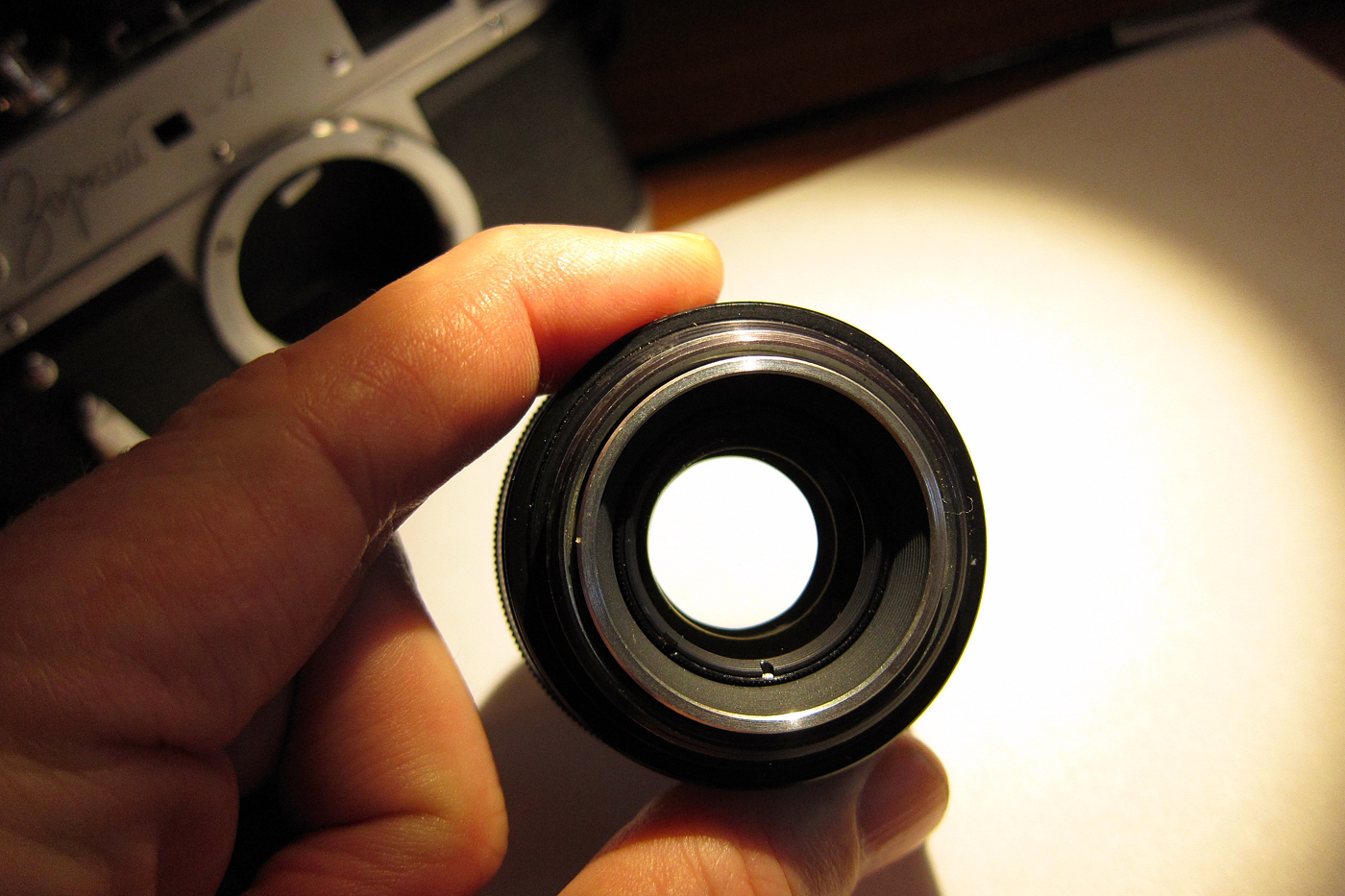

Take the lens off the camera and shine a flashlight through it. Move the light around, check from both sides, look for haze. It takes very little haze to lower the contrast of any lens, and the haze can be surprisingly hard to spot. A lenshood also helps, with any lens, haze or no haze

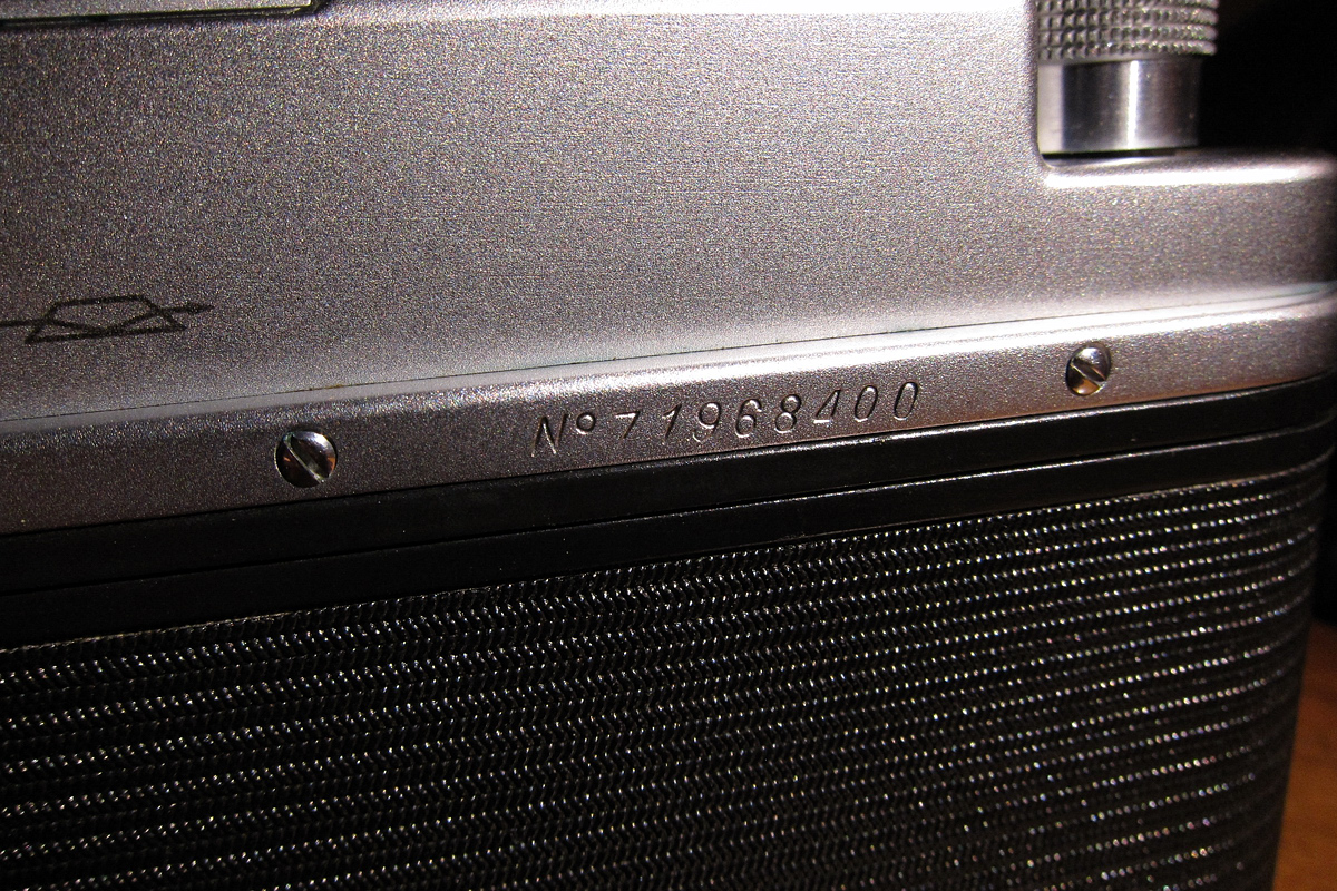

What year was your lens made? (First two digits of the serial, usually).

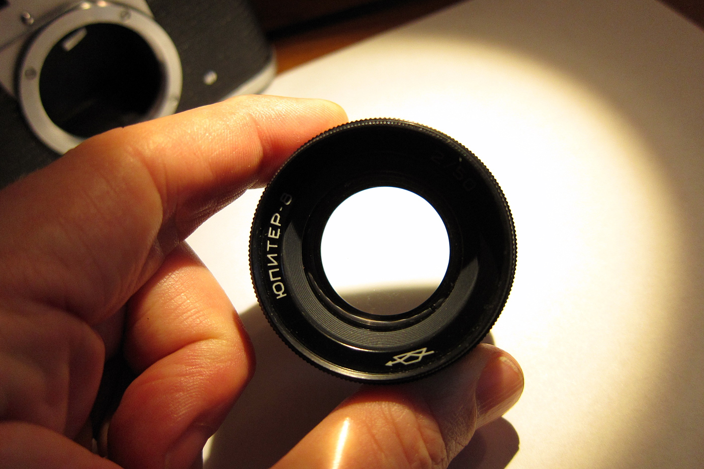

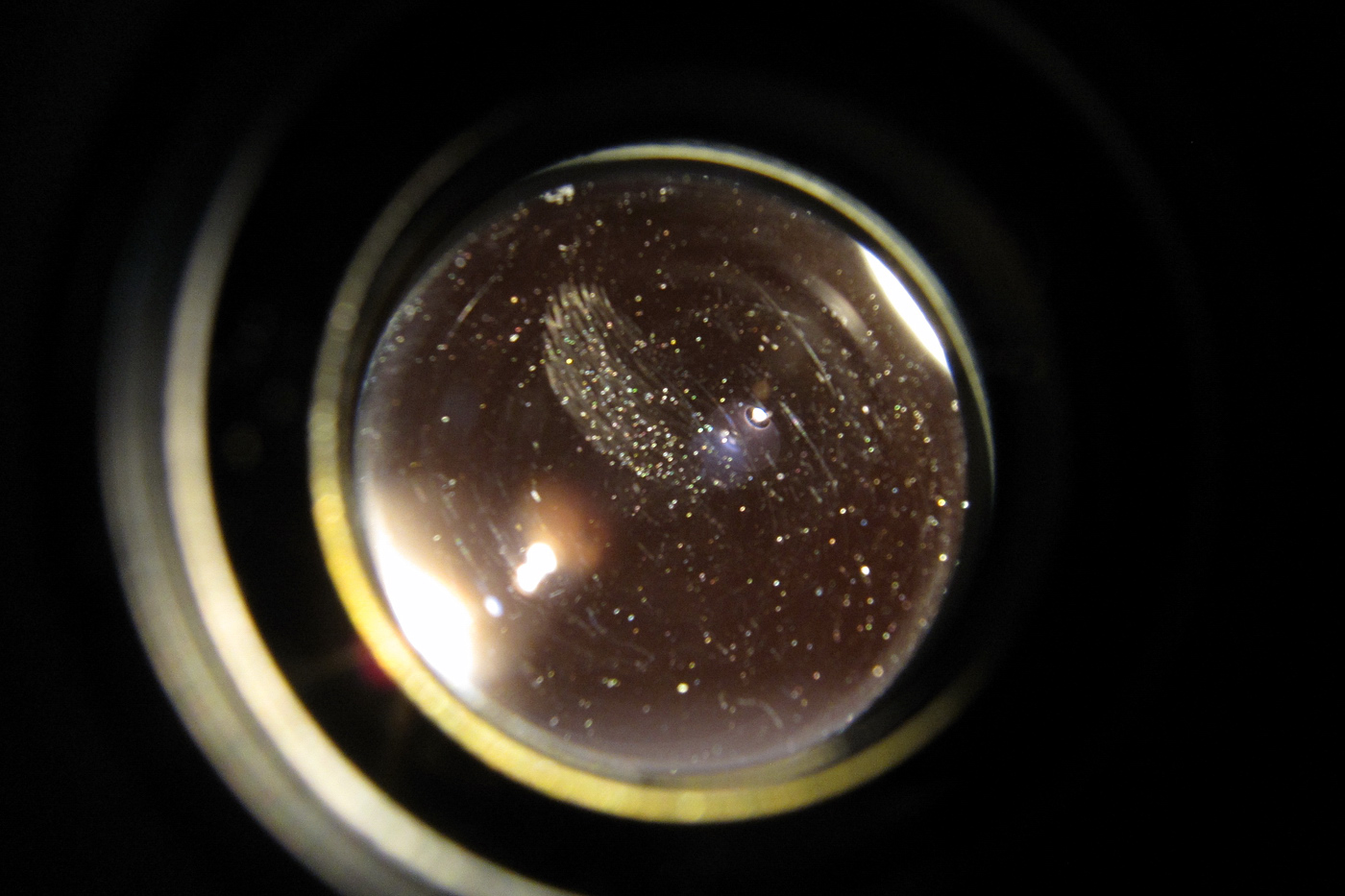

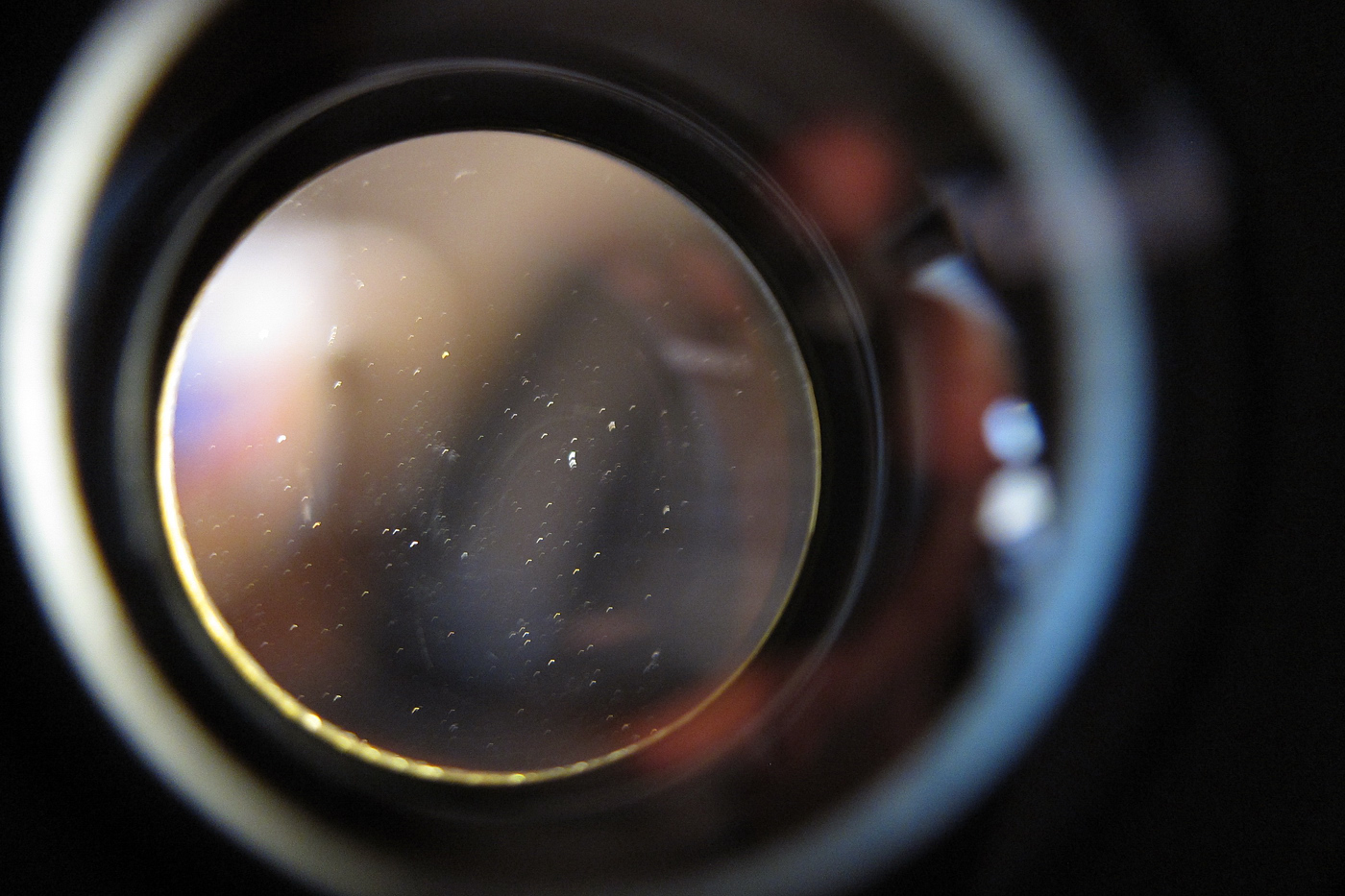

As suggested, pics of the lens with a light shining through. I see some specs and I added the fingerprint as I removed the lens. Is this enough to cause reduced contrast? I wouldn't think so but then I'm no optics expert either. I'm using pretty old XTOL so perhaps that could be the issue.
From the front:
From the rear:
A few of the body:
The one picture, #5 of 8, suggests that the lens is in need of cleaning. The fingerprint right in the center will certainly reduce contrast and resolution.
It doesn't matter whether you can get a photo of any haze, what matters is that you get rid of it. As i said, haze can be hard to spot - sometimes you need to really work at it, altering the angle of the light until it appears. It takes very little haze to reduce contrast, and the J-8 is a contrasty lens when clean; at least mine is - and so was it's uncoated ancestor, the 5cm/2 Zeiss Sonnar as long as you shaded the thing. If you disassemble the lens to clean it, beware!! I had to strip mine twice because the haze was not visible immediately after cleaning, all I can think of is hydration from the cleaning fluid made it less visible. When it dried out again, the haze was still there somewhat. Let it sit at least overnight before reassembling, the less you dis- and re- assemble these the better.
The serial of your J-8 is on the side of the focussing ring, from the looks of yours the number might begin '0' or '00' in which case it will not date the lens. For instance, mine is #7518177 made in 1975. The body was made in 1971, which means it's 42 years old and should be CLA'd if it hasn't already.
Yups, the dust may look ugly, but the fingerprint on a lens is a no-go. I doubt if invisible or very hardly visible haze would have the power to really reduce contrast much, and it would be worse or better depending on light direction. Here, it's not the case. Unlike the developer that lacked the time or the power to really rise and even out the curve, which could worsen the situation quite evenly...

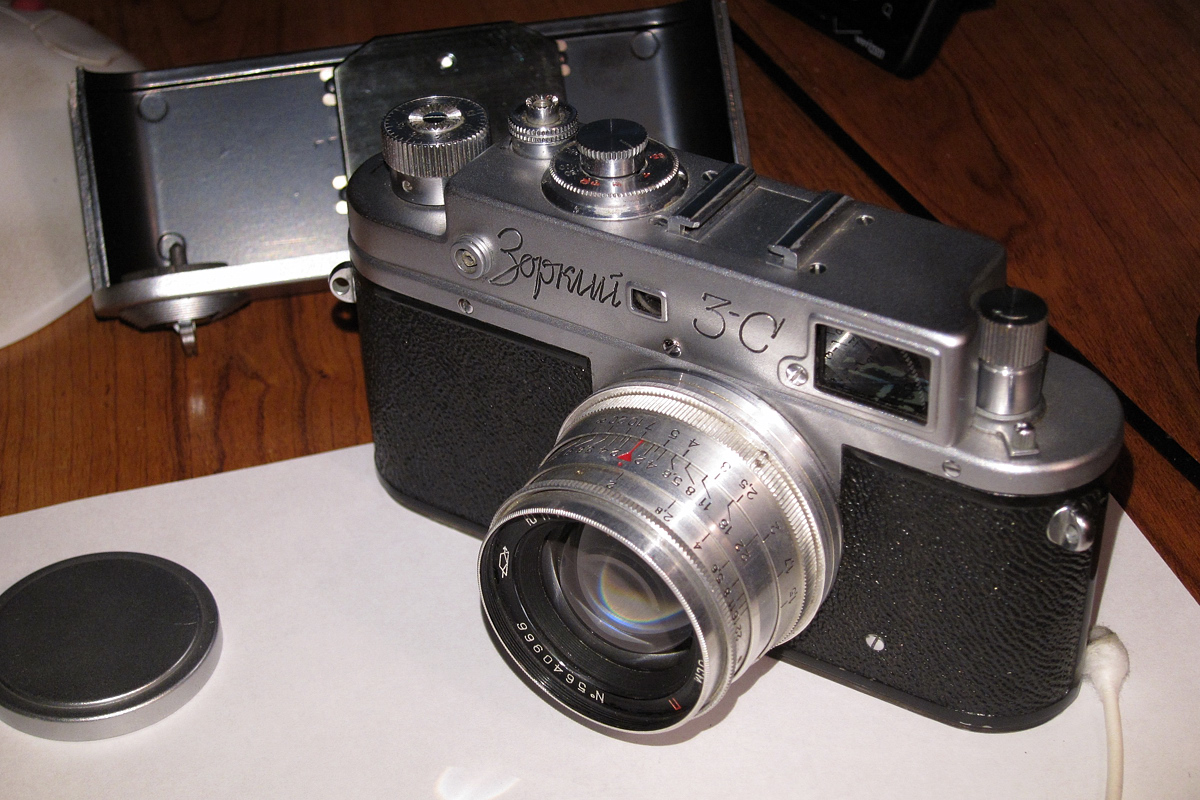

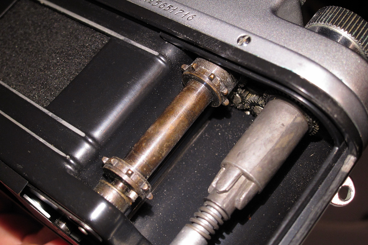

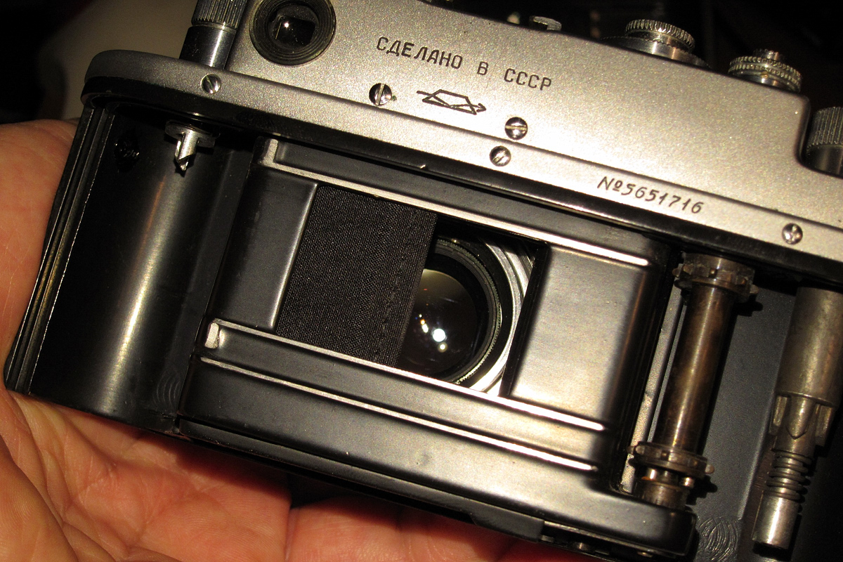

My second Zorki arrived today, a Zorki-3C from 1956 with an older, silver Jupiter-8. The camera is in very good shape aesthetically but it does have some slow speed shutter issues. With a shutter setting of 1 second the front curtain typically won't complete it's travel across the frame. The remaining slow speeds work but the front curtain was noticeably slow to begin but has improved a bit with use. It will still hang on occasion. Slow shutter times appear to be about 1 stop slower than indicated. On the B setting, in the beginning, the front curtain usually did not complete its travel and I would have to wind and shoot again. With use it is more likely to complete it's travel than not but it still hangs on occasion. 1/25th just appears slow. In the film compartment the toothed sprocket for the film does not rotate freely and has considerable drag when set to rewind, as if there was thick cold grease in it. I can return this item but I would rather try to repair it myself or have the seller reduce my cost and get it repaired. Thoughts?
Zorki-3C:
Showing front curtain hung:
Gears with dirt/gunk:

Well, if you forget machining marks visible on the inside, this camera has some excellence to it. "Old" times, beveled viewfinder and rangefinder windows (it's harder to stick a finger in it that way, believe or not), vulcanite, rather than leatherette, and you can wear it on a strap. Even the winding knob will hurt your fingers less (Barnack-like first models of FED and Zorki have silky film advance BTW). Pity there's no self-timer.
Despite dragging curtain, I'd "waste" a piece of film, load the camera and shoot 3-4 frames to check for leaking light and evaluate the lens. In case of the lens needing a service as well, I'd return it.
What you're describing is a typical state of a camera after nearly 60 years of occupying a place on a shelf, only being used every now and then, and that's what I'm usually afraid of buying. So yes, thickened grease is what it looks like, it'll need some C, L and maybe A afterwards.
As I've said earlier - either it's an opportunity, or a waste of time to service it on your own, depending of who you are (patience level), and how much time you have on your hands or how much will to get your hands dirty and learn to service stuff, rather than making photos. Those are fairly simple cameras to repair (there are simpler models though), but some basic experience is needed regardless. I'm not good in terms of service myself, I do only the stuff I know. In a similar case, I've taken out the shelf of the lower half of the camera, cleaned the couple of big wheels at the bottom of the camera and added some fresh lubricant everywhere I could reach with a thin screwdriver with a drop of machine oil at the tip (did I write you only need a Swiss Army Knife to service it?). From "sticking" it progressed to "slowing down in the cold", so I've repeated lubrication, and finally it's working in sub-freezing. Not an ethical practice, but I hope to be able to pay for a complete CLA of all my cameras in a couple of years, and DIY lousy service is all I can do now.
So, I think what you have is 90% a problem in curtain drum and rollers. All needs fresh oil. You don't need to disassemble the top of the camera to make it all work, I think, just the lower part. For a preview of what CLA looks, google for "Zorki 4 CLA" or download Meizenberg's book, where he writes: Zorki 3C - same as Zorki 4, but without a self-timer... The sprocket wheel, if it's stiff, will also need some grease to go inside it, as well, as whole set of wheels going from the film advance knob, you see it when you look from the bottom of the camera towards the top.
If you have any thin lubricant (just not dare to use vegetable oil, please) and a small brush to clean the wheels, simple cleaning and lubrication it's worth trying, I think. It'll take one to two hours doing it the first time, and you'll have the opportunity to really clean the camera, as it looks mighty dusty.
