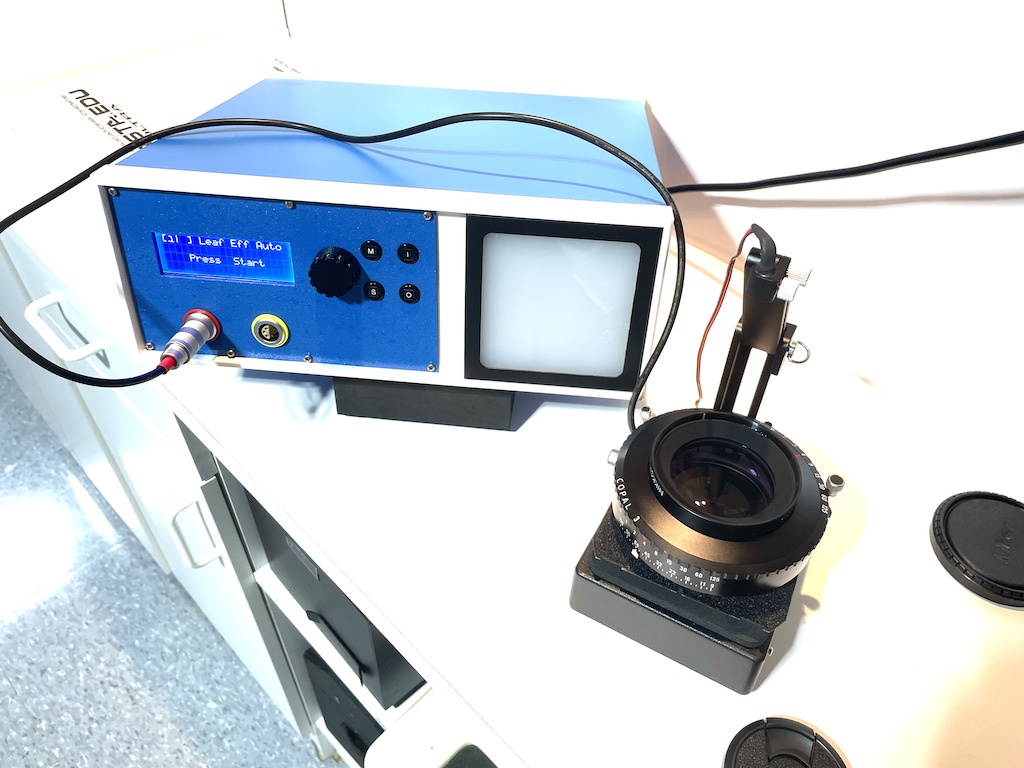

Recently received this nice 450mm Nikkor. Have not had a chance to try it yet.
First item is to check the shutter.
This shutter turned out to be fantastic. All speeds either 0EV deviation or +0.1EV except for the fastest speed. 1/125 was 1/110 at +0.2EV deviation.

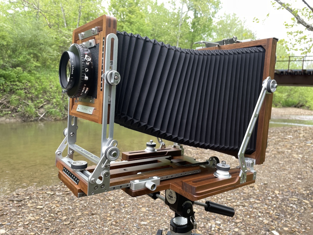

My first negatives were exposed on Arista 400 using a Shen-Hao.

Nice score! Impressed with the shutter speed test results. Please tell us about that shutter speed tester.

Its the only Nikkor M I don't have. But I can't justify buying one this late in life. I already have a 450 Fuji C. I just use the ole Calumet shutter tester. Only the highest speed with any of my own M's was significantly off. 1/6 of a stop at most variance at any other speeds. Great quality control.
Remember,
When testing a Leaf shutter, Copal and similar, you should stop it down about 1 stop. Always make several warm up shots at any particular speed as the pin inside that is linked to the outside indicator, sometimes does not settle on the true speed until it 'bounces' once or twice.

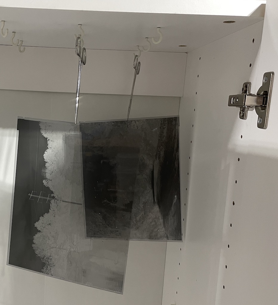

Examining the negatives on a light table. Very sharp lens!
