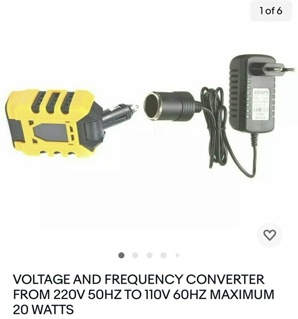

The gadgets that do what you need won’t run an enlarger but you could run a safelight… a 220 volt ac 50 hz to 12 volt dc… connected to a 12volt dc to 110 volt ac 60 hz converter
Like this. The cheapest ones could run the clockworks. But this one for example has max 20 watts which isn’t enough to run an enlarger. I use the GraLab timer to time developing, fixing and washing so I don’t use the sockets. You could also run the inverter off a car battery.

The 220 ac to 12vdc then inverter to 110 60 cycles should do the trick. I’ll try it since I have one of those for my car
