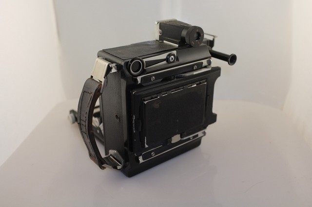

Yes! I got the holders and some film last night and a ground glass that takes the holders came in last week. I have a Graflok 6x9 (NOT FILM BACK) roll holder. However you're saying that all RB67 backs will fit on the camera? So I can get a rotating back for 6x4.5 theoretically and mount it to the back of the Graphic?
I really would very much like to calibrate the rangefinder but after reading up on it it's beyond my abilities. It's a shame because running and gunning would be a joy. Also, that's a real nice hand strap.
Yes, .. if , .. you have a Graftlok back, as shown in picture.
Have no idea.
Please understand the RB67 backs will not rotate. The rotate mechanism is part of the camera itself and cannot be disconnected from the camera.
NO.
The RB 67 has a body, revolving adaper, roll film holder, Polaroid holder. The Revolving Adapter will not fit any other camera.

Mmmm, careful. I recall I got a camera just like yours from a member here. It included a 135mm lens On a board meant for a 4x5 Graflex press camera. It would not focus correctly, bellows too short- which did not matter much to me because I was going to use the 101mm Ektar from my Baby Speed. Your Century has very limited bellows extension.
BTW, I think you have the side mounted Kalart rangefinder? I found it not difficult to calibrate mine, instructions on the Graflex.org site.
Yes I have the Kalart. I can give it a go but I'm not too confident.
As for the 135. I shot and developed a roll with it. So far it looks like I got the subjects in focus. I've not scanned the negatives yet to see though. I'm still not 100% sure how to work the camera. I pull the lens and bellows out until I can focus from infinity and work from there. I need to find an educational source that goes to step one on operating a view camera.
Wot? The longest focal length lens of normal construction (not telephoto) that works on a Century is around 200 mm. I just tried a 180 on mine. It focused to around six feet. The longest focal length original issue lens for the camera is the 10"/5.6 TeleOptar/TeleRaptar.
I don't know why you couldn't use a 135 on your "camera just like yours" but the problem has to have been operator error.
He mentioned using a 4x5 board. I'm not sure how it fit but that might be an issue.
