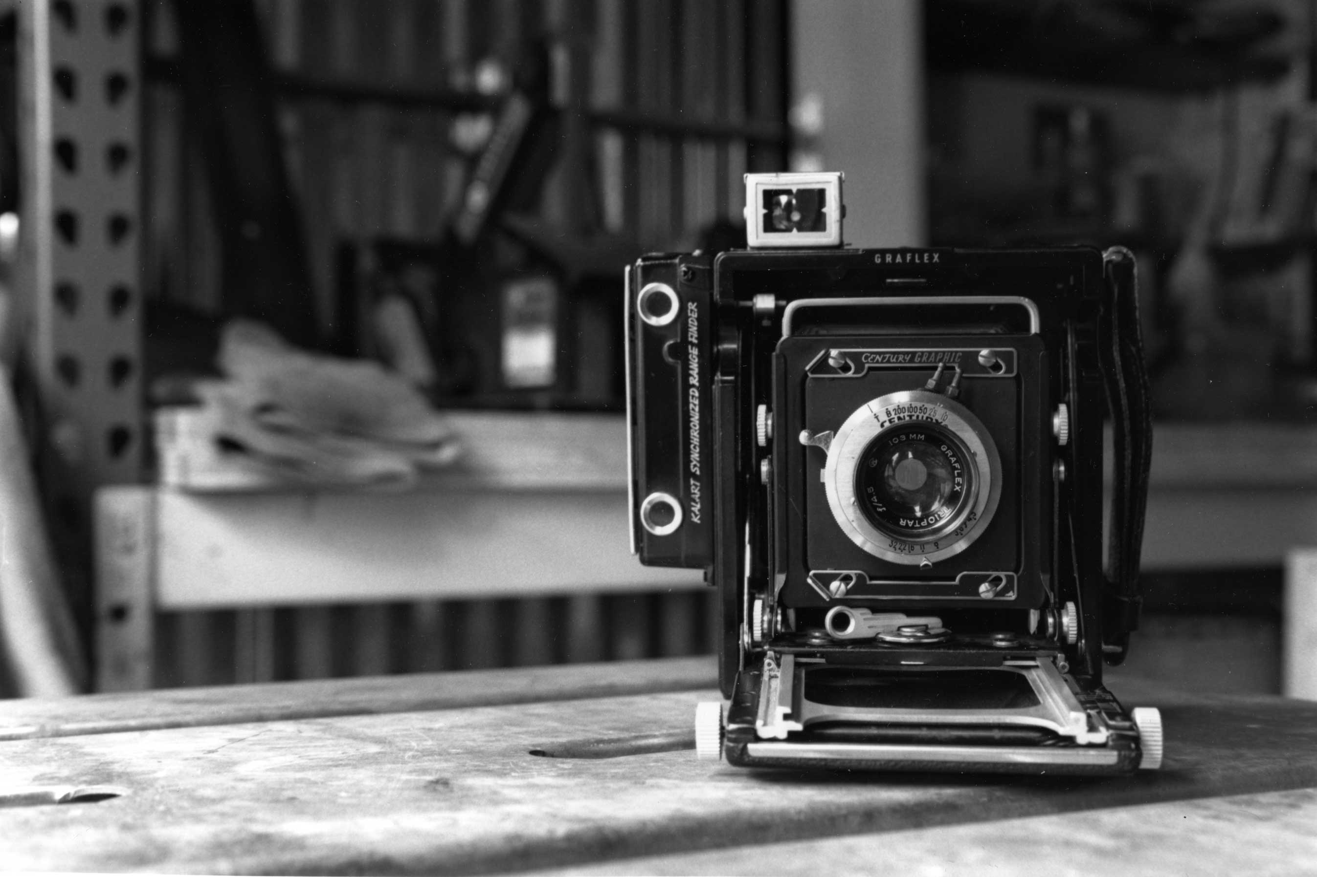

Hi,
I picked up a Century Graphic with a 120 back (and a mint Retina 11c) for a song. I don't know anything about view cameras or press cameras from a practical standpoint. Can someone point me to some resources or how to use these things? I need to calibrate the rangefinder.
The camera did not come with a ground glass of any sort. I'd like one, where would I look for one and what would I be looking for exactly? I'd also like to shoot sheets if I can find holders and a back.
I'm very excited to use this camera, I just need a few parts.

For the time being, you and your Century Graphic are toast. The camera can be used as is with the roll holder if and only the camera has a rangefinder and the RF is calibrated for the lens on the camera. The ground glass needed for focusing is in what's called a focusing panel. Your camera's focusing panel has been separated from the camera and, as far as you're concerned, lost. You can't easily check the RF's accuracy without a focusing panel. A strip of scotch tape across the gate is a sleazy expedient that will almost do.
With respect to a focusing panel, you're in trouble. They're hard to find. Any 2x3 Pacemaker Graphic (Crown, Speed, Century) focusing panel will fit. They sometimes show up on eBay.
The focusing panel also holds sheet film holders in place. After you have one you'll be able to use standard 2x3 sheet film holders.

We all gotta start somewhere. I already taped some wax (parchment paper) across the back to get an image.
Here's what I found on Ebay,
https://www.ebay.com/itm/Miniature-...&brand=Graflex&_trksid=p2047675.c101196.m2219
https://www.ebay.com/itm/Misc-2x3-C...rand=Unbranded&_trksid=p2047675.c101195.m1851
https://www.ebay.com/itm/Graflex-Mi...640797?hash=item56e07f845d:g:kPIAAOSwygFeXG9r
4
https://www.ebay.com/itm/Graflex-Sp...rentrq:31fafa081740ad4a6ba358adffff9c84|iid:1
Out of these selections are there any 'go for it!' or straight out stinkers?

OP, re your four candidates, no, no, no and no. None will do what you need. Sorry.
As Charles and I said, focusing panels for 2x3 Graphics with Graflok backs are uncommon.
So Dan, will any of these allow me to focus and swap in the 120 roll holder? Or to calibrate the rangefinder? If I can't shoot sheets so be it, I'll stick with 6x9 and won't cry too much.
#4 will. So will the Mercury devices mentioned above. I have no idea how much they cost.
This https://www.ebay.com/itm/2X3-Graflo...-Adapter-for-Early-Speed-Graphic/392915057798 contains what you need.
This https://www.ebay.com/itm/Graflex-2-x-3-Spring-Back-Focusing-Hood-w-Special-Ground-Glass/224118612865 is a better deal.
This https://www.ebay.com/itm/2x3-Monorail-View-Camera/392920859652 isn't what you want but it looks very much like a Galvin. 2x3 Galvins have bail backs that open wide enough to accept roll holders like the one you have. No lens board but I believe they can be improvised. Perhaps the grandson would be happier with a real view camera. And then you, having been stuck on a Century Graphic deal, can pass the stick on. Or be honest and explain to potential buyers that it is incomplete.
If you keep the Century, by all means check the bellows. In my experience replacing a bellows is very difficult. Anyway, what should give you hope is that your vintage of Graphic has bellows made of a synthetic material that lasts very well. Very well indeed.

Link #2 you provided looks like what I need. To be clear, I'd focus with this and the swap to the roll holder. Or focus and then slide in a film holder.
I like the look and compact feel of the Century Graphic. It's portable and I think a good place to start for me. If the bellows proves tight I think I'll invest in this system. I have a few hundred feet of 120 that needs to get used.
Yes, that's what you do. Open the hood, open the shutter, open the lens, focus and compose, close and cock the shutter, set shutter speed, stop the lens down to shooting aperture, remove the focusing panel (fold the hood carefully) and put it in your pocket, attach the roll holder, pull the dark slide out (far enough to expose the gate, don't remove it completely) and then shoot. Reinsert dark slide, wind the film on, ... Works best from tripod, becomes second nature with practice.

I'm going to do a bellows test when it gets dark enough. This camera does have a funny lens though 101mm Graflex Graflar 4.5 that goes from bulb to 1/300. Below 1/4 it's not very snappy.
I b'lieve that the 101/4.5 Graflar is a triplet made by Rodenstock. Budget lens, apparently not the best but I've never had one so don't know this at first hand. I've tried out all of the other standard issue lenses but the 101/4.5 Optar. I have one but have never used it.

It was reasonable---I don't remember the total. $55 plus shipping. He got it to me quick. I recall checking eSlay for the focus panel and they were pricier than what he was offering.
Using it is easy...Open the aperture all the way and use the T setting so the image shows on the inserted Mercury back. Focus (you may want to use a dark cloth/black t-shirt over your head). I check focus with a loupe because I have a 4x5 so I have one. Close the shutter, check my light meter for aperture and shutter speed and set both of those. I always use a cable release just because (and usually use a tripod). Swap out the Mercury back for the roll back and cock the shutter. Remove dark slide and when it's right, press the cable release to fire the shutter. Return dark slide, advance film, remove roll film back, and replace with Mercury back.
These steps are all based on memory but you should get the gist of it. I have a Kalart that's calibrated for the lens but I don't think I've ever used it. I planned to but I tried it this other way and I really enjoy it. I can see why someone would use it as a range finder because it's not heavy, though a bit awkward for me, but that's me and everyone is different.
I don't know how well the paper thing you have will work for focus because you have to account for the depth of the material between where the film is and the body of the camera. The Mercury back does that so you know if the image is in focus there, it will be/should be in focus on the film.

Just ordered a back that Dan suggested. It's $20 more than the Mercury but it'll allow me to shoot sheets if I ever want to. The bellows are light tight as far as I can tell as I checked. This setup, if I use it for 35mm panorama is going to be far cheaper than getting an Xpan. I love kludging my film equipment, I'm looking forward to getting this thing running.
