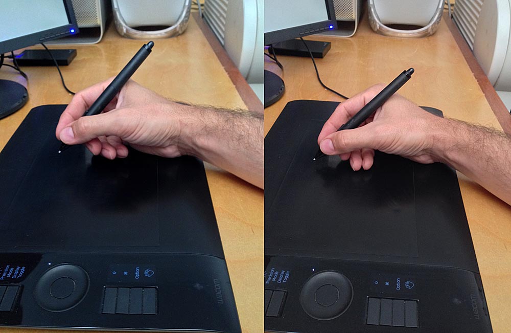

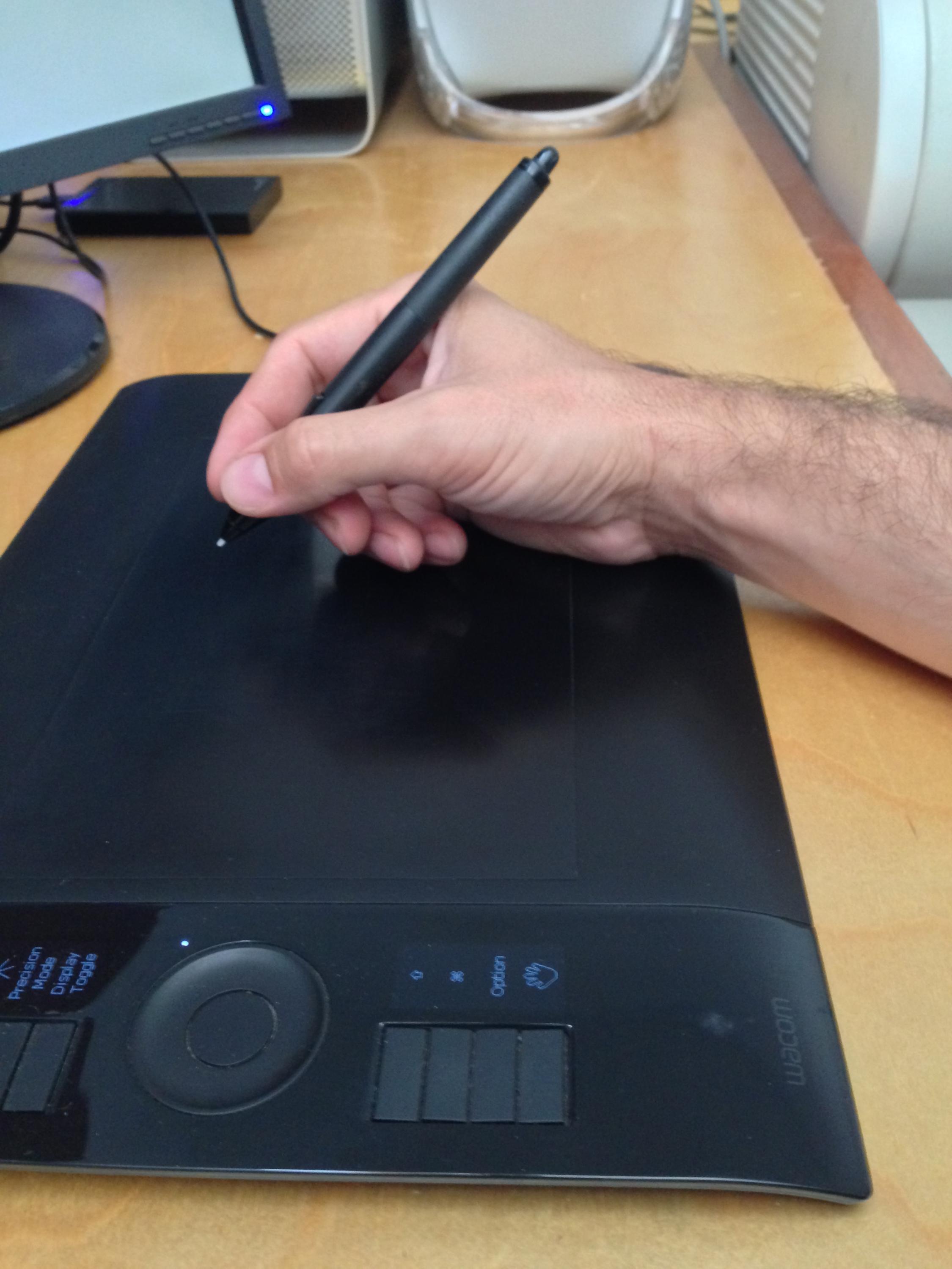

In regards to the learning curve and getting used to working with a pen tablet: The first time I one back in 2007 I did find it hard to use for the first two hours. I pushed through it while spotting a couple of scans and was surprised how quick I got the hang of it.
I have watched a few different people try to use a pen tablet during one-on-one teaching sessions and I regularly had to point out to not be afraid to plant their arm and fatty part of their palm on the table and surface of the tablet. The motion comes from moving the stylus with fingers/wrist and not your entire hand/arm. That gives you a solid point of contact and reference for where you are moving the curser on the screen.
Here is a quick shot to illustrate what I mean.
Since you are looking at a the monitor and not looking at the stylus/tablet (like you would be when you are sketching with a pencil and paper) you need to be able to sense of how much motion translates to the movement on the screen. It really isn't that hard to develop the muscle memory for it and the long-term benefits greatly outweigh the short-term awkwardness.

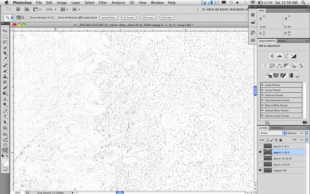

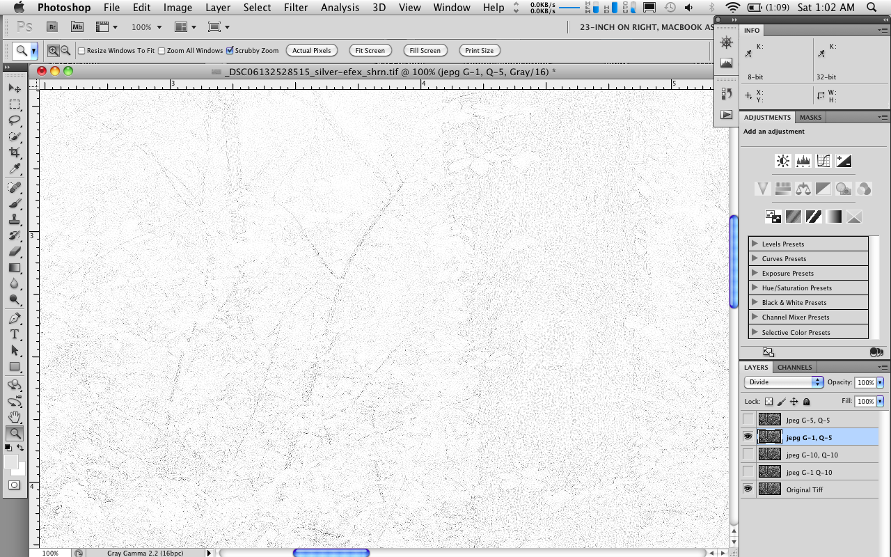

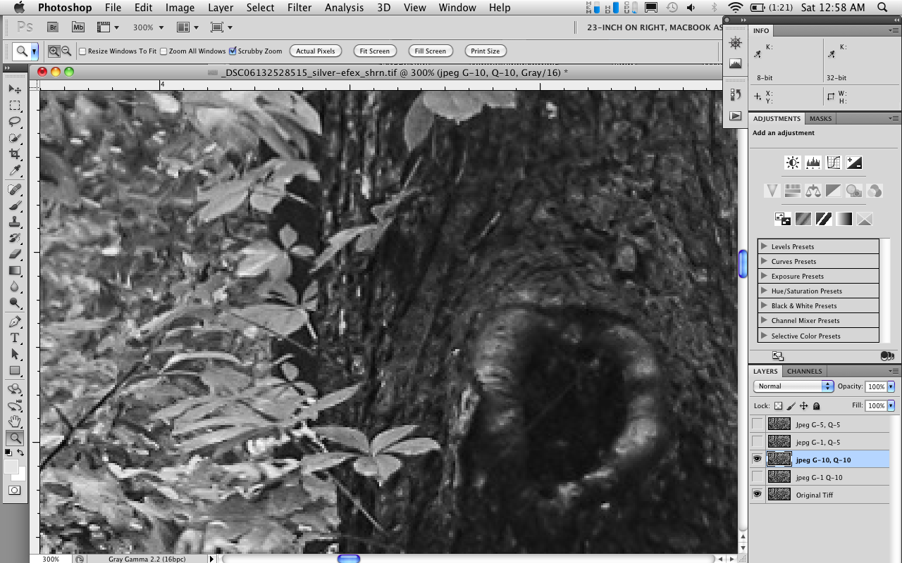

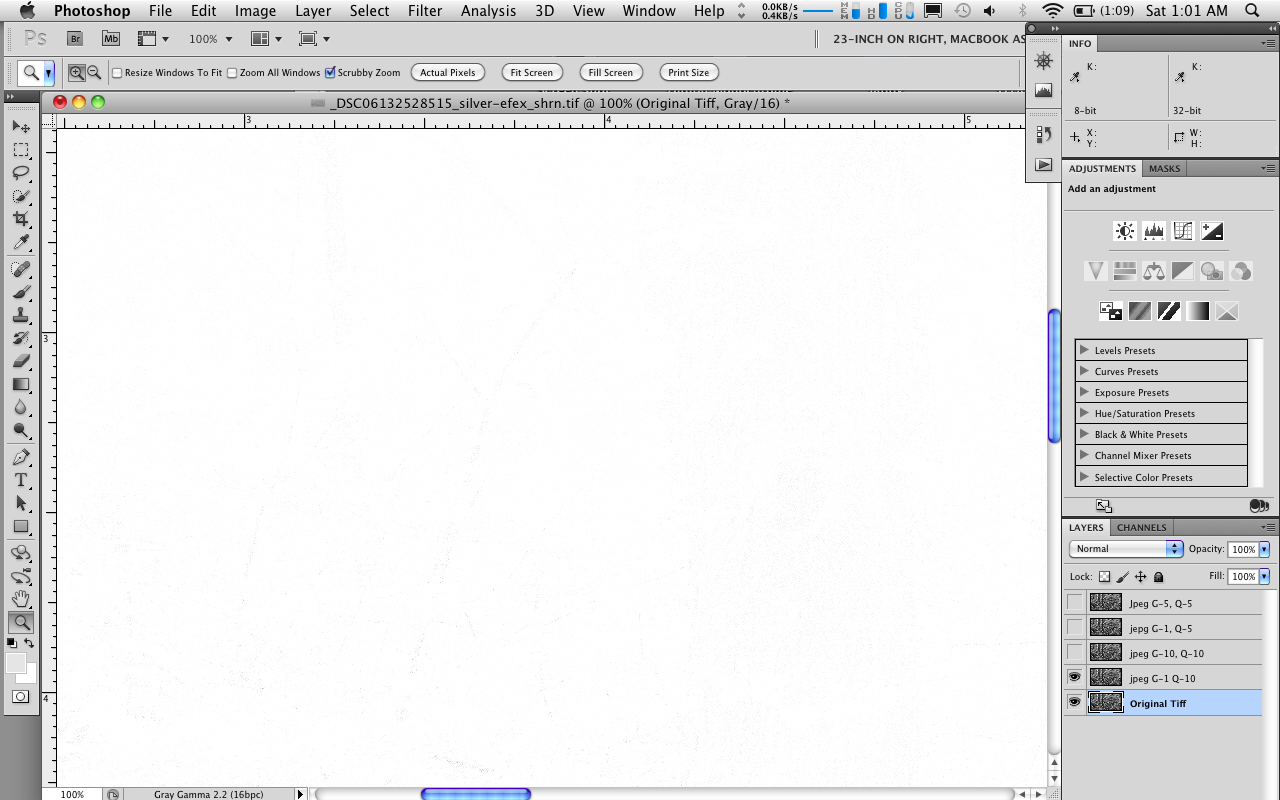

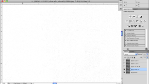

I had to try this;opened and just saved the same file as a jpg 18x over againin 'high' quality;there is no visible difference between the first and last file:wondering::cool2:.that's good enough for me;save often losing your work is worse.
Losing your work to generational loss is just as bad.

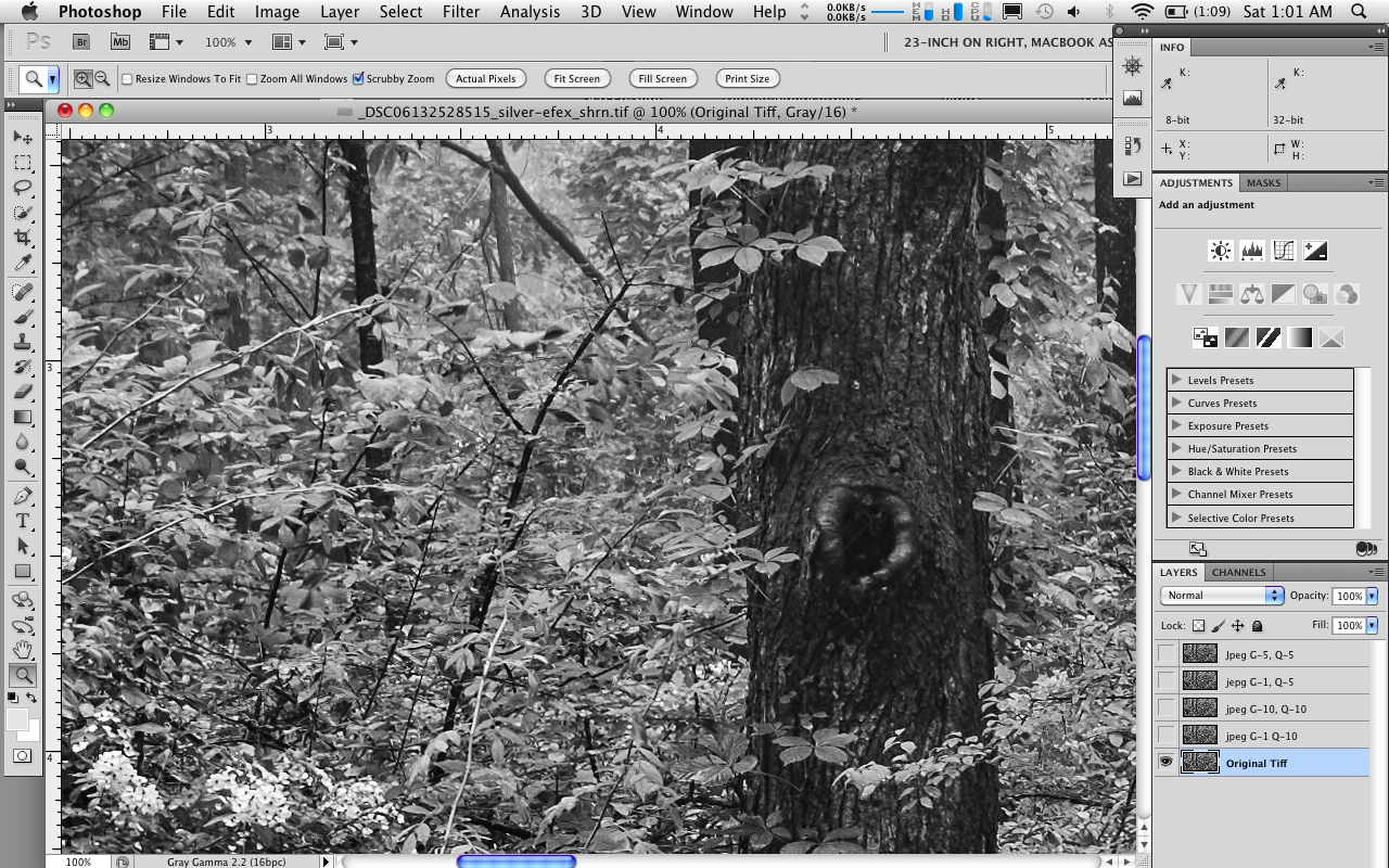

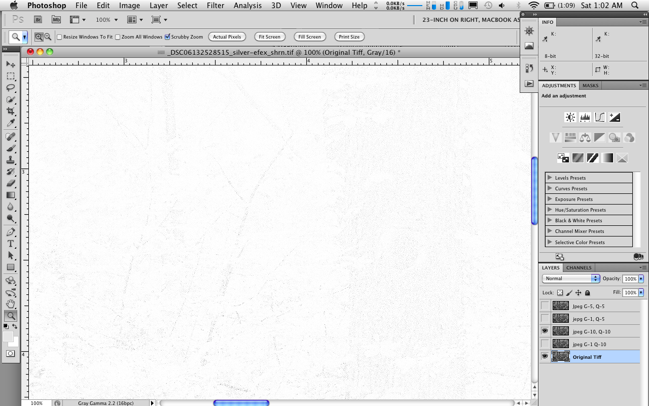

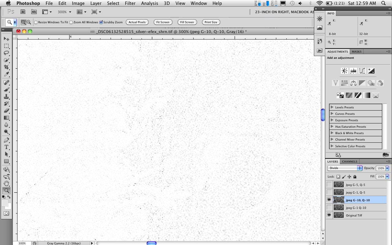

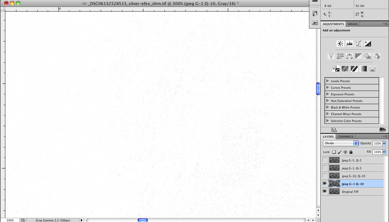

I did the same thing as your little experiment: I opened a 16-bit tiff and saved it as a jpeg with a quality 10 (first, photoshop converts it to 8-bits. So there goes 65,280 possible tones). Then I opened and re-saved the file 10 times with the quality set to 10. I then did the same thing from the original tiff with the quality set to 5, this time I only re-saved it five times.
I then opened and stacked each jpeg as layers on top of the original tiff—the pixel dimensions didn't change so there were no registration issues.
By setting each layer to the Divide blend mode you can see the pixels that were actually altered (as black pixels) when compared to the underlaying original (represented as white pixels unaltered pixels). The Difference blend mode will do the same thing, but the changed pixels show as white, with the black pixels being unchanged—for this purpose the Divide blend mode made the changes more apparent in the screenshots.
Take a look at the following 10 screenshots (5 at 100% zoom and 5 at 300%) and you can see just how fast the image is changed, especially if the jpeg quality is set to anything other than the highest setting.
It might not look all that bad at a modest print size, but when the actual image pixels are rasterized by the print driver it can lead to a loss of contrast and sharpness. It actually might be fine for most people after just one or two re-saves, but think about how many times you might open, alter, and re-save an image over the course of a year, not to mention a working life.
