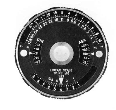

By the dial I mean This
All of the meters I mentioned can display the LV number so you make a dial just like that with the zone scale replacing the IRA scale. Now you can use any of the other meters take a measurement and get the readout in LV (EV @ ISO100) then you can set that value on the dial.

I do prefer the Minolta as I don't need any computation of the dial or even the Minolta digital processing power. What I do want is accurate LV readings. However, I found that more people like the Pentax and the reason is the dial. The Pentax is no more accurate than the Minolta (at least it has less resolution) but they are sold for more in the used market even though when new they are less expesive.
So since more people like the dial I am thinking of selling the dial by itself.

That's the whole idea of a narrow-reading spot meter. You're comparing specific points. What you do with that information is another thing. Some people apply it to various Zone models; some do not. The IRE scale has its own set of usage, which might or might not match one's own practical model. For those of us who do both color and black white photography, the placement of the readings themselves necessarily differs case by case. No one shoe size fits all, even when using the very same meter for everything.
But yes, after learning various ZS models, I landed up with a more direct visualize the specific curve in my head approach instead. That takes some experience, film by film; but in the long run it's a lot simpler, intuitively.
Pentax vs Minolta? Having used both, I doubt the Minolta Spotmeter F was actually any more accurate; it just gave more specific readouts. Frankly, both style meters read identically over their full range. As a stated earlier, I found the exterior manual dial of the Pentax quicker and more intuitive to work with.
I never personally saw any sense to those stick-on Zone labels; but it they do help other people, who am I to criticize?

I currently have a Pentax V Zone VI Modified meter that I use for calibrating film at home, and a Pentax Digital Zone VI Modified meter that I use when photographing using black and white film in the field. The former enables me to measure small areas to about the nearest 10th EV when I do my testing. For me, readings in 1/3rd stop increments works fine in the field, but not for the testing that I do at home.
Both of these meters were simultaneously calibrated by Richard Ritter to help assure their agreement with each other.
That said, any meter that gives me EV's is fine in the field. While I now have Pentax meters, I've used two different types of Minolta in the field.
I also have a Sekonic 508 with a 1 degree spot meter, that I could use in a pinch. But for me, they're cumbersome, because I'm unable to read EV's looking through the view finder. So evaluating a scene, there's a lot of inconvenient back and forth between using the viewfinder and having to look at the display.
