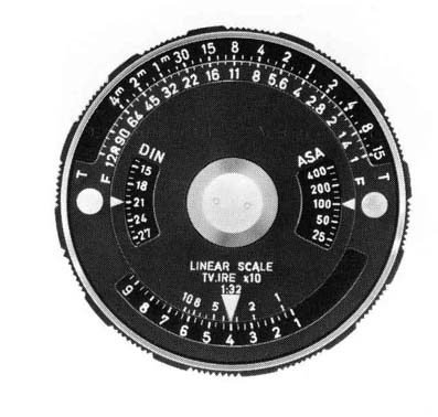

By the dial I mean This
All of the meters I mentioned can display the LV number so you make a dial just like that with the zone scale replacing the IRE scale. Now you can use any of the other meters take a measurement and get the readout in LV (EV @ ISO100) then you can set that value on the dial.
