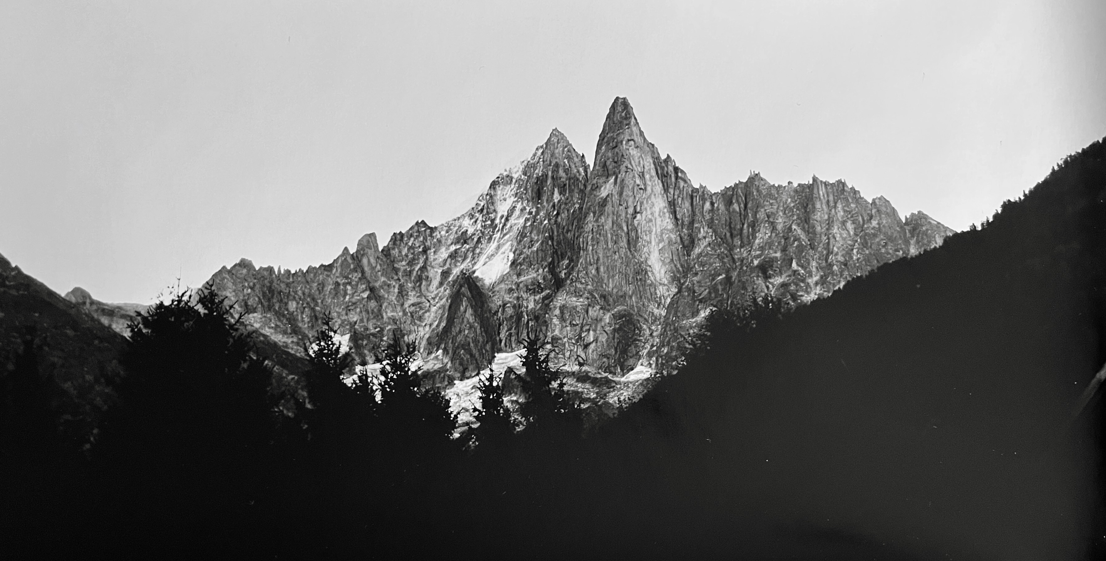

About incident meters, they might work depending on your subject, but they will be very limiting. Let me offer you an example. I am currently at the tail end of my spring traveling and yesterday I was photographing a sea arch on the northern coast of Ireland, standing on a cliff about 25 m above sea level, pointing my camera towards a dark basaltic arch surrounded by red sandstone, under an overcast sky with a thin layers of sort of shapeless clouds with the su in front of me sort of visible through the clouds (but not projecting any harsh light). The arch was under me and in a sort of "bowl" filled with crashing waves and white foam.
I pointed my Pentax towards the scene, scanned it to get a reading of the darkest and brightest areas, made my decision about exposure and development and I was good to go. I am pretty sure my shadows won't be blocked and my sky / foam won't be burned.
Given the structure of the location, it would have been extremely hard to use an incident meter to the same effect.
Of course, if you shoot tree barks in a forest where walking to the tree is easy, then an incident meter is perfect; or, if you shoot a scene at a distance where the light is simpler and more uniform than what I got yesterday, incident would do.
I have been doing this professionally for 15 years now, and one thing I learned is that with pretty much anything photographic you'll find people for whom this or that solution work fantastically well, no question about it. When it comes to meters, it's mostly down to the kind of subject matter and light you intend to work on, and depending on that it is possible an incident meter would work fine for you. But, an incident meter is inherently limited, whereas a spot meter will work perfectly for any subject and under any light.
One last point - when in doubt and when new to things, I always start by looking at the masters for reference, assuming they must have known a thing or two :smile: In this case, if you do, you'll find that all the masters of film era landscape pretty much used spot meters, even when they had incident meters available.
