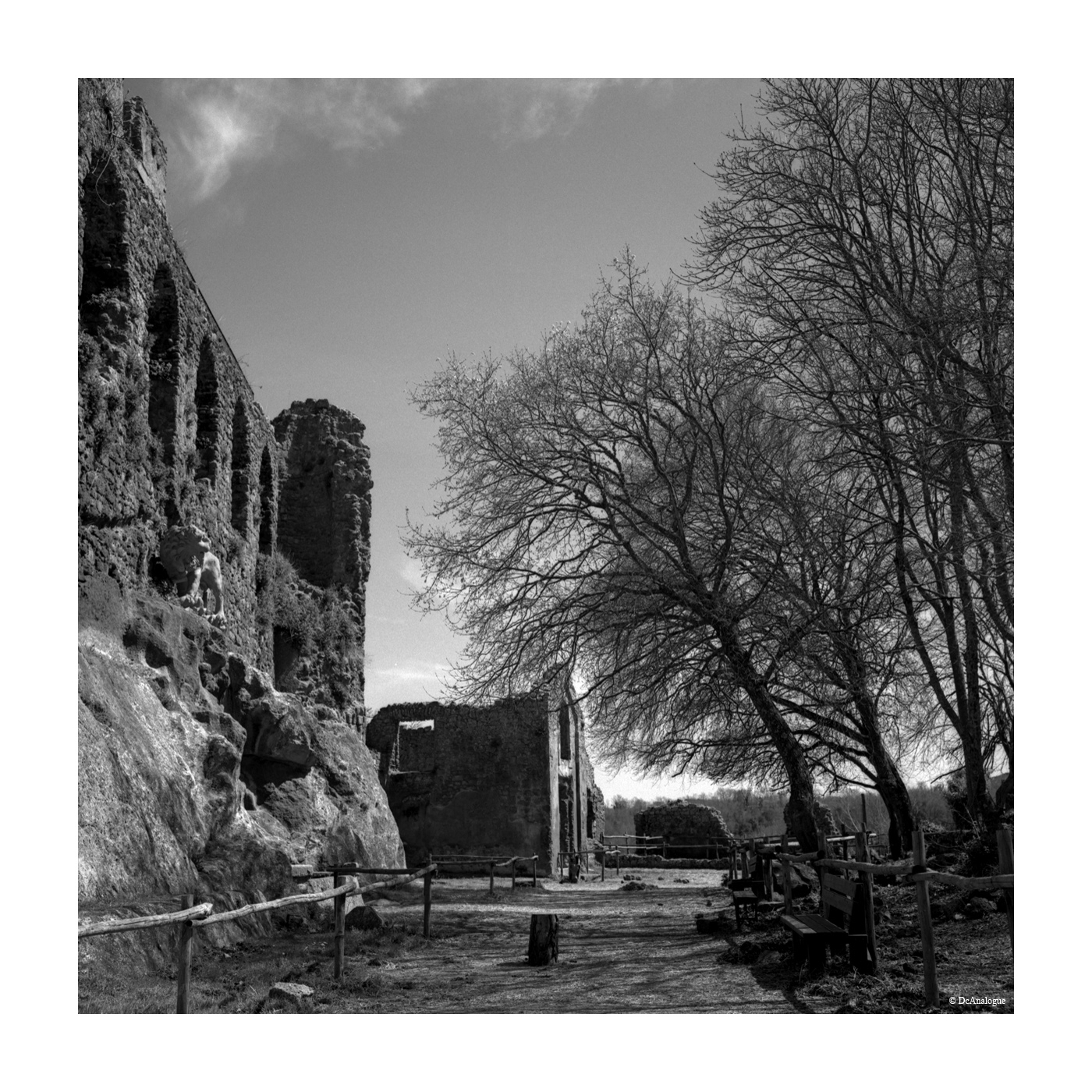

Hi film lovers!
Going on in my film experiences, I recently tested Ilford XP2 Super 400 souped in Adonal 1:25
I know it's a C-41 film, but some shot I saw on the web lead me to try this way.
Results (IMHO) were very good (at last @ scanning).... Sharp, great tones and easy to scan.:smile: I'm sure they will come out great in prints too....
