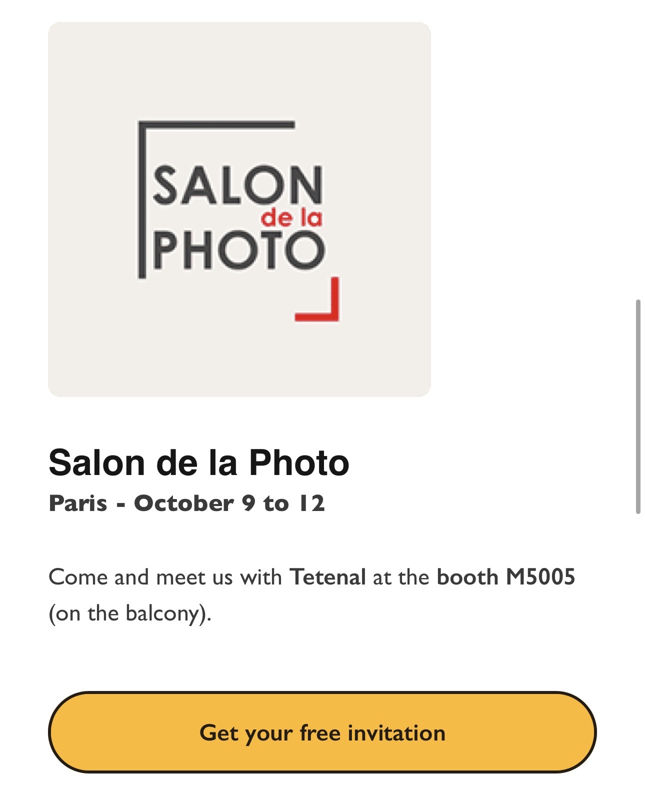

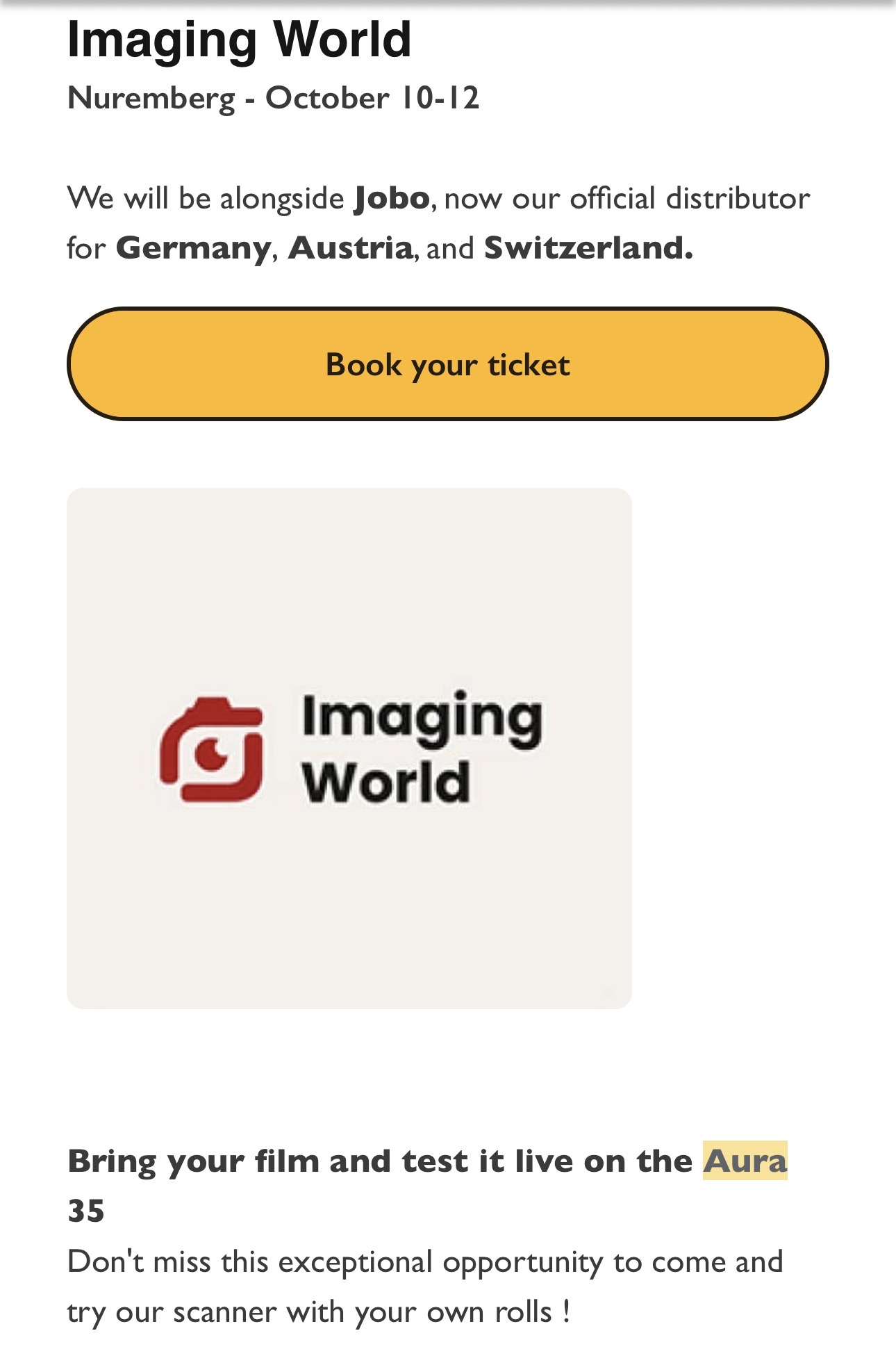

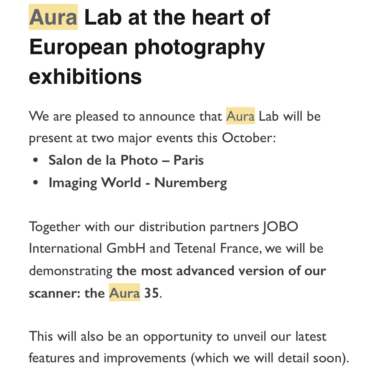

Encouraging signs of life for Aura! This was in my inbox from Sep 23. I must have signed up for a distro list some time ago.
What we learn
- they’re working with Tetanal in some capacity (French distributor?)
- Jobo will be their official distributor for Germany, Austria and Switzerland
They’ll announce more details on the features.
They welcome folks to bring their own film and test it at the trade convention booths.
Invitation request link for Paris, October 9-12
Imaging World in Nuremberg, October 10-12
If anyone is nearby and goes - please post back after the fact!!

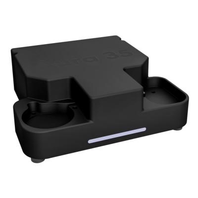

The Aura website has me worried this may not be price competitive to most competing alternatives (eg secondhand Noritsu or Fuji Frontier). Aura website describes lease to own, reference to cloud, potential for two models (one HDR, one not).

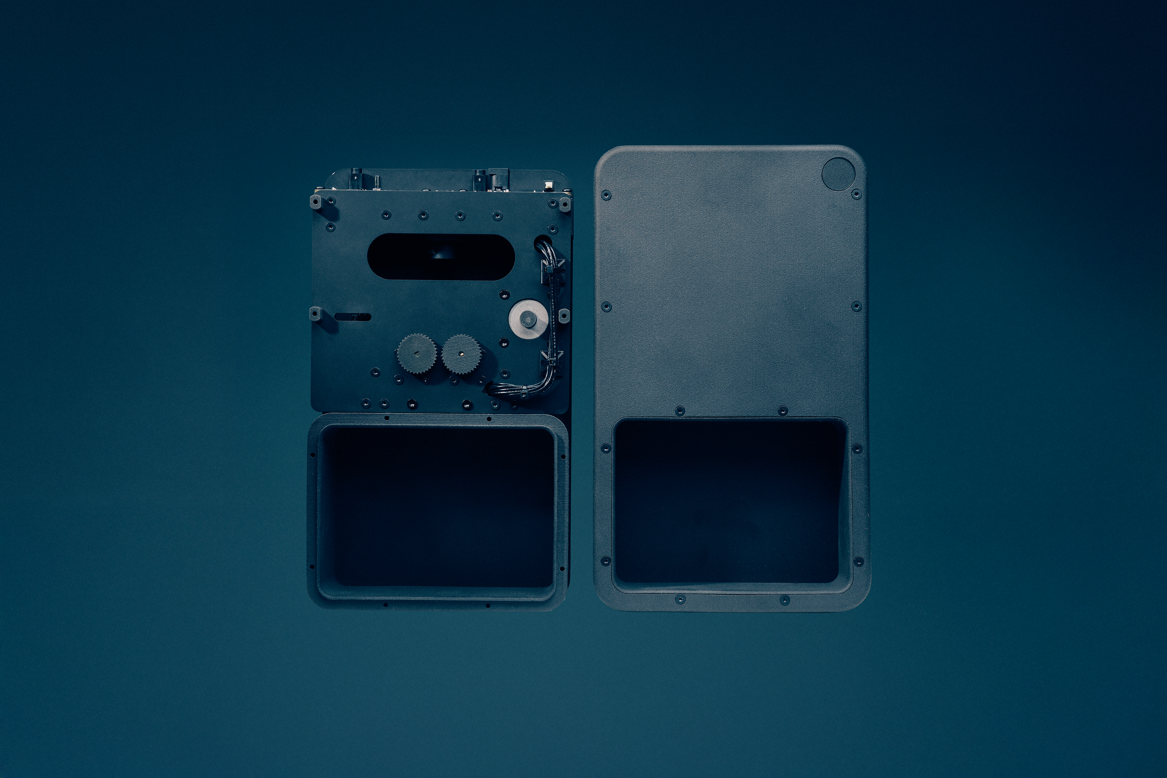

In other news, a Berlin based startup is doing a beta testing round for their Pakon like device, Knokke. They’ll do crowdfunding at 999EUR “soon” and launch at 1599EUR. This price point would be more compelling vs CoolScan.
