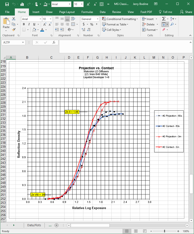

I, too, have gone to Liquidol with Classic and love it. Before I switch to any different paper or developer I always run some tests with 31-step wedge prints on 5x7 samples, both projection and contact prints to compare the contrast differences. I’ve recently completed these Liquidol/Classic tests and have learned quite a bit. One of my main concerns this time around was to ensure that my recent enlarger light source conversion to LEDs was performing well (with under-lens filters 00, 0, 1, 2, 3, 4, 5, None). It was. I’ve always been bothered by Dektol expiring quickly, both stock and working solution; Ilford MG developer was no different. I detest having to dump chemicals before I could get full use of them - so wasteful. Liquidol solved that. It’s really a tough developer, and I have long stories to confirm it. It was developed by our own “Photo Engineer” (PE) together with Bill Troop, using all their knowledge about long life developer chemistry; it’s marketed by Photographers Formulary and is available from Freestyle and others. The Formulary’s instructions suggest 60 seconds development (1+9, 68*F), but my tests showed that would only reach 1.9 density, so I did my tests at 3 minutes and it reached 2.1 density. I did notice how fast the wedge image began to appear in the developer, so if one is using Factorial Development be ready for that. When making REAL prints I plan to slip in a few wedge prints to find the minimum dev time needed to reach 2.1 density. I was ecstatic to see the bright white and deep black in the wedge prints and no sign of a tint (which is cured easily by selenium toning any image worth keeping). Now it’s off to make real prints.
BTW, here’s a screenshot of my dev time comparison of 60s to 3m. All curves have been shifted along the RLE scale to intersect at the same arbitrary point to make it easier to compare the slopes.
