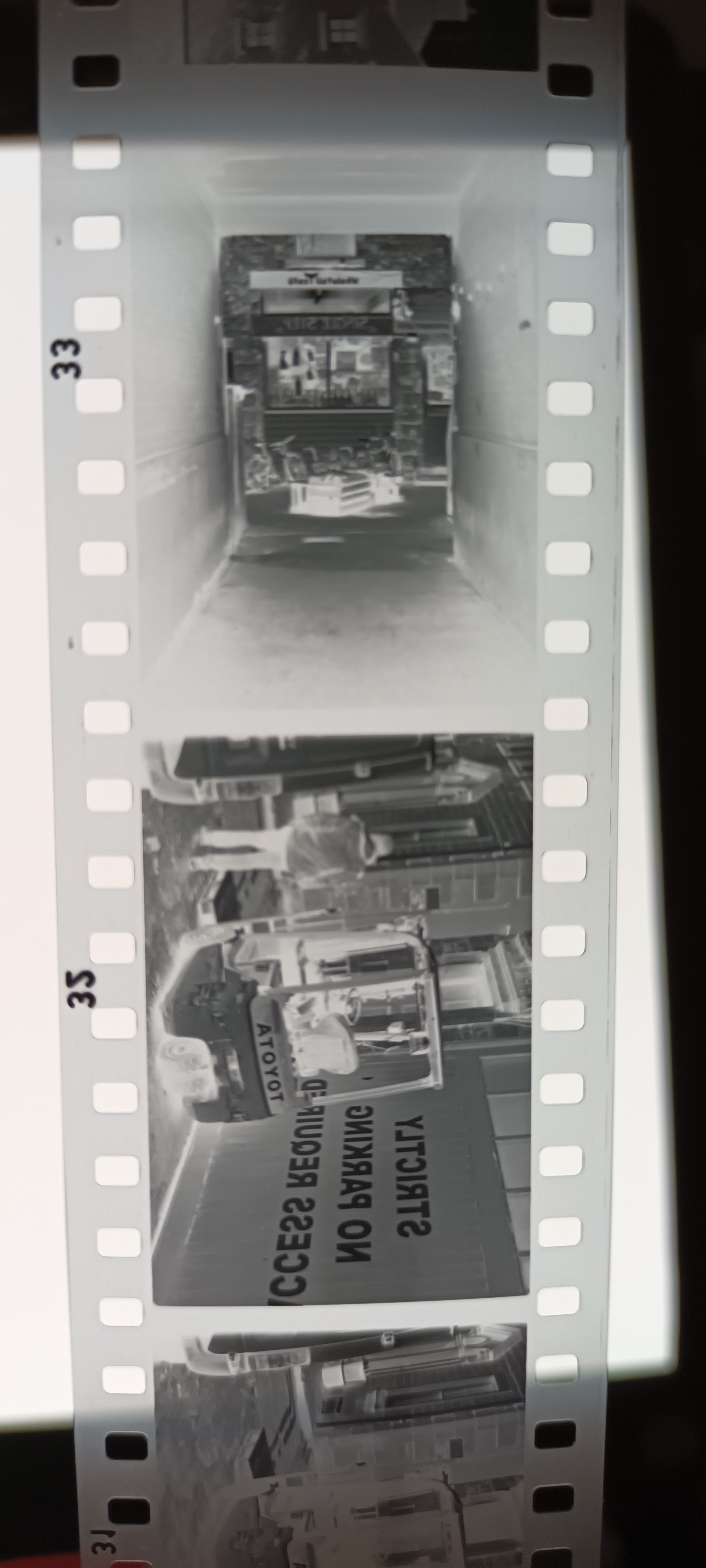

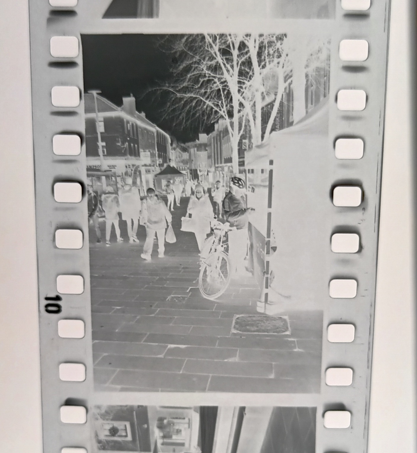

I am still persevering with the HC110 but I am yet to be impressed. I have added 10% to my development times and am using the agitation scheme recommended for Tmax (3-4 inversions every 30 seconds). The results are better but not a patch on ID-11. I think, once this bottle runs out I will try the ilford HC. I love ID-11 but lost a film to its shelf life so I am looking for good, long lasting, one shot liquid developers. Anyway, here are two separate negatives from two different cameras

Based on the edge printing - which is a not particularly reliable indicator - I would say those look more like under-exposure than under-development.
Are you perhaps not allowing enough for the small loss of speed that using HC-110 causes?

I was talking to a friend of mine and saying to him that we need to go out soon because I need a lesson in correct exposure. I always mean to err towards over, yet frequently under expose. I think that is something I need to address with my next roll. I am mostly self taught and am beginning to think my teacher is rubbish :smile: Thanks Matt. I have foma200 in the camera. I may continue with the added 10% developing time but first, sort out my exposure
