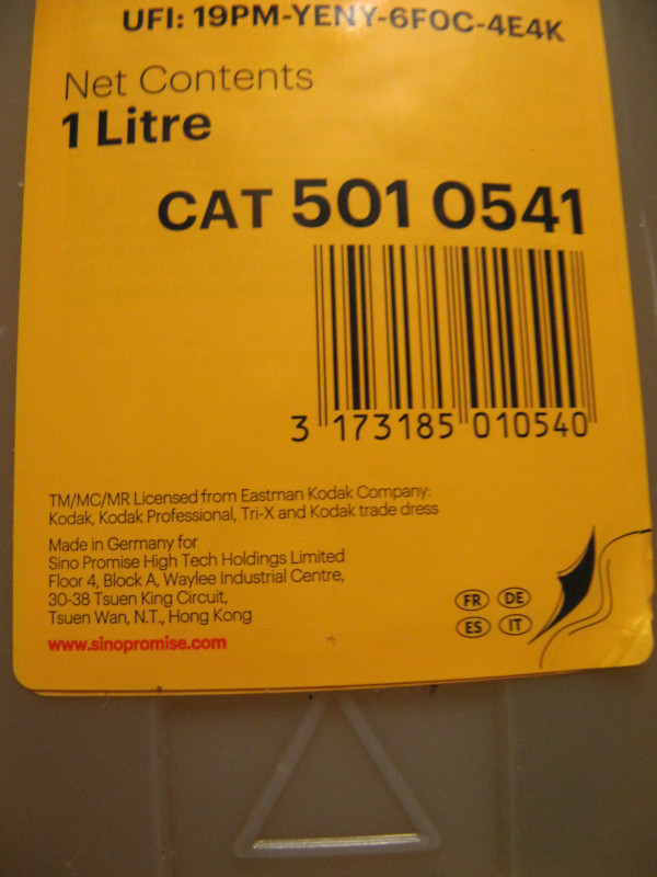

Where was your HC-110 made, and what is the best before date, and what is the catalogue number? That will tell us which "new" HC-110 you have.
Catalogue number 501 0541
Exp 2024-05
Made in Germany
Exp 2024-05
Made in Germany
This means it is the new, new stuff, not the "new" stuff that was produced briefly ~ 2019 in the USA.

for HC-110, probably Tetenal or Calbe, these are the two manufacturers or photochemicals in Germany, besides Adox recent own factory.
The new bottle HC-110 I bought, this sommer, has same catalogue number 501 0541 but is indeed a little but different, slighly clearer and more fluid. I use same dev times than before, felt no noticeable difference.
btw, Kodak Alaris has no business in this. The company is SinoPromise as it says on the label "Made in Germany for SinoPromise, Hong-Kong", which made me smile because I had expected "Made in China for XYZ". Kodak Alaris sold chemicals and papers to chineses.
There have also been reliable reports of new, new HC-110 made in China, with Sino Promise labelling, and the old Tetenal production catalogue number. Those reports ccame from Asia, not North America or Europe.
my last comment crossed yours.... not reports. HC-110 in Europe IS SinoPromise made in Germany.
this is the current bottle of HC-110 I bought from Maco (ie. Hans O. Mahn Gmbh):
