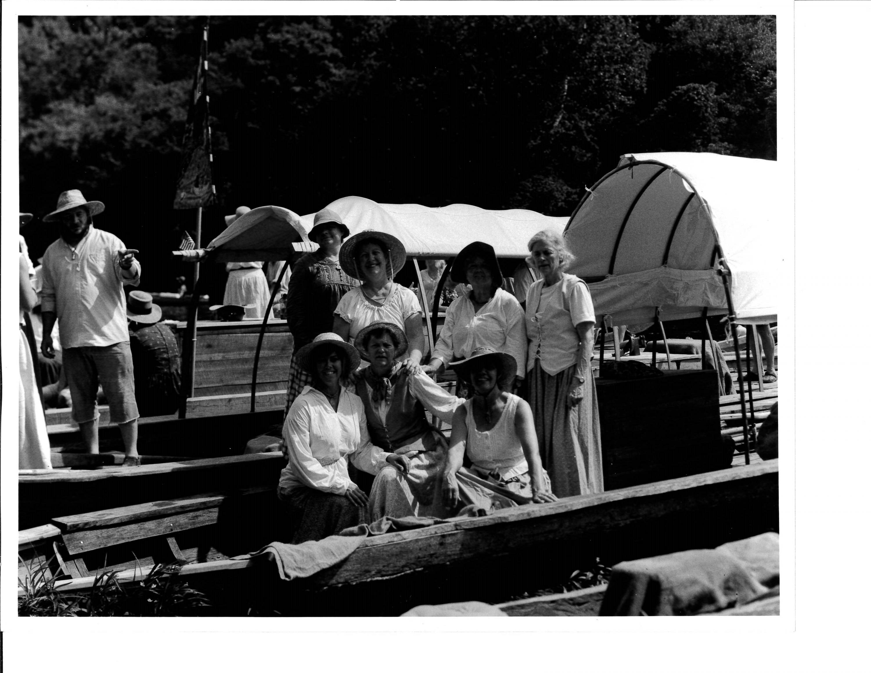

Here it is, my efforts with Bergger 400.
For what it is worth the scan does not do the print justice.
I will admit that I am not into digital, another long story, or scanning either.
My first exposures were not what I wanted, underexposed, after the first batch of prints I adjusted my exposure, set my light meter at 320 not 400. That seems to be working for me. I did use the Bergger developer, available from the French Bergger web site. I am happy with my negatives. I am happy with the results in my prints. I use Adox MCC 110 paper.
I am comfortable suggesting you try this film. I have a batch in 35mm that I will be developing for a friend to learn if this works for her too.
At the least a new film is something to celebrate.
Then again every time I decide on a film something happens and the film is out of production, Ie Efke was my favorite in the past. I hope Bergger continues making this film.
Good luck, your results may differ.
So is this a poor scan of the neg or a poor scan of the print on MCC110? I take it that on the print the shadowless areas have detail? If so a pity that you can't configure the scanner to replicate the neg or print.

I cannot show any results as I print all of my negatives using an enlarger, I don’t own a scanner. If anyone in Melbourne is able to scan 4x5 negatives and they wish to scan to have a look, then contact me, then either these or different Bergger negatives could be shown.
Just a thought Mick, are you in the Aussie Print Exchange this round? If you want to post a neg through, I can get it from Hoffy, scan it, and get it back to him to post back with all the rest of the pics (or just send a print that doesn't need returning).
Yes Ian, you are correct, the poor digital image does not do the film any good. Thank you for being blunt and your observations.
My motivation is someone need to use the film, and perhaps more correctly show some images from a new film.
This is the poor scan of a print, I do not own a scanner and had to borrow time on a scanner.
My own experiences are that any scanner that is usable by normal persons is the comprise of quality and unless you have the calibrated monitor then what anyone sees on their screen may not be accurate.
For me I will continue to use this film I like the look of my final print. And will suggest that this film is worth a try for anyone so inclined.
I find it incredibly awesomeness that any new film is being manufactured in this day and time so thought I would try and support this product with my purchase and use.
Hope this works for everyone.

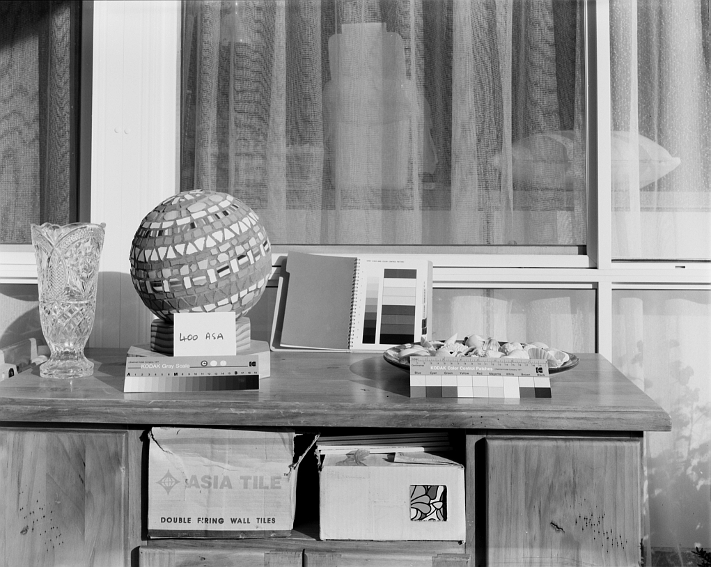

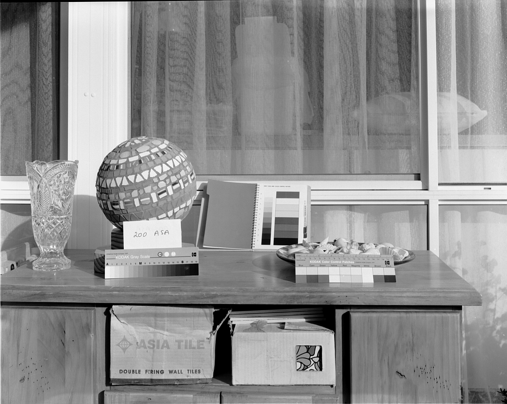

I'm not sure if these will work, as the file size may just be a bit on the big size. Someone else scanned these for me.
The book at the back with the grey card page on the left, has a shadow from the slightly lifted of grey card page. Note that the 200 ASA image has a greyer shadow compared to the 400ASA one which has a darker shadow. In other words, the 400 ASA exposure does not have as great a shadow holding compared to the 200 ASA. Which all things being equal, is pretty much fully expected.
Both sheets were exposed under winter sunlight coming through as a cloudy bright light type of day. Time was 1430hr to allow the sun to shine on the back verandah.
Both used a 150 mm lens with an orange filter. I almost always use an orange filter, so I tested this film with my orange filter. Both were using f/22 with one exposure at 1/60 the other at 1/30.
So far so good. I would suggest you copy these images onto your computer and oscillate between both of them quickly to see the shadow differences, which are there in quite a few places.
The cardboard box under the bench top on the right, has a small section of that box missing which shows a graphic ceramic tile, I see a real difference there. I also see a reasonable difference on the Kodak colour chart.
Any way, thoughts would be appreciated, but do remember that these test sheets are for my camera and lens and developing regime. My developing technique for these two sheets, are noted in an earlier post of mine.
Over to you.
Mick.

Flicking between these two there is no contest for me. The 400 ASA has by far the better look. It's brighter sharper with the right contrast.

Don't read too much into supposed sharpness. Both of these sheets of film were scanned with a scanner that uses an auto focus system, which is now gone kaput, in fact it went kaput after doing both of these sheets of film, so there is the possibility of there being an issue with the second auto focus sheet of film which was the 200 ASA sheet.
This is the first time I have ever seen film scanned, interesting and frustrating to say the least, glad to be back in the darkroom to be honest.
I have just come from the darkroom where I checked both sheets of film under a loupe on the light box. Trust me when I say they are both razor sharp and both are of extremely good contrast.
There are differences and those differences are certainly noticeable.
The major difference is in extra shadow detail in the sheet exposed at 200 ASA, which is to be expected. Contrast looks ever so slightly less with the sheet exposed at 200 ASA, which is also expected. I would suggest you concentrate on the shadow detail differences, as well as the slight differences in the colour chart. Doing that is what these images are supposed to be about, the apparent correct focus and better sharpness and/or contrast of one sheet compared to the other, is not in a fair comparison here as the methods used to get these images to you, do not reflect those two parameters as they really are.
This is an unfortunate situation brought about by my eagerness to show something of interest but lacking the ability myself, to bring them to you in a very neutral manner. Very rarely will I suggest it is the equipment that has failed me, generally I have failed the equipment. However, in this instance, the equipment has failed me. It also failed the scanner owner as the scanner now doesn't work.
If you expose film and are able to get shadow detail and retain as much high light detail as possible, then when you are printing you generally can make a very usable if not very nice print which you should be able to make as snappy or as flat looking as you would like it to be. I would be able to do this better with the 200 ASA exposed sheet than I would with the 400 ASA exposed sheet that I have sitting on my light box in the darkroom.
My conclusions are that either exposed sheet will do what I wish to do, but I will probably use an Exposure Index (EI) of 320 ASA for much of my work with the occasional sheet exposed at 250 ASA.
Since doing these test sheets, I have exposed another 4 sheets of this film and developed them. To say I am happy with the results would be a gross understatement, this is a very nice film. Today, shortly after sending this on its way, I am off to expose some more of this film, with development tonight and possibly prints of all, including contacts and enlargements of these two sheets, tomorrow.
I am not an expert, but I have been developing film and making prints for quite some time. Generally I just use techniques requiring no equipment other than a light meter and tight processing parameters. There are a handful of people (probably a lot more) on this forum who have excellent technique and can do tests in a more scientifically controlled manner. Please understand this and don't take my way, as the way.
