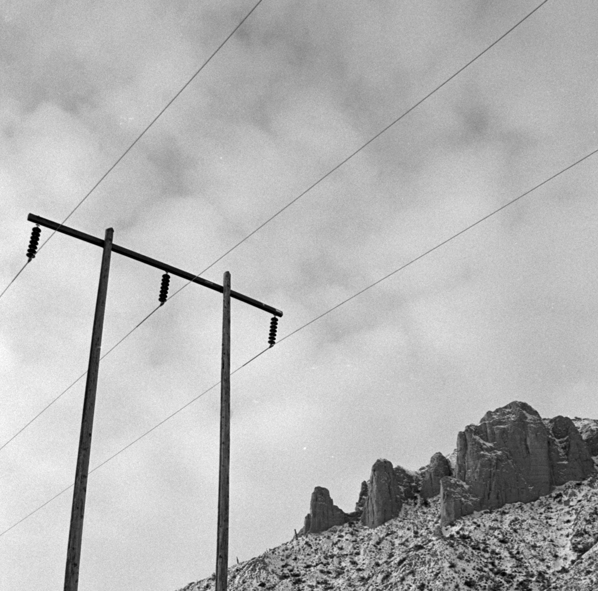

Cropped 35mm HP5+. Semi-stand in very dilute Pyrocat-HD. Looks pretty good to me, grain-wise.

Craig
Apr 8, 2004
2,532
Calgary
I have a series of three 11x14 prints framed and matted hanging beside each other in the house. One negative was 35mm HP5, one is 6x9 Delta 400 and one is 4X5 Delta 100. All developed in Xtol. Brought experienced photographers into the room and asked them to look at the prints and tell me which negative is which. So far no one has got it correct. To me that means the HP5 grain is perfectly acceptable!
