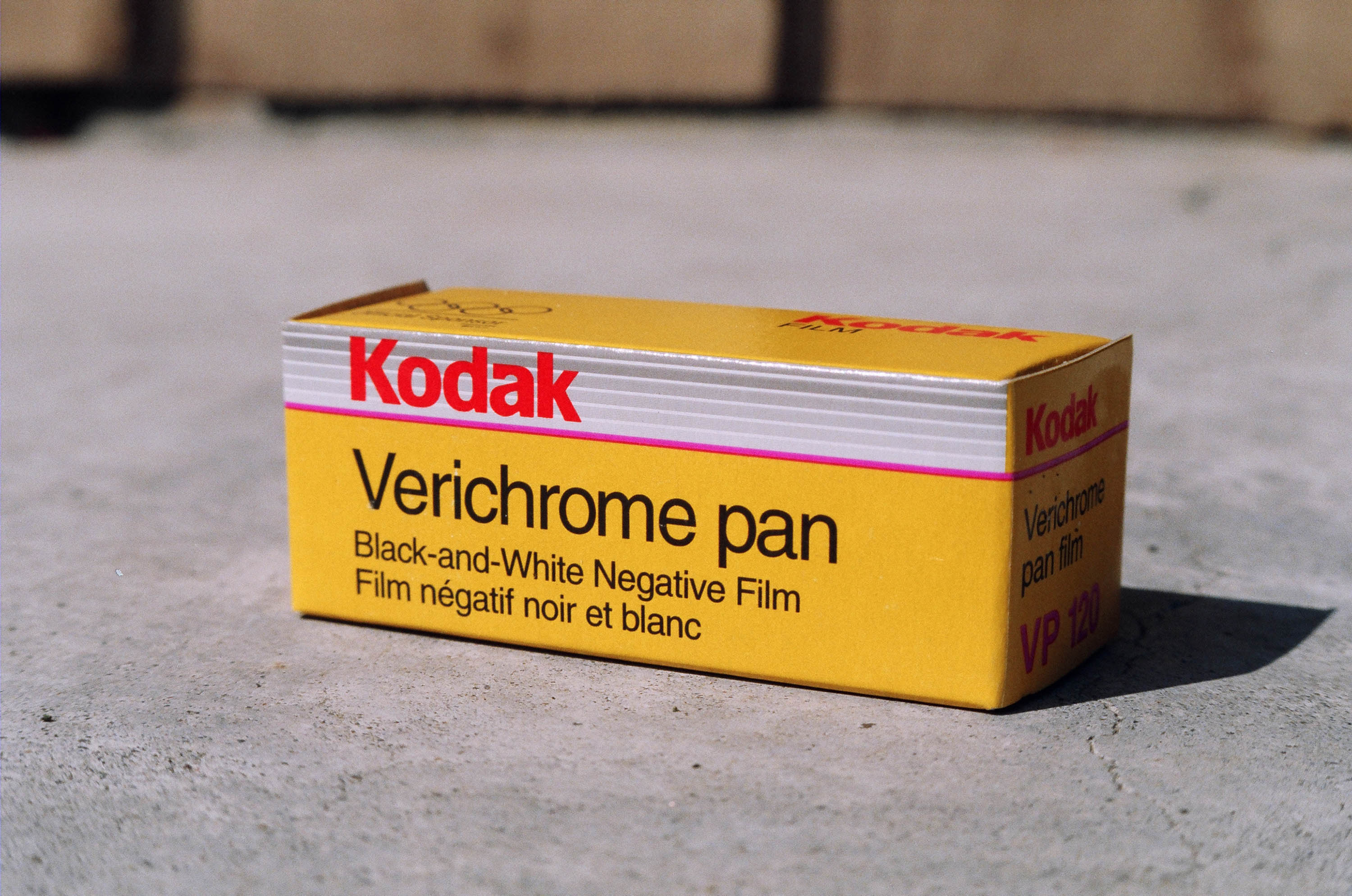

Matt,
This was VP film in 120 I bought in around the early 2000s fresh stock from Vistek Ontario. I got all the last remaining rolls they had of it then. So yes VP was available in 120.

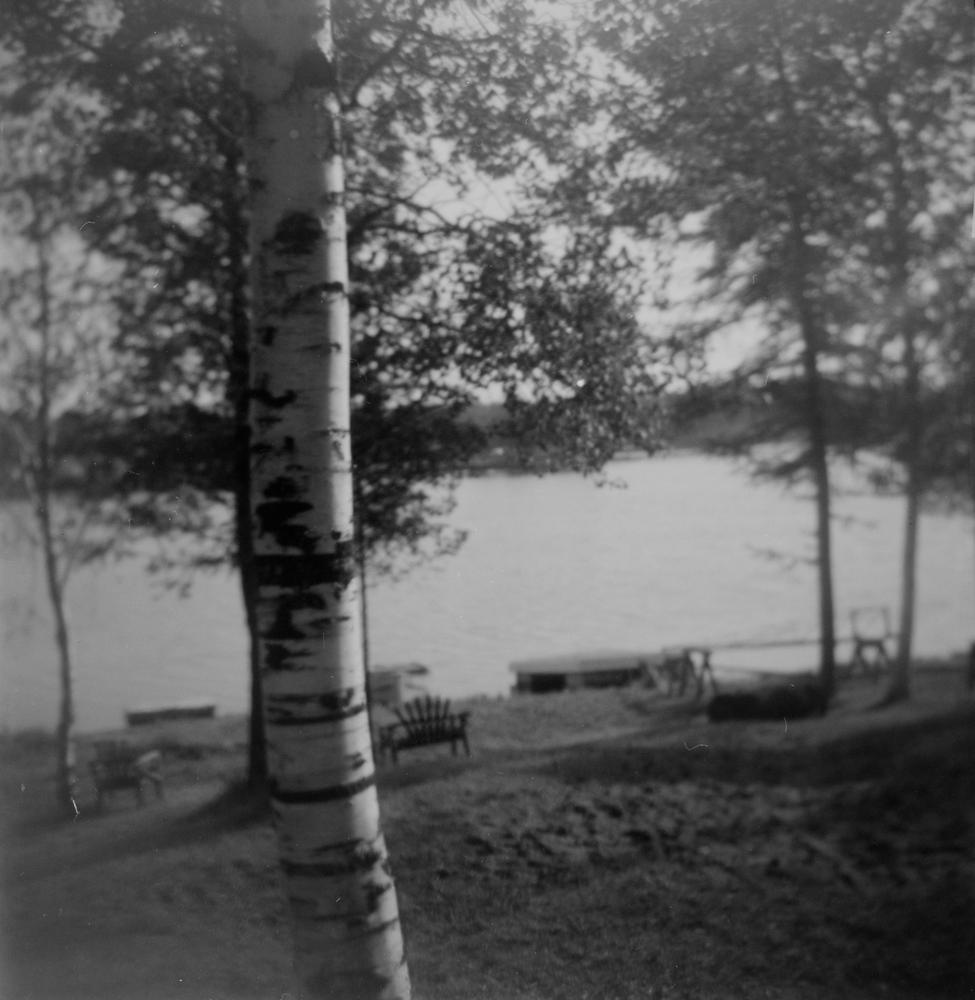

Here is an image from this roll. According to our findings the latent image must be about 60 years old. It was developed in HC-110 dilution B for 7 minutes at 16 °C.
