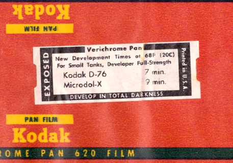

When did Kodak introduce new development times for Verichrome Pan?
Perhaps in the 1960’s when the ISO speed changed???
What an interesting way to notify users!!!
From the serif typeface of the Kodak logo, that backing paper is more than 50 years old. Are you shooting such antique film?
Kodak also used that type of message to inform customers of the pending discontinuance of 127 film, c.1982. Last year or so, I was given a couple of rolls of 127 VP with such labels.
I never paid attention to the typefaces on the backing paper. Thanks for the tip. The film is from the 1950s or 1960s.
No. I developed a roll of "mystery" film and am trying to find out when approximately it was shot.
I did shoot a few frames of Verichrome Pan type 116 some time ago and the results were quite good considering the age of the film. The original Verichrome (orthochromatic) and Verichrome Pan seem to last very well both unexposed and with latent images.
FWIW, those seem to be the times provided for in the 1996 datasheet for Verichrome Pan.
@laser may have some perspective on this. That label may correspond to when Verichrome Pan changed from using its own emulsion into a revised (and lower cost to manufacture) implementation of the same emulsion as was used for Plus-X.
I believe Plus-X predates Verichrome Pan, so the new emulsion could have been introduced for these two films simultaneously. The introduction of new development times could be either due to a change in the emulsion or the way film speed was measured.
It is good to know that the "new" development times did not change till 1996. Verichrome Pan must have been discontinued a few yeas later.

Plus-X in 135 format was fundamentally revised in the mid-1950's into something that we would recognise as a 'modern' 3D crystal structure emulsion with massive performance improvements across the board. At the same time, Verichrome becomes Verichrome Pan, and the Kodak marketing of the era is pretty clear that VP in rollfilm formats = 135 Plus-X/ PX. 120/220 PXP and long roll/ sheet PXT (which radically changed curve shape in certain developers) were different beasts to 135 Plus-X, however people love to throw around generic assertions about 'Plus-X' when it's only ever a specific form/ use case of it that they are talking about.

Verichrome didn't work with a red filter, because it was orthochomatic. The pan version came out a short time after PlusX, so it makes sense it's just the PlusX emulsion on a different 120 base (PlusX 120 and 220 had a retouching surface base, Verichrome Pan did not). Or such is what I can glean from what I can find online.
I'm not sure that I gleaned quite the same conclusion, but I know that I stocked up on Plus-X when it was withdrawn and wish that I had also stocked up on Verichrome Pan when it was withdrawn. I was a convicted Plus-X user and once the shop was out of Plus-X so I reluctantly bought Verichrome. It was actually a better film for general photography. Plus-X excelled in studio conditions, though. I stil have a bunch of Plus-X in 35mm and 120, which might have been a bad invlestment as I'm sure it is doing nothing but declining in quality as time passes.

As I understand/remember it, the older versions of the Verichrome films - possibly including both Verichrome and Verichrome Pan - used combinations of emulsion components that resulted in greater under-exposure and over-exposure latitude (at the expense of lower resolution and sharpness??). As such, they were great for box or other simple cameras.
Once those emulsions were replaced with the emulsion that was essentially the same as Plus-X, the exposure latitude suitability for simple cameras was achieved by using much simpler and less effective anti-halation tools.
I always assumed that Verichrome was originally from an era when box camera was a significant amateur roll film application, hence the source of the enduring association of Verichrome with amateurs and box cameras. My experience with Verichrome did not indicate any reduced resolution or sharpness. That might be true for the original Verichrome, but some seem to have said just the opposite for Verichrome Pan. The data sheets seem to indicate insignificant differences in sharpness and resolution.
It is interesting that VP/V has such good latent image retention - certainly confirmed with folks who process film found in old box cameras. Photos taken on Verichrome in the 1930's yield acceptable (this maybe a novel use of the word 'acceptable') prints when developed today https://www.westfordcomp.com/found-film-page-1/
Kodak may have baked this characteristic into the film, knowing that the 'family camera' may only get used on birthdays and holidays and it may take several years to use up a roll of film.
