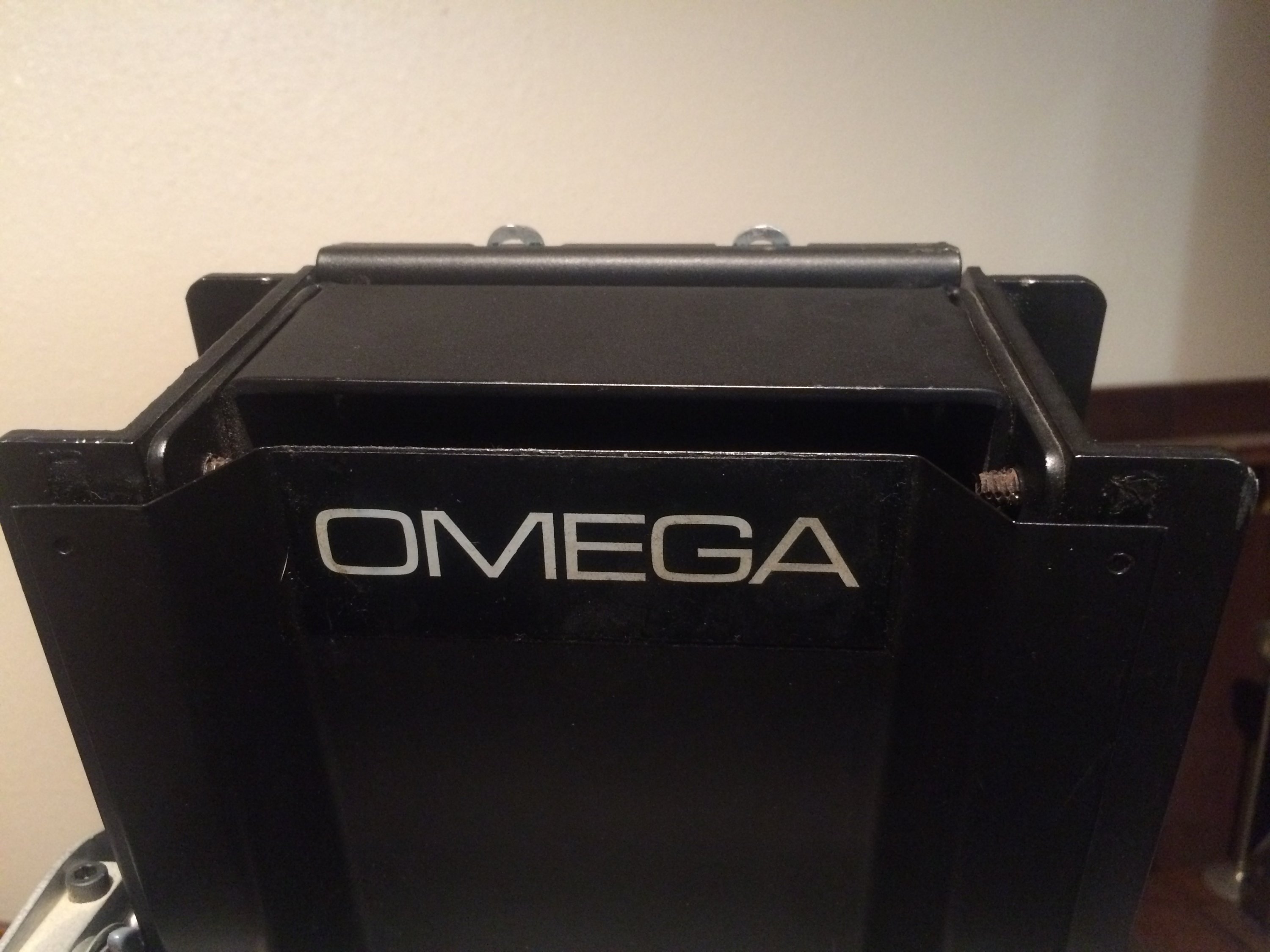

Hello all. I've been lurking the forums for a few months, but I recently purchased my first enlarger, and have started setting up my darkroom, so it seemed like an appropriate time to join in. My enlarger is an Omega D5XL with a Dicro. II head, and I had a few questions about some neurotic concerns I'm having.

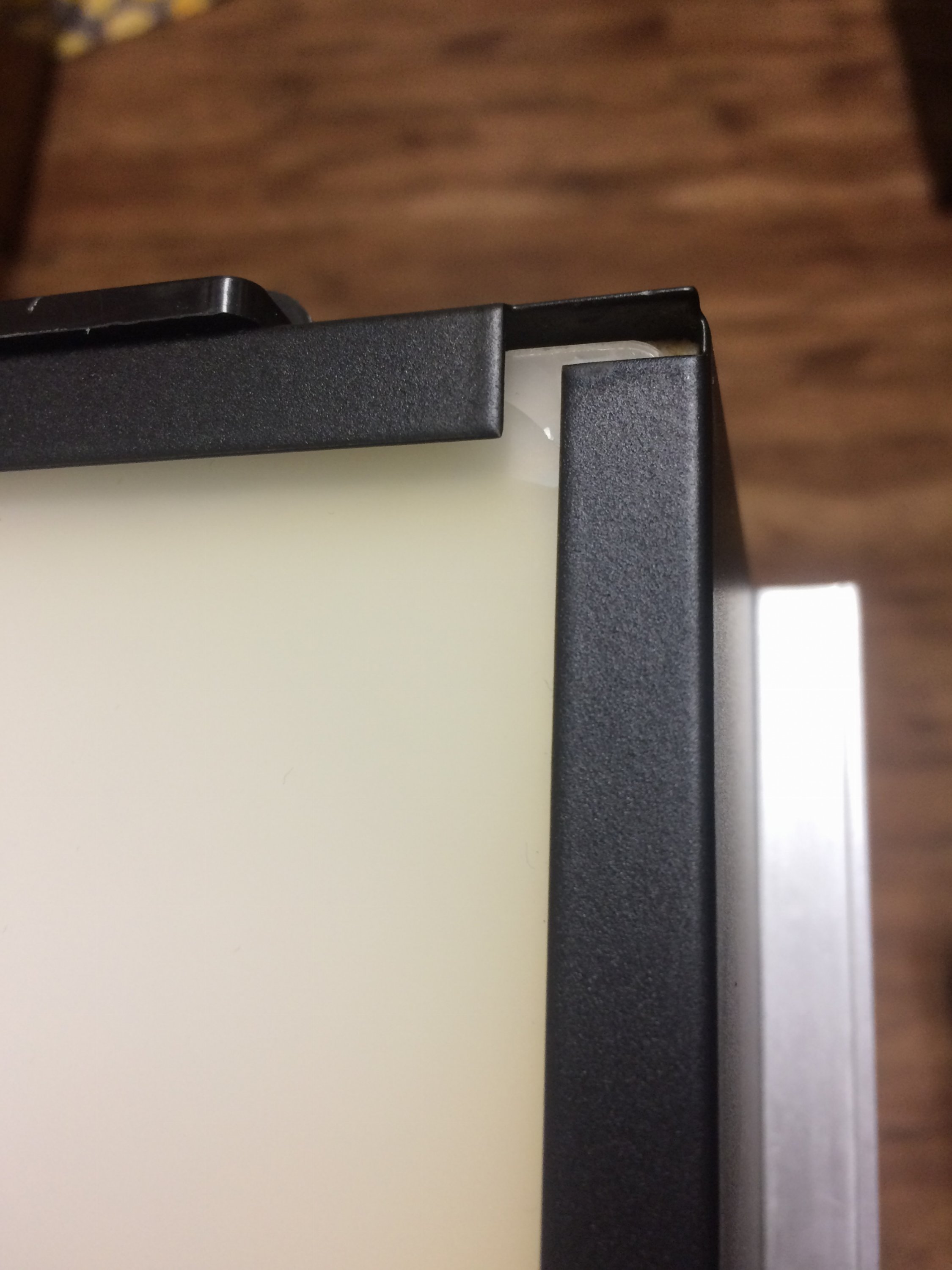

Secondly, the diffusion panel in my mixing box has a crack in one of the corners. I know that the styrofoam liners and diffuser should be replaced periodically, but will the crack cause an immediate issue with uneven illumination?
Thirdly, the "ruler" or panel in the center of the column has (presumably) detached from the column itself, has worked its way down, and is resting on the base of the column. It appears to be about 1/4 inch lower than it should be. Has anyone else had a problem with this? Is it a non-issue? I have tried pulling the panel upward to re-seat it in its proper place, but it doesn't seem to move.

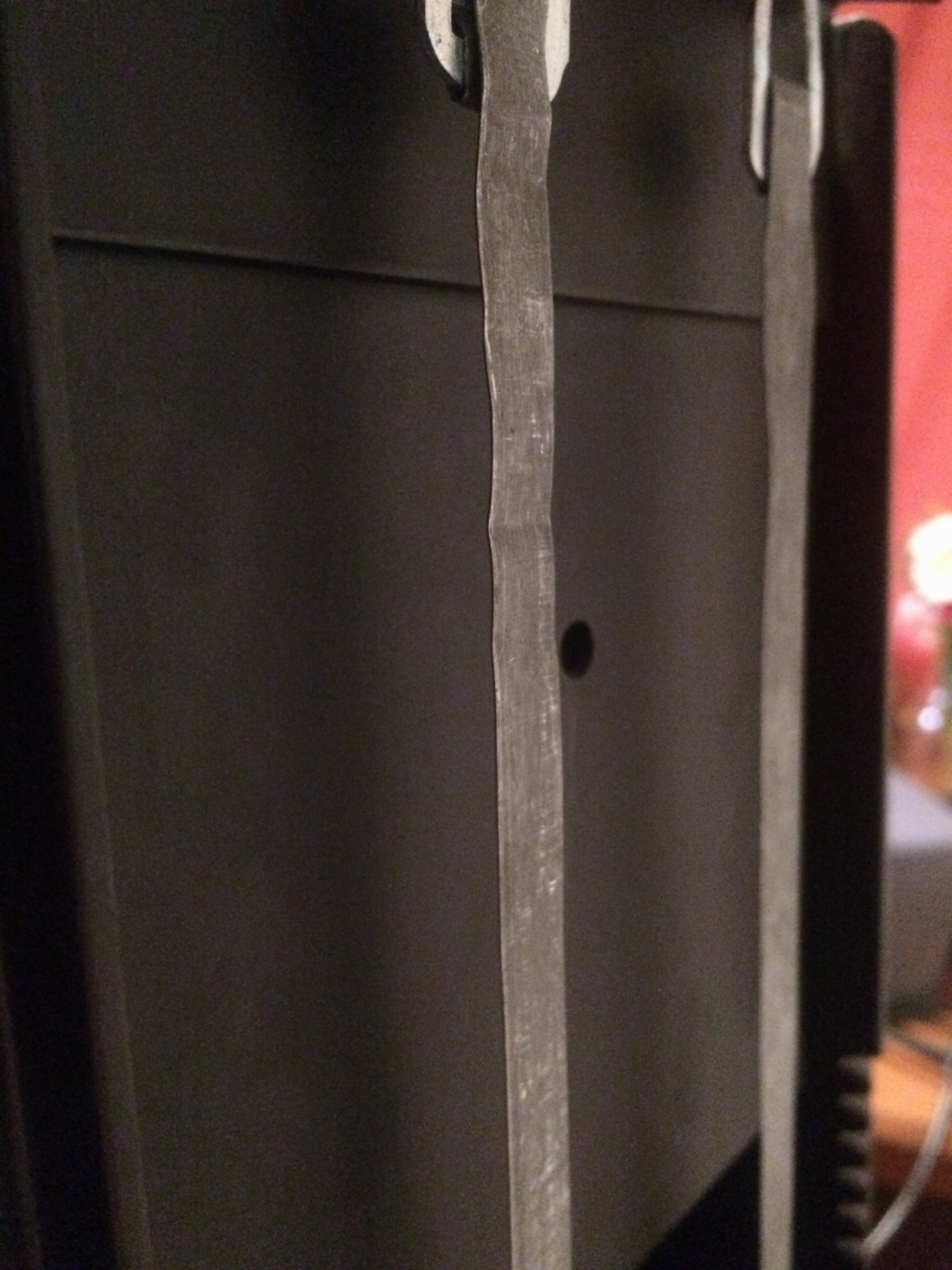

Lastly, the counter-balance springs' metal ribbons look a bit rough. Should I go ahead and replace them, or do they still have some life left? When raising and lowering the head, the springs sound a bit creaky, but I'm unsure whether or not this is normal. Also, I'm curious about librication of the counter-balance springs themselves. I have read somewhere, perhaps here on APUG, that a good squirt of WD-40 inside the spring housing will preserve the life of the springs. Is this a good option?

The only comment I would make is that you should avoid WD40. I've used Vaseline with success - just use it sparingly.

Thanks! Vaseline definitely seems like a better option. I probably am being too paranoid, but I've seen machines practically destroy themselves if not properly maintained, so I'm just playing it safe, I guess.
I like to use ChapStick for these parts because it stays in place and doesn't get goopy.
My suggestion would be a light coat of white lithium grease.
I kept a bank of these alive for a couple decades.
You probably will not find replacements for those springs -- I had several made by a spring company back east (they make window counter-springs) but do not have the name anymore. To prolong the life of the springs, store the enlarger head up high to take some of the strain off of them...at least above the 50 mark. I used vasaline on the springs.
The head carriage is probably keeping the back panel from moving. You might poke around there.
Omega used to actually recommend using Vaseline in the D-2 era. The "ruler" is just held on with double stick tape, as is the trim panel on a D-5, it's just cosmetic. Would worry about the crack in the mixing box, either until you can test and prove it's a problem/ Have fun!

KHB has new springs available but YIKES! I picked up a couple of used ones on eBay for $10.00 each. You could also make a counter balance with a sash weight and pulley if all else fails.

You recommend Pullman Manufacturing. I may try to contact them in the future to see about replacements. Based off of the suggestions in that same thread, I have been keeping my head at about 50% to 75% up when not in use. Hopefully that will help.

Regardless whee you source them, when they're loosened they can do some serious bloodletting.

I recommend this spring replacement kit. It makes a night and day difference. Price is in Canadian dollars. http://store.khbphotografix.com/Counterbalance-Spring-Upgrade-Kit-for-Omega-D-5-Enlargers.html

Wow -- they look to be a great improvement in design -- close to the Beseler springs...which I never had break. If I was still working at the darkroom, I would have slowly replaced the original springs with these (depending on the budget, of course)!

ROUTINE MAINTENANCE LUBRICATION Your enlarger has been factory lubricated during manufacture. Occasionally, rub a little Vaseline on the counterbalance springs after lowering the carriage to its lowest position. Before applying, clean springs with a soft cloth. I f you have a D-5 enlarger, also apply Vaseline to the focusing track. No further lubrication is necessary. CLEANING Keep the enlarger clean and free of dust. Protect the enlarger when not in use by covering with an Omega Dust Cover. The Dichroic lamphouse cooling blower should be checked periodically for dust accumulation which should be removed with a vacuum cleaner or blown out with compressed air. OTHER MAINTENANCE Make a regular check of baseboard bolts for tightenss, as loose bolts can cause poor print quality. Keep enlarging lenses and condensers free of dirt and finger prints.

The reference I made about the springs being dangerous is because there's a lot of tension
on them and they will do some serious cutting to your fingers if they slip & run into the fleshy bits.
It's something to be aware of but not paranoid about.
