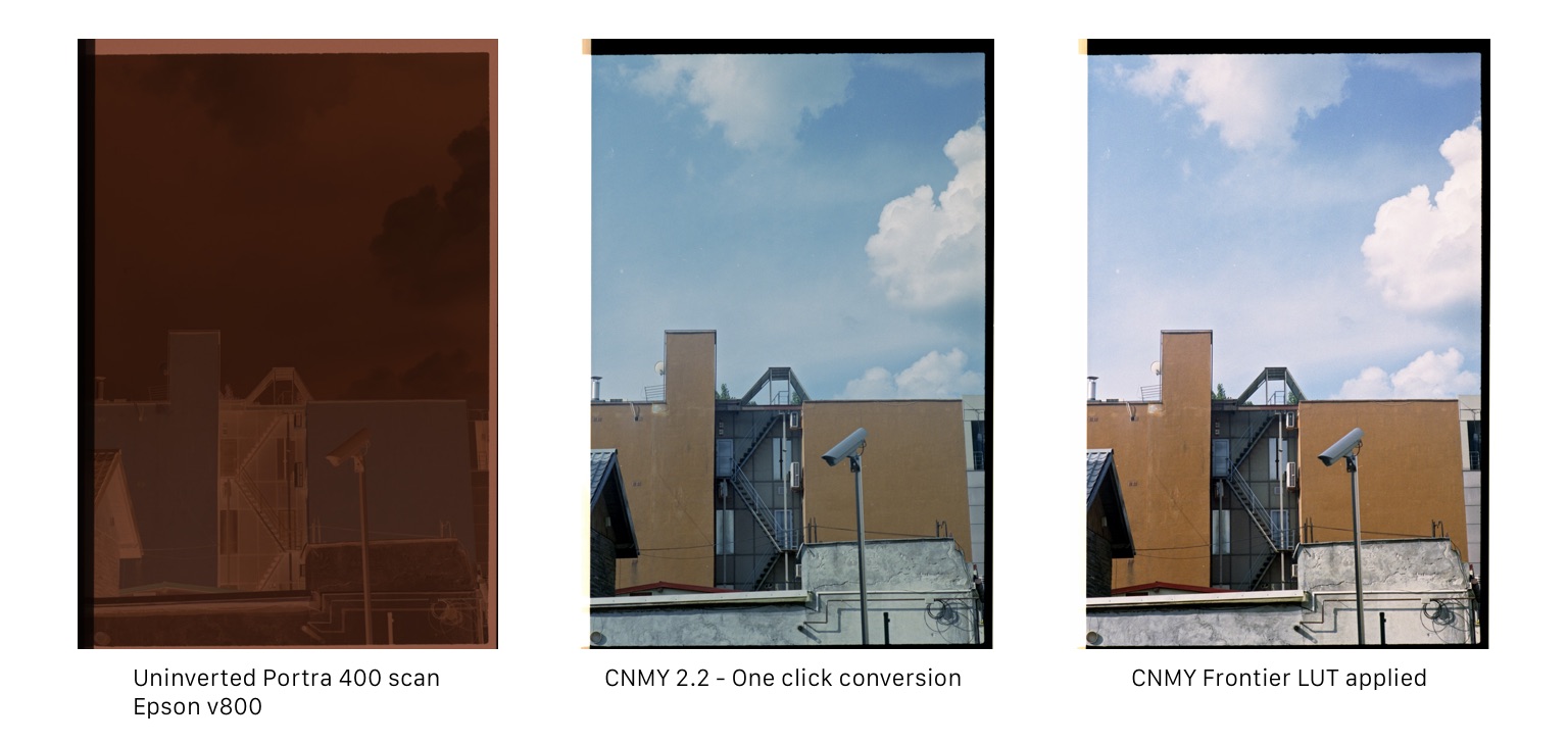

Today, a milestone release of CNMY brings some major changes and improvements.
  • Starting now, CNMY is a one click inversion. Sampling of the negative is no longer needed
  • The default inversion now has a flatter profile, with extra care given to highlight information
  • Patrons get the exclusive AutoColor - Frontier preset, which uses a LUT to emulate the look of the Fuji Frontier professional scanner.
  • The inversion is now up to 50% faster and supports batch workflows in Photoshop
Here are a few samples showing CNMY 2.2 together with the new Frontier 3DLUT profile.
The new inversion method is designed to give a flat and consistent result, ready for adjustments and grading, and to be used together with the Frontier LUT, and many more to come!
