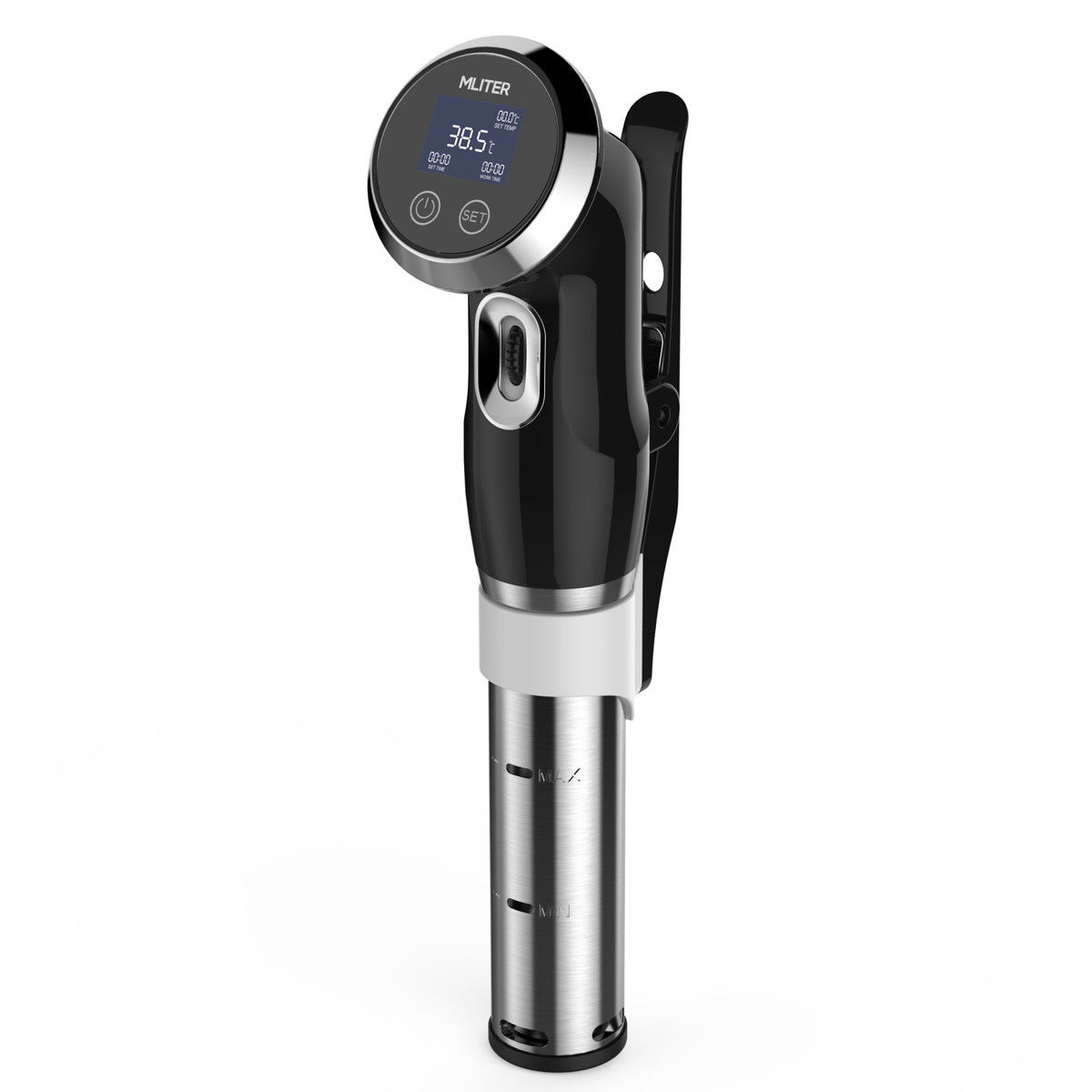

https://petapixel.com/2018/09/24/ci...-like-a-sous-vide-cooker-for-film-processing/
Quote: "And while the TCS-1000 may look strangely similar to sous vide sticks on the market, it was completely designed by CineStill and isn’t related in any way to existing cooking products."
Strangely similar product (MLITER 1000W sous vide) is not well rated, I wonder how good this can be.
And really completely designed?

Looks extremely identical. Would be interesting to see the inside from the large opening on the back.
I'd have been very surprised if they had designed it from the ground up. My assumption was that they went to a supplier and ordered specific features, like the heating element and of course their firmware features. The chance of a gentle heating element and warranty under use in chemicals were the reason I bought the Cinestill one. No second guessing as when picking a suitable device among the many out there.
