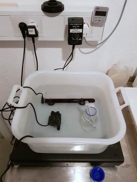

This is exactly why I got myself this contraption:
Nova 300w heater, still available new, and an aquarium pump. All purchased s/h, works very well with C41 and E6.
