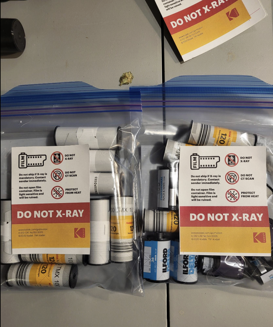

In a recent trip to Martinique, from Montreal, had fifteen 120 rolls and six 35mm rolls in two zip-lock bags with Kodak "Do not X-ray" stickers on them, and showed them to the person in charge even before I put my other stuff in the tray. Had no problems getting a hand check both in Montreal and in Fort-de-France (helped that I got to the latter very early).
Sticker makes it look like you're a pro going on an assignment. Say what you will about the company, but the Kodak colours are still well recognized and do impress people 😎 😁

I also have those stickers to print. It there is something saying that it will damage your property, they don't want any problems... I once did an experimiment in Lisbon, once I took my rolls in the camera bag, and asked for hand check, they denied, saying they don't do that. Another time, I took them out of the boxes, and but them in a plastic bag, they where very polite, and even asked if the swabs would do any harm because they had to at least do the swabs. Since then, I always put them in ziplocks and never had any more problems.

As of the stickers, I actually just print out on ordinary paper and tape them to the bag. On my Asian trip a couple years ago, I was going through customs and given the rushed line I just chucked all the film into the scanner. It was a traditional scanner and the parallel CT line was off.

I haven't tried the Kodak stickers but since the advent of CT scanners for cabin bags, I've packed my film in a clear zip bag (in the manner we have been packing liquids for the last 20 years). It probably helps that I have a few boxed Kodak colour films as I do believe that the yellow boxes and the Kodak logo are recognised. I wave the bag and ask if the scanner is safe for film, and have got a hand inspection.
