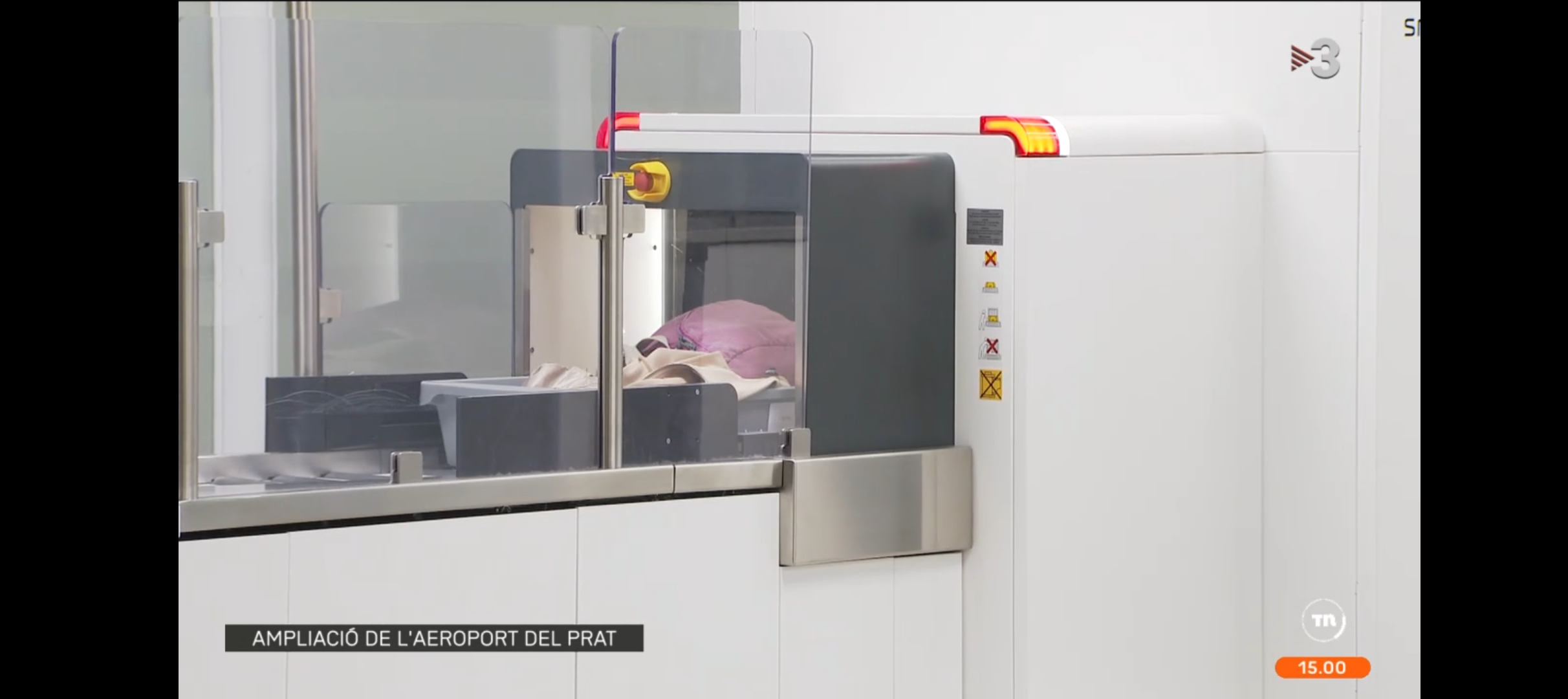

Just seen in the news today, and grabbed a screenshot where they show a current CT scanner line.
Barcelona airport will start to roll out CT scanners in Terminal 1.
However, note from the screenshot that little icon! A roll of film with a cross over it.
Seems to show that Europe wide the policy is/will accomodate hand checks for film.
