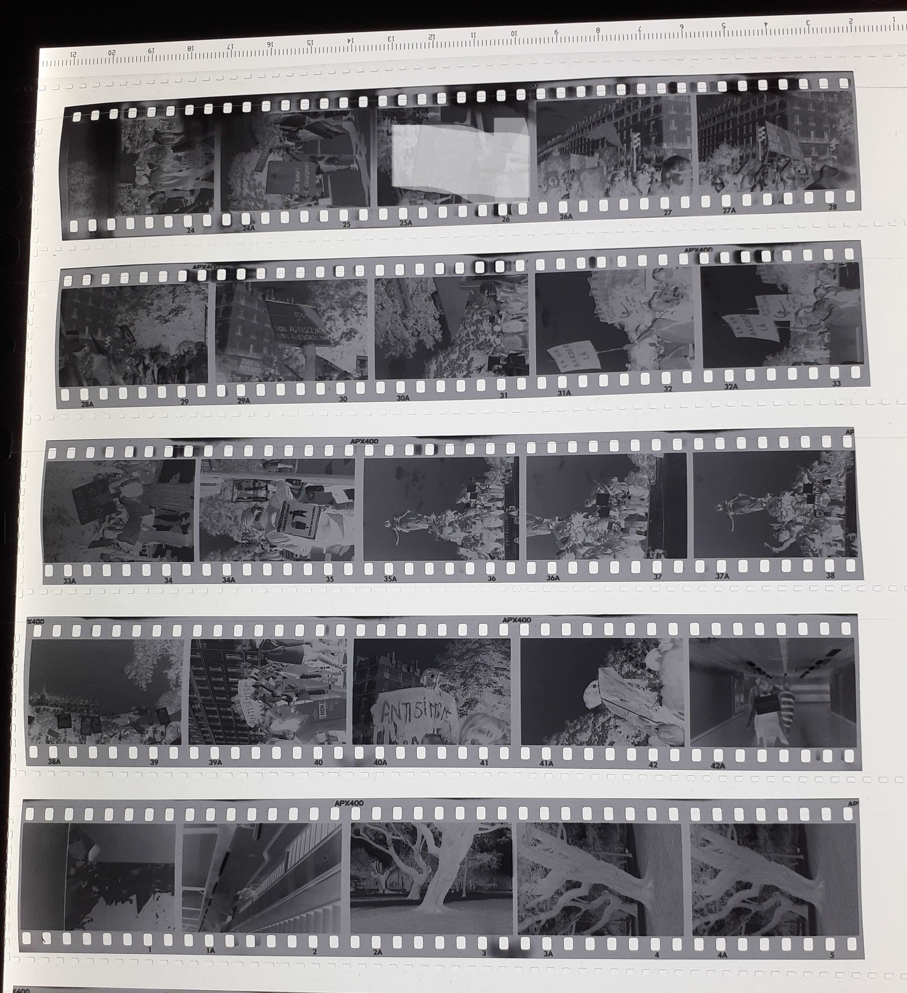

So, here are the results. APX 400 - bulk loaded into plastic cartridge - went once through old x-ray machine and then through who-knows-what in checked luggage (Argentina to France).
I don't see anything beyond the usual light leaks at the beginning of the roll...do you informed eyes catch anything else? Is there a chance that I'll notice something once I get into the darkroom and enlarge? 🤷‍♀️
