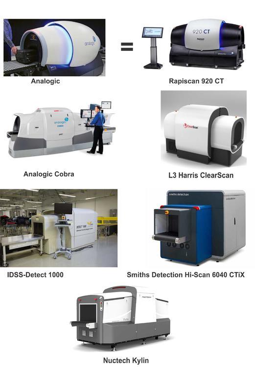

Not all CT scanners are round. PDX uses a model, whose name now escapes me, that looks like a big rectangle with slightly rounded corners in cross-section. They are noticeably different from the “classic” X-ray scanners, bigger and with more exterior plastic, but they don’t look like the “round tunnel” models.
I think the only reliable criterion (in the US) is whether laptops can stay in; if so, it’s a CT scanner.

Here's a picture I snagged from somewhere a couple of years ago showing the various models then available.
