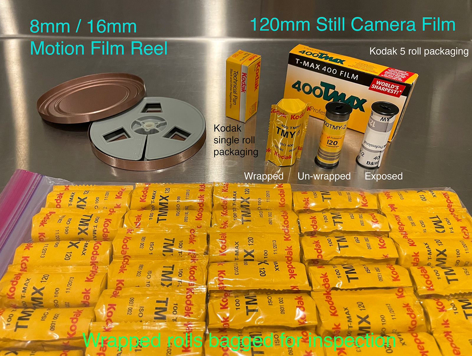

My reply with the photo is as follows:
"Thank you so much for your prompt reply. The information you have given is encouraging for those of us who still use film to produce our work.
To clarify, the 16mm films you refer to that need a Dark Film Loading Bag are motion picture films that are on reels and in cans and indeed, can not be at all exposed to light so they need to be inspected in this manner.
The film I am using is 120mm roll film that are much smaller and can be hand inspected in the light to a degree. As you can hopefully see in the attached photo, the 8mm / 16mm style film can is on the left, the 120mm film on the right. In detail I have shown the various packaging that you might encounter and the progression of how they are sealed in cellophane wrappers to protect from moisture, then unwrapped for loading in the camera and then once removed the camera, the backing paper is another color denoting the film has been used and is ready for development.
Basically in the past, the cellophane wrapped rolls are hand inspected / swabbed so I at least remove the rolls from the boxes and put them in a clear plastic bag to make it easier for security personnel to do this. If need be, the films can be removed from the yellow wrappers to be looked at further but the paper can not be unwound as it will expose the film.
Ideally I like to keep the film in the wrappers as to protect it from moisture in harsh environments but I am willing to work with you in any way you need to facilitate this inspection successfully.
Please let me know your thoughts on this as time permits and thank you again for your assistance,"
I'll let you know how this goes when I get a reply...
