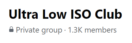

Oh wait, the post immediately before mine ^^^^ ... except that the FB group in question has a grand total of 3 members, the set of which, I do not belong.
I was so absorbed in the Harry/Megan interview with Oprah
You might need to get your eyes tested.
yeah, I might. But then, I almost never go to the wasteland that is Facebook. I don't bother to actually read their pages. I just scan them. hence, missing "1.3k members'
So, good call out. I appreciate you for that.
But in fairness to me, that home picture really grabs the attention. Who cares about the trivial text below it :smile:
