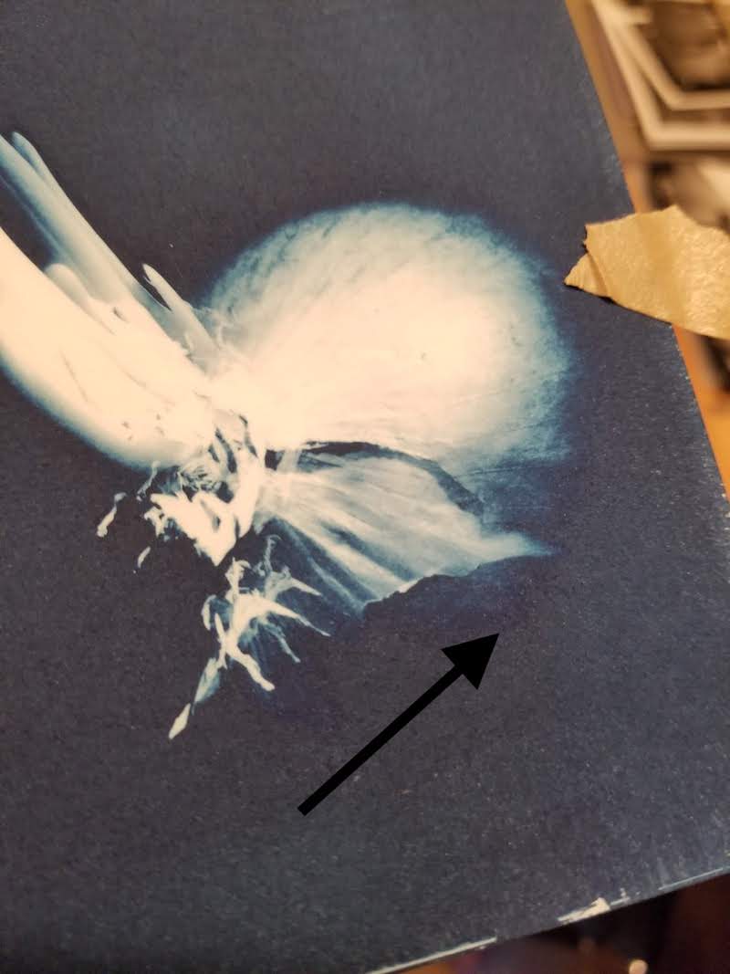

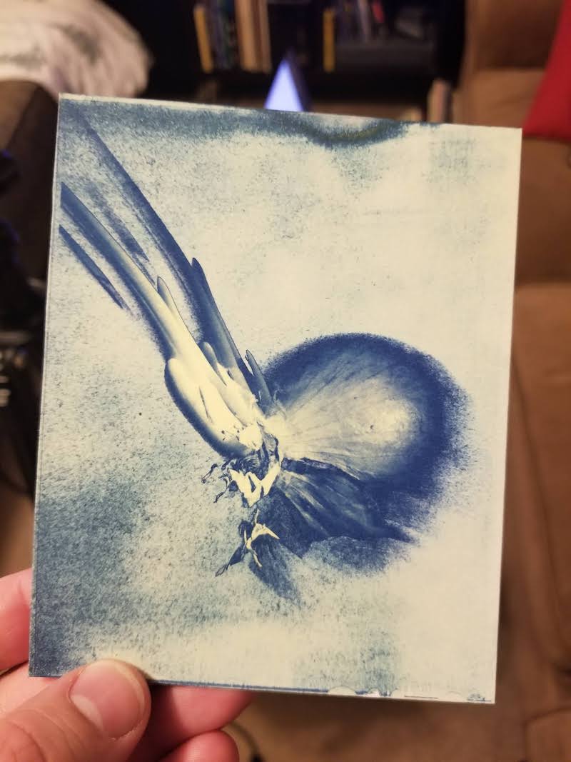

Cyanotype: This was super interesting to me! Before I got access to my community college darkroom, I had been making tons of Cyanotypes and even upgraded to the "New Cyanotype" formula. This is a comparison of New Cyanotype to Multigrade paper. It really blows me away how incredible these "modern" materials are. A couple interesting aspects of the cyanotype curve; the elbow shape with a low-contrast toe and then a short, high contrast, section leading right into the shoulder has been something that is really annoying me about cyanotypes because its so hard to get clean highlights and dark shadows at the same time. I had to start creating really high contrast negatives by giving N+2 development to make them look okay. Cool to see that vindicated in the data. Also the slight upwards hump at the end is a real thing. The cyanotype process reverses pretty significantly with over exposure and starts creating "Prussian White" instead of Prussian Blue. This oxidizes back to blue but never quite as dark as sections that weren't over exposed.
Cyanotype contrast: One thing I noticed a while back is that the amount of acid mixed into the sensitizer had an effect on contrast. Its more subtle than with multigrade papers but noticeable in prints and here in the data.

Yes, New Cyanotypes ask for crazy long-scaled negatives. I see people underestimating this all the time; the same for salt prints BTW.
With silver processes and in particular Van Dyke Brown this is also a common issue. It tends to be fixed by gold toning. It also has to do with how heavy your sensitizer is laid down. If you try backing it off a little, the problem might be reduced somewhat without affecting dmax.
Sure does, as with other processes. Notice also the highlight degradation; that's the price you pay. There's a balance there that can be difficult to hit sometimes. But it's been a long time since I did any New Cyano's.

Interesting... yeah I'm using Hahnemuhle Platinum Rag for the blueprints which is definitely a delicate matte finish. I'd be interested to read more about coating. I guess that's pretty much a standard last step for daguerrotypes so I'm sure there's some pretty solid methods/materials to try out.

I always hit my prints with peroxide in between washing steps. I know its not necessary but its too damn satisfying to skip :wink:
With my sensitizer I get really intense reversal during the exposure which pretty much goes away after oxidization, but doesn't quite go as dark as dmax which is a little odd

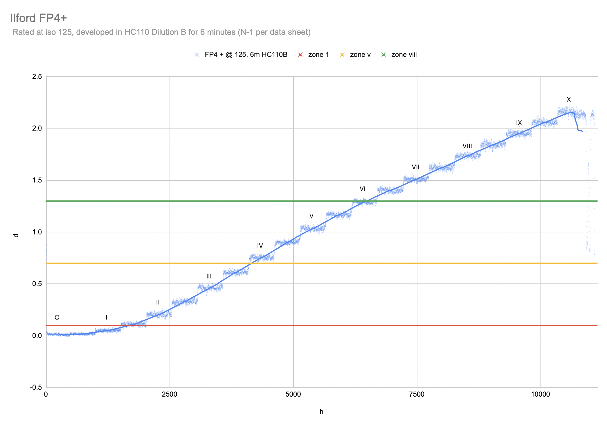

Took a stab at using this scanner method to analyze a sheet of FP4+ that I gave a Zone X exposure to with the step wedge taped on top of. In theory that should place the clear section of the step wedge on zone 10, then as the step wedge gets denser, we move back down the tone curve with step 21 corresponding to 11 stops less aka zone zero.
I'm still not quite sure I'm calculating density correctly since the densities I'm getting seem way too high compared to what I'd expect based on the targets that are in Ansel Adams "The Negative". Basically I'm taking the scanner value for unexposed film (high number because lots of light passes through) and calling that my film-base-plus-fog-raw (FBFR) level. Then I'm taking each pixel value and calculating log(FBFR / pixel_value). This seems to create an H&D curve that looks right in that it starts near zero then has a toe, then zooms up with a relatively flat section, but the values near the end seem too high. I threw in horizontal lines for the density targets from the book for reference. I'd expect with N-1 development that I wouldn't 2 stops denser at zone VIII than expected.

Does anyone know if I can corroborate this using a light meter? I'm not sure how to get proper density numbers with that method either
@jonmon6691 - this has been discussed at length in several densitometry/sensitometry threads, IIRC @radiant has applied a scanner as a densitometer with good success.
Briefly, using the transmission step wedge, you can calibrate your scanner's output pixel values to OD and then relate that to an unknown sample's density readings from the scan. Ideally, you can scan the step wedge together with your 'unknown' film strip and relate the RGB or K values in the uninverted scan.
If your Stoffer wedge is calibrated, your results should be, in absolute terms, quite accurate. If it is not, you have to make the assumption that each step is OD 0.15 away from the next.

If you can aim the light meter so that you read the patch, a one stop change in reading is an 0.30 density difference.
Your reading of very light and very dark will not be very accurate, but you can adjust the scale of your graphs by some gray results.

Thanks for the input! @nmp I read that page, it seems like the L*ab calculation is based on having L values from the calibration target which need to be converted to densities to check the scanner values. When it comes to calculating density from the scan file, they say to do basically the same thing I already did, which is super reassuring in a way! But the only difference was that for the L0 value, they used 2^16 where I used the actual value of by film-base-plus-fog. The only difference this value makes though is shifting the whole graph up and down, it doesn't squeeze it to better fit the density range expectation of 0.1-1.3
I just got this amazing analog light meter, the SEI Exposure photometer, I'll give it a shot to try and at least get a range measurement between 100% transparent and the max density

Not to worry, I don't change anything unless Ilford or my own experience warrants it. Thanks again!
With the SE I photometer, the top scale is (relative) density. Each line is 0.10.
So pull the front lens out as far as possible and get as close as you can to the Stouffer scale on a light source. You know the “nominal” density of each step from the envelope it came in (or you can figure it out and write it there if it doesn’t already say).
Every other step will be 3 marks different (0.15 x 2 = 0.30)
You’ll quickly see how you can judge densities, probably to 0.05 precision by judging between the lines.
