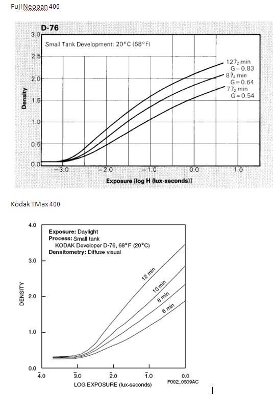

I think I'm going to settle for TMax pushed a little, seems to be as close as I can get.
This sits well with the Fuji and Kodak data sheets as well. If you look at Fuji's tone curve, it has a more abrupt toe and a long shoulder. The abrupt toe means less shadow detail and would explain how some would feel that they get richer blacks.
The shoulder means that the highlights compress a bit, which could be interpreted as highlight 'intensity' and glow.
TMax 400 curve is straight as a nail for the most part, which is why Mark's comment about pushing it makes sense.
My suggestion: Shoot the film at EI 800 (to emphasize the toe and to get those blacks), and develop it longer, but slow down agitation to every two minutes. With a developer like Kodak Xtol 1:1 you would retain the shadow detail, and you might be able to bend TMY-2 to exhibit a bit of a shoulder.
The grain will always be finer with TMY-2, though, but tonally you should be able to get pretty close by doing the above.
- Thomas
