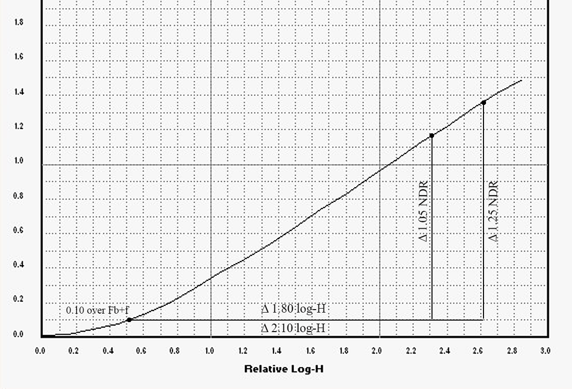

A film's characteristic curve is a graphic depiction of how a given film / developer combination responds to exposure. Exposure is generally done by contacting a step tablet with the film to be tested. This eliminates many potential variables that can obscure the results. Including eliminating flare, making for a flare free test. In order to properly interpret the film curve as it applies to shooting conditions, the elements associated with taking a photograph need to be considered and included.
Below are examples of two ranges of exposure applied to the same film curve: 1.80 log-H and 2.10 log-H. The exposure starts at 0.10 over Fb+f and extends 7 stops (Δ2.10 log-H) to the right. In this example, the resulting negative density is ~1.35 for a NDR of 1.25. While a film curve does not include flare, a photographed a scene with a camera and it's optical system does. Camera flare reduces the effective exposure range at the film plane. A scene with a normal Luminance range has about 1 to 1 1/3 stops flare. One stop of flare will reduce a 7 stop (log 2.10) scene to a 6 stop (log 1.80) scene at the film plane. While the example doesn't accurately represent the way flare affects exposure, it does show the influence. The 7 stop Luminance range becomes a Δ1.80 log-H range. The resulting density would then fall at ~ log 1.15 for a NDR of 1.05. This corresponds to the LER for a grade 2 paper using a diffusion enlarger. All the elements are the identical between the two examples: same scene, same camera, same film and development. The only difference is the interpretation of the data.
Thank you @Stephen Benskin for a very clear demo of how flare affects exposure range at the film plane (also described as "log image luminance"). Camera flare also effects the resulting negative's D-log-E curve in three major ways: (1) it increases the length of the toe, (2) it adds curvature to the lower part of the curve, and (3) it reduces the shadow contrast. The highlights are much less affected. I put together a simple demo (from actual data) of how flare affects the characteristic curve. Here, I apply the concept of flare density (0.02), rather than flare factor (log subject luminance ratio to log image luminance ratio), but it does not change the overall result. In the sensitometry literature both flare concepts have been used. Whether we incorporate flare density in film test analysis is subject to debate. I've seen it done both ways.

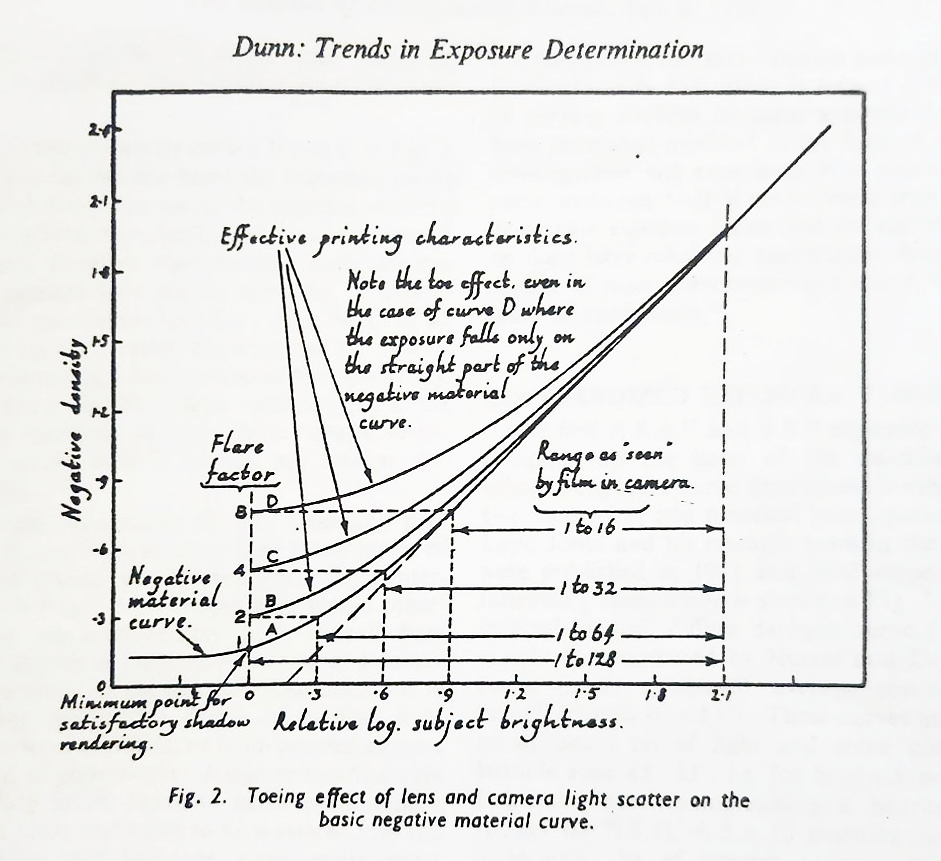

I’ve included an example from a paper by Jack Dunn that I believe clearly shows how the plotting method works. Curve A is the film’s characteristic curve. Curves B – D include progressively increasing degrees of camera flare. To depict flare’s effect, each flare curve locates the density on the film curve that corresponds to the difference in log-H for the flare factor. For example, curve B has a flare factor of 2, or one stop, or a Δ 0.30 log-H. The density at that point to the right on the curve is then projected back to the position of the shadow exposure becoming the new shadow density for a flare factor of 2. The flare curve is then drawn. In the example, a flare factor of 4 uses the density value from Δ 0.60 log-H units to the right and the flare factor of 8 uses the density value from Δ 0.90 log-H units to the right. Also note how the "Range as 'seen' by the camera" is calculated from the point where the dotted lines intersect with the film curve and not from the exposure at relative log 0.
While this is method is quick to plot and straight forward to evaluate, it’s doesn’t represent how flare works. Dunn’s description of “effective printing characteristics” is a good explanation of why the approach is used. It represents the apparent changes caused by flare on the film’s characteristic curve as seen in the printing process, but not actual changes to the film curve. Camera flare does not change the film’s characteristic curve. It only apparently does. The actual cause comes from the camera image’s relationship to the original subject and where it falls on the film curve, and this is where misconceptions can occur with this plotting approach. Don't get me wrong, this does not invalidate the method. It remains an effective evaluation method.

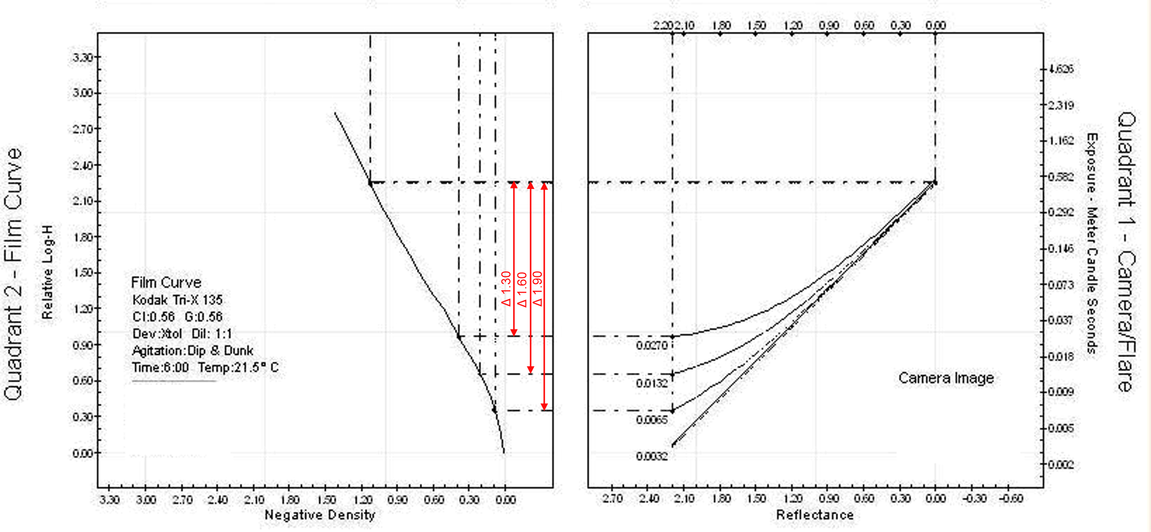

A film’s characteristic curve is a graphic depiction of how the film responds to varying degrees of exposure when the film is processed under certain conditions. It is basically fixed and unchanging under those conditions. Any value of exposure will always produce the same amount of density. Any change in exposure only shifts its position along the X-axis to the corresponding density for that exposure. One stop of camera flare will double the shadow exposure, which moves its position 0.30 log-H units to the right of its original position. The change in density comes from the exposure falling on a different part of the film curve. It doesn't change the curve itself.

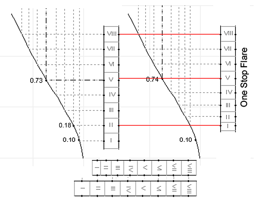

How one, two, and three stops of flare actually work on the characteristic curve. Interesting fact. Without flare, normal shadow exposure will fall approximately one stop below the 0.10 fixed density speed point to where the fractional gradient speed point is. Which means that even if the degree of flare is less than average, the exposure for an average scene will still produce a good negative.
Camera flare affects the shadows proportionately more than the mid-tones and highlights. It compresses the shadow’s illuminance range which can appear to have the same resulting prints as a film with different toe characteristics.

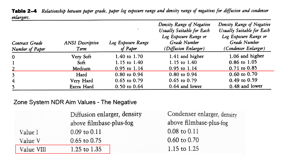

Actually, I was defining a resolution to the apparent discrepancy between the aim NDR between Zone System testing and that indicated by tone reproduction. I did state that the example did not accurate represent how flare effects exposure. The example was used to illustrate the effective log-H range and resulting NDR.
The top table is from Photographic Materials and Processes. The bottom set of data is from The Negative.
What I was illustrating is the discrepancy is due to a misconception interpreting the data, ie flare vs non-flare. The problem comes from the assumption that since Zone System testing is done with a camera, it contains flare. My example shows applying the same luminance range from Zone System testing to a flare free test (film curve) will result in the same aim NDR from Zone System testing which indicates Zone System testing in a camera is essentially flare free. Since the OP indicated he wants to do more advanced negative testing, I thought it important to emphasis good testing methodology and to be alert to possible testing errors and misconceptions.

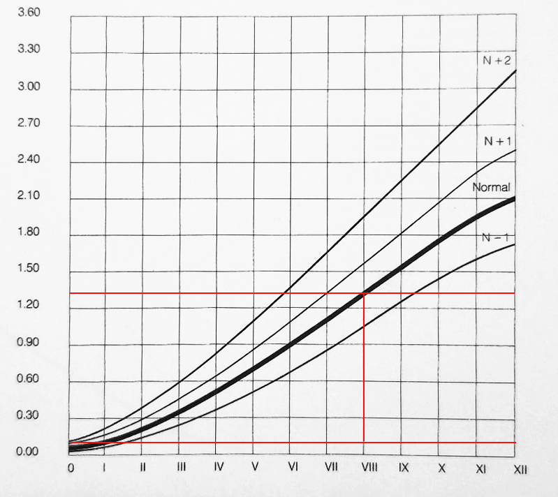

Below is from Appendix 2: Film Test Data in The Negative. I've added the red lines. Zone I to Zone VIII, NDR 1.25 or the same results from my example. It's interesting to note the book states the testing in this section eliminates the K-factor in the calculation of the EIs. Another example of a misconception.

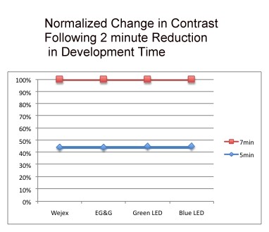

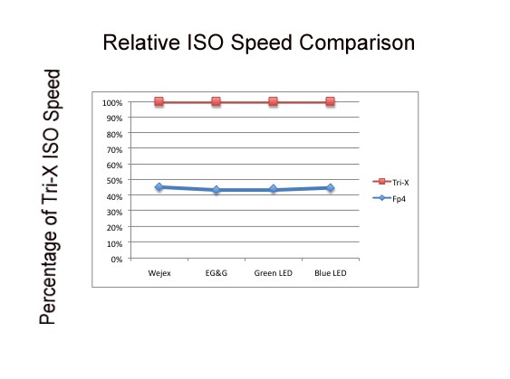

Those are great for B&W process control and testing development. The color of the exposure did not influence the film's response to development time chanages when I compared 4 sensitometers with different lamps. Likely no development parameter would be altered significantly by the exposure color.
Also comparative film testing with the caveat that both films would be know to have similar sensitivities to the lamp color. For example FP4 was about 45% slower than Trix, irrespective of sensitometer exposure time or lamp color.
Since those tests I have obtained a sensitometer with a electroluminescent light source, but have no reason to think it would produce results any different than the other 4.
Wejex = 1 second incandescent exposure
EG&G = 1/100 xenon flash exposure
Green and Blue LED = about 0.5 second exposure
