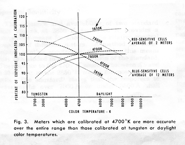

You're asking good questions and doing some critical thinking concerning the various popular testing methodologies. This is more than most people do. Don't ever stop. First off, contacting is the only way to eliminate flare from testing. Flare can be factored in later for determining shooting conditions, but it's impossible to control and will introduce a factor into the test that will skew the results. Any method that uses an optical system between the step tablet and film will introduce flare. Even if the step tablet is carefully masked, the less dense sections will create veiling flare affecting the shadows.
The color temperature of the light source does have an influence on testing results. The 1960 speed standard had to make a small change in the speed equation to compensate for a change in the color temperature of sensitometers from sunlight to daylight. The additional blue added 1/3 stop to the film speed. That's why the constant is 0.80 instead of 1.0. For the DIY testers, an additional factor to consider is the exposure meters. They are calibrated to a specific color temperature. Based on the type of photo cell used and it's spectral bias, the accuracy of the meter will vary based on how far from the calibrated color temperature the color temperature of the light source falls. While these facts are important to maintain a realistic perception of the level of precision possible, there are so many other variables and potential experimental errors influencing the results to worry too much about the color temperature as long as the color temperature is similar to that experienced in normal shooting conditions.
What is perhaps most important is something you didn't mention and that is the accuracy of the method used to determine film speed and development. Most common methodologies make certain assumptions that may or may not be correct or that may work under some circumstances but not others. Many of the techniques assume the speed point is four stops down from the metered exposure point. This does not conform to the ISO standard. What you have is two different testing parameters that will produce different results. While neither may have a negative affect on quality, it does bring into question the accuracy of any one method. The ISO speed point is effectively 3 1/3 stops below the metered exposure point (as a point that many assume differently). This creates an obvious discrepancy of 2/3 stop between the Zone System four stop approach and the ISO method. Along with all the other variables and experimental errors that can influence the speed test, it's better to not test for speed and to assume the ISO speed when using a general developer and either make an adjustment for the Zone System speed or test your personal metering approach in the field and make adjustments then. Ask yourself what does exposing a white piece of paper at Zone X actual produce in the way of exposure. Any method will produce a result but is it the correct one?

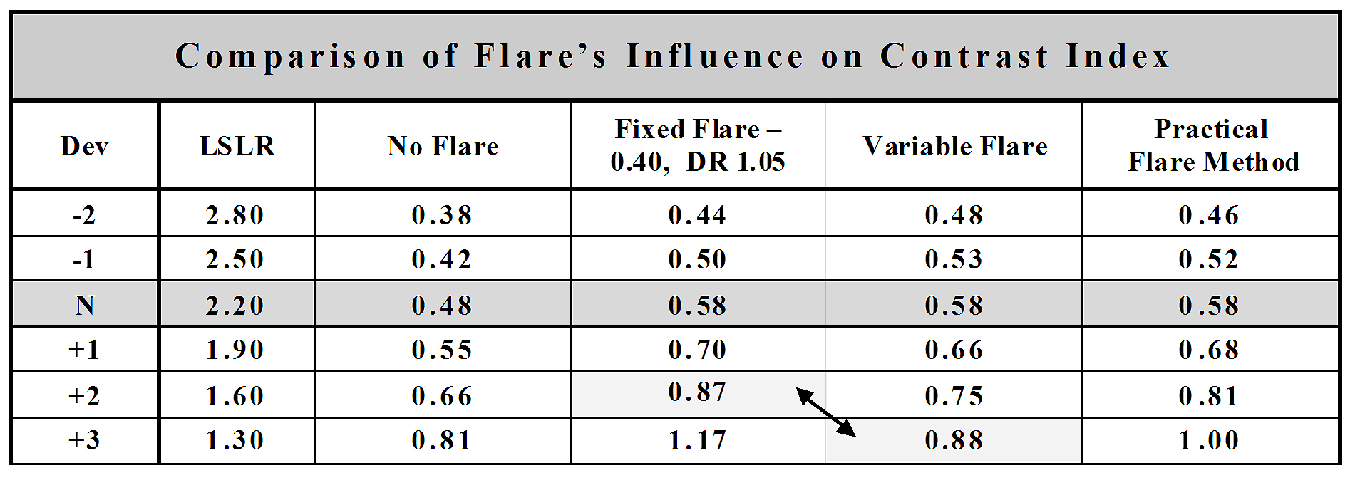

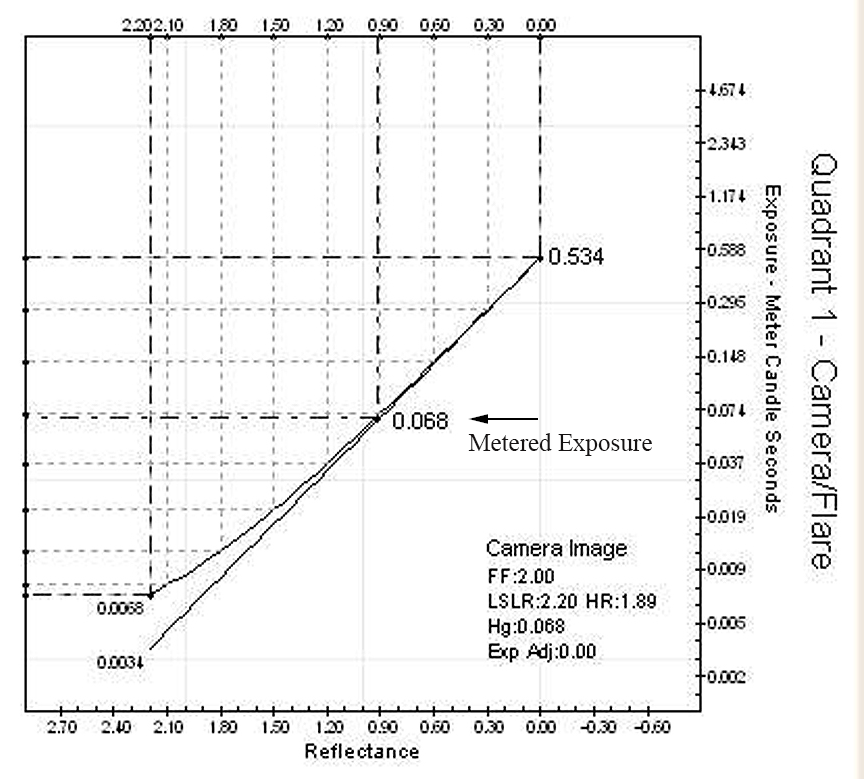

You shouldn't make the assumption shooting conditions and testing conditions are the same and that they will yield the same results.
How does flare work?
What are the ZS testing conditions?
What influence would flare have under the ZS testing conditions?

I'm not making that mistake at all....I was hoping you would provide a quick answer to my question. If flare is not accounted for in testing like you say, okay, you're the resident expert and I recognize your standing on the subject, I can't really argue against it. You seem to make alot of it. I can opine that it's influence, then, has seemed, at least from my own experience, not to be much of an influence at all in what I've been able to do......I can equally opine that my "testing" as described by Schaefer in his Book 2, sure had improved the quality of my negatives ten fold. I have no problem encouraging the OP to engage in that method and not get too wrapped up in all these weeds.
Average camera flare is based on a subject with the statistically average Luminance range. The highlights create a veiling exposure that has a proportionately greater affect on the shadow exposure. A flare factor of 2 means the value of flare is equal to the shadow exposure thus doubling it, as well as reducing the effective Illuminance range. Zone System testing uses a single tone target. There isn't a highlight to produce the flare exposure or a shadow to be affected by it. The target is generally middle gray which is only slightly affected by camera flare even when there is normal flare. As the subject Luminance range is only a single value, practically no flare exists in Zone System testing and if any does exist, it has minimal influence on the results.

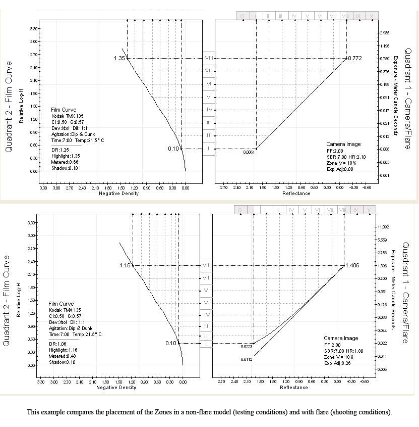

@Chuck_P you asked “Does Zone System testing include flare because it was taken through the same camera and lens that you will use in the end?”
Traditional Zone System testing where you photograph an evenly-lit gray card four stops down creates a low flare situation.
Other test schemes have been devised, so if you mean something else, it might have flare. Taping a step wedge to a window and photographing has a lot of flare. Taping the step wedge to the film in the holder doesn’t have flare.

The highlights create a veiling exposure that has a proportionately greater affect on the shadow exposure...............................There isn't a highlight to produce the flare exposure or a shadow to be affected by it.
I don't know if this is 100% correct, honestly, it doesn't matter but this response does makes sense to me and I see more of the issue regarding your claim that flare is not accounted for in ZS testing procedures, thank you. AA indicates that flare is accounted for in the testing he advocated for in The Negative, who was I all those years ago to argue against that, especially when my own negatives improved greatly. If old AA was wrong as wrong can be on that, so be it....................I'm mainly interested in results and testing in that way has paid dividends imo.

Zone I to Zone VIII is 7 stops or a log Luminance range of 2.10. The aim Zone NDR is 1.25. This would make the film's average gradient (Rise/Run) 1.25 / 2.21 = 0.59. The CI for normal development according to Kodak is 0.58. Essentially identical. However, if you plug in the 1.05 or the paper LER with the 2.20 of the log subject Luminance range, you get 1.05/2.20 = 0.48 and not 0.58. Kodak also incorporates a value for camera flare. In this case it's 0.40. 1.05 / (2.20 - 0.40) = 0.58. Camera flare effectively reduces the luminance range down to 1.80.
If normal negatives from both approaches have identical average gradients, then the only difference between the two is that one is more accurately describing reality. Just like the difference between the geocentric and heliocentric model.
Here it is graphically. Both use the same luminance range and the same film curve. The one without flare has a NDR of 1.25. The one that incorporates flare has a NDR of 1.05 which matches a paper's grade 2 LER.
