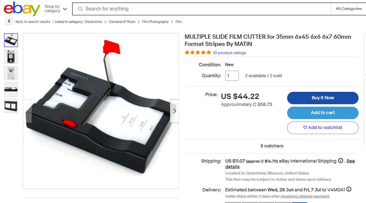

For cutting film I use one of these on top of a light pad: https://www.ebay.ca/itm/19532117888...=2047675&ssuid=&widget_ver=artemis&media=COPY
The film advance wheel isn't effective any more (after several years of use) but that isn't really necessary, and all the rest of it works really well.

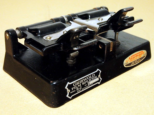

I use an old 35mm film splicer to cut the negatives.
Griswold Film Splicer R-2 by Bryan Chernick, on Flickr
Is there a line of mark on this cutter that allows an exact same cut each time Matt? I have a very similar slide film cutter but even then I find that the gap between 35mm negs is so narrow that getting every cut exactly in the middle of the gap is difficult
Extreme care and patience is required.
pentaxuser
For particularly narrow gaps, I mark by eye the edge of one, then the edge of the other, then move the film half of the distance.
For most negatives, that isn't necessary.
The biggest challenge is identifying the gap between two dark transparencies.
