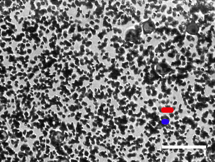

This is I believe exposed and developed FP4, which is the under a microscope. (the OPs film)
The white scale is 20um, the blue line is roughly 6µm which is about 4000dpi (coolscan etc) and the blue is about 3µm, which is 8000dpi. I forgot to add a line for my epson flatbed which shows grain very well... it would be at least twice the size of the red line. :smile: As final bit of useless trivia the aperture size used by Kodak to measure graininess is 48µm across (2.5 times the length of the scale line)
The practical point of all this, that scanning like a pure optical enlargement is not perfect. And the various digital operations, the sampling, the re-sampling, and attempts to sharpen by identifying edges or using other techniques can make the apparent grain at least different to a traditional optical enlargement.
I am interested in techniques that minimise these effects in scanning. Often people will say things like 'a good scan is down to a good operator..."
