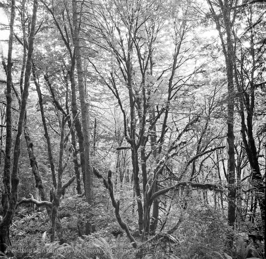

Definitely not. Assuming your negs are with good exposure wise, FP4+ scans just fine... let me dig up some examples...
Sorry, not an inspiring image or anything. I mostly shoot Tri-X on B&W but I know I shot some FP4+ last year. Unfortunately, I don't mark the film type on the neg sleeves so I just rummaged and found this. I haven't even scanned it in since it's not that great, but at least this serves as an example. This is done on a Flextight but I have used and owned MANY scanners and they should all scan decently.

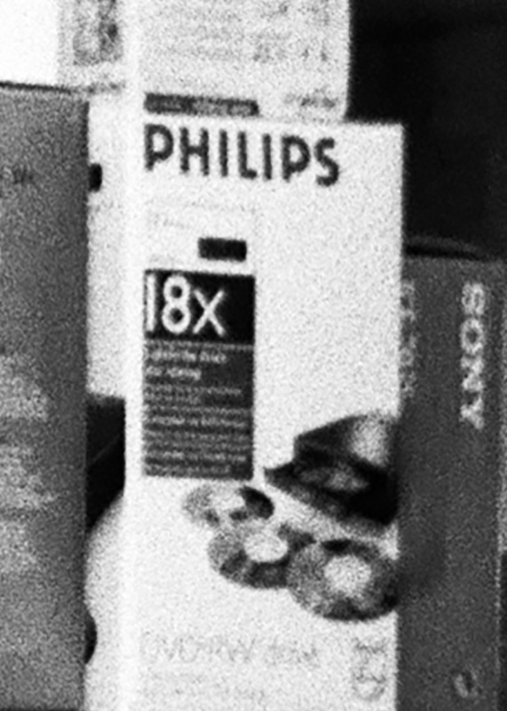

I know little about scanning B&W negatives; that's why i Had my FP4+ negs scanned by a pro-shop but, the results where horrid(grainy). Is that normal?
You should show us some examples first.

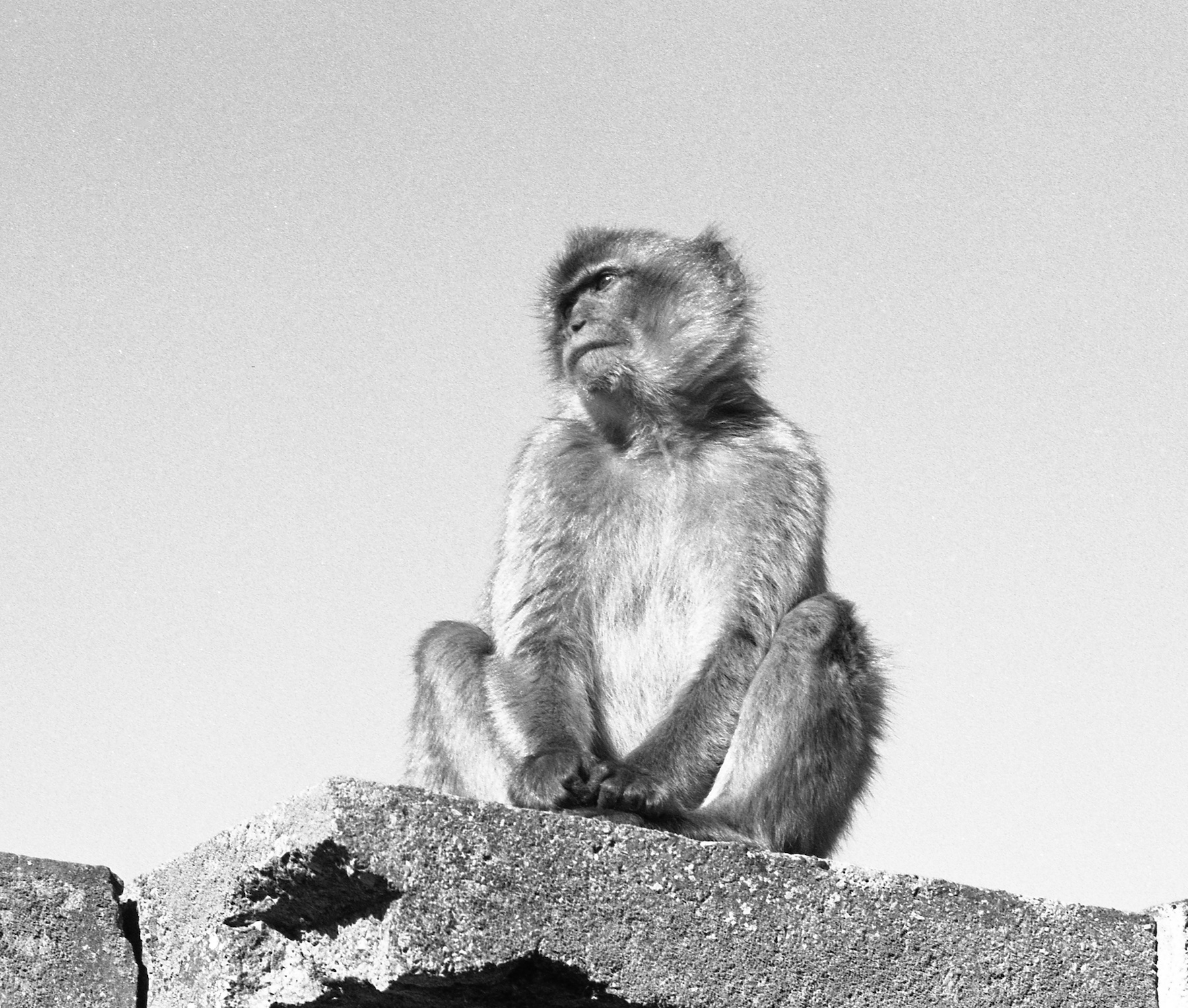

This is an FP4+ scan, 35mm. You can see the grain but personally I don't think it's a problem. I used this scan as an example as it contains a lot of (blue, cloudless) sky. (this picture would look better with some of the superfluous sky at the top cropped out).
this looks fine;I'd be happy with that.

I'm not aware of the detailed technical details but gave the negs to another lab to get them scanned again.They are using an Imacon scanner;We'll see how this turns out.
I use a Pakon for fast/bulk scan and the Flextight for high quality scan. The image I show is from Flextight since it's medium format and the Pakon only does 35mm. In any case, the FT obviously produces much more detailed scans with higher dynamic range but even on 35mm, the Pakon's scans hold up quite well against FT. In other words, if your negs print well enough, I think it was an operator error if the scans you got is too grainy.
Do you have a similar size crop made scanned from a print?
for what purpose?
SInce you have problems uploading, and sending a crop of unknown size, I am offering to help to see if I can diagnose the problems, but never mind.
I would first ask the lab this simple question,,,, Did they use sharpening when scanning and wait for the response... for all good quality work the sharpening should be turned off ... I have a Imocan and input sharpening at the scan stage is the kiss of death...
