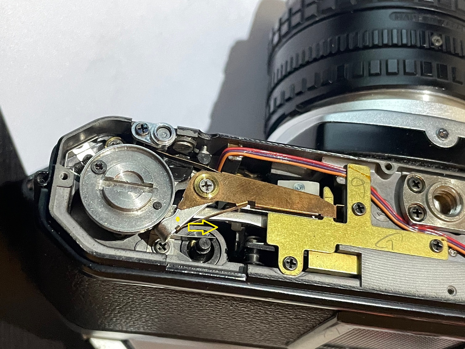

In the picture below, the lever with the yellow dot should be moved gently in the direction of the arrow until you're able to cock the camera and press the shutter button. These mechanisms vary between madels and production dates but are similar in function. You may have to it a few times and it may be all you need. There are three lubricating points in that system that the nikon service manual recommends to to lube. This is why it helps to dry shoot the camera at least once a month or so it doesn't get arthritis if you know what i mean.
This would be done at your own risk so be gentle with it and don't force anything. Or, you can have it CLA'd at your local camera shop.

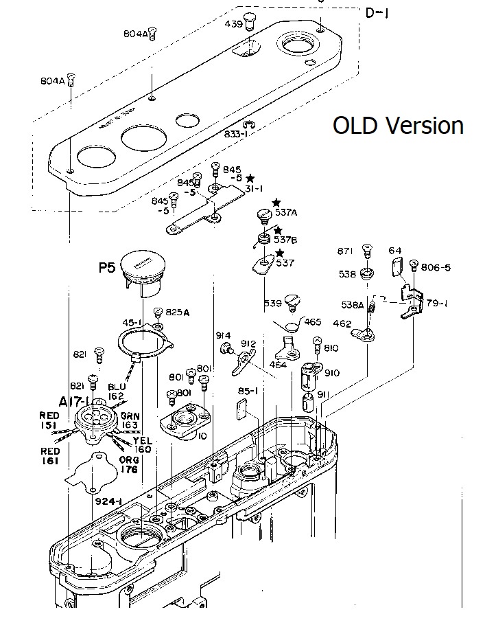

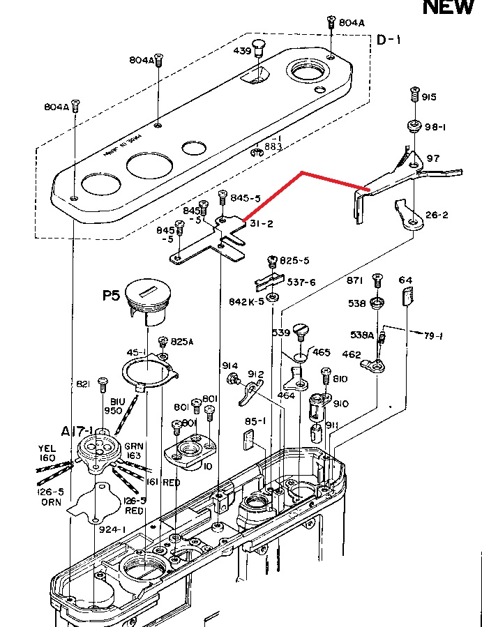

It would be interesting if you could list the distinguishing features of the three different FM versions, and which ones have which mechanism. I know that the early ones have the shutter lock collar, while the later ones lose this but add a screw in the mirror box that can be used to remove the focusing screen without taking the top plate off, but that's about it. I'd also noticed that there are at least two markedly different versions of the FE mechanism when viewed with the bottom plate off - are there corresponding differences in the FM mechanism between versions?
which view do you need?
View attachment 290697 View attachment 290698 View attachment 290695 View attachment 290696
You pretty much got it covered here. I have a type I that took the top plate to clean the focusing screen but it had the dreaded dark vertical line in the viewfinder from a defect in the prism. I also have a type III that has the center screw but its still not as easy as the FE or FE2's clip on screens. Also type one has a different film advance mechanism than the Type ll or III. Here's a good explanation from riversky33
Thanks! I think I have the external differences clear now. I & II both have the shutter lock/winder mode collar and lack the focus screen screw. They differ only in the largely cosmetic knurling on the rewind knob, which only type I has. Type III loses the shutter lock collar, but gains the focus screen screw. You suggest that the film advance mechanism change happened when type I was updated to II, though I might have guessed it would have happened when II was updated to III, at the same time as the other major external changes. But perhaps II was a transitional version, where removing the rewind knob knurling coincided with the first significant internal change to the mechanism?

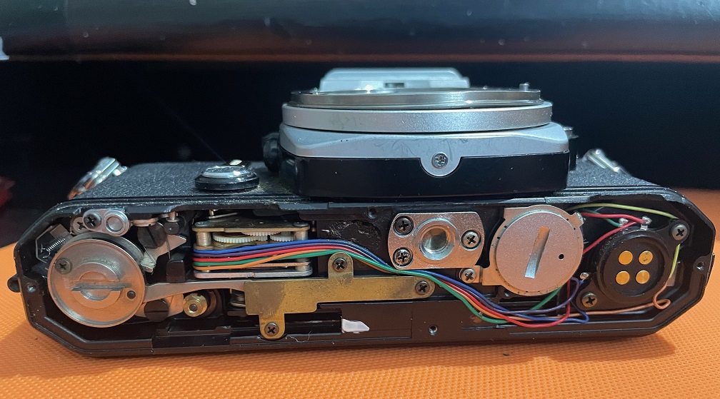

It would be interesting to see under the bottom plate for versions I, II and III, if those views are available.
Interested in this, as i have a fe that is the old version that is locked up in a similar way. Mine happened at the end of a roll with a md12 attacted.
Here's the bottom of my Type II so the newer improved mechanism started with the Type III
