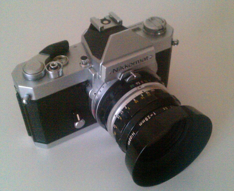

Here's the $15 FT2 that I bought: ebay item # 391381364714 You should be able to find that in their search field. Looks pretty enough, I'm hoping it works. I figured the gamble is worth $15! The one I paid $65 for with Nikkor 55 3.5 lens looks much worse but works perfectly including an accurate meter (checked it a day ago against my Sekonic). Then again, pretty cosmetics doesn't mean it works..
Here's the one I am currently using, as mentioned. I had to clean it up - it was very dusty and the inside was covered with the disintegrated foam seal flakes. But an hour of work and an $8 seal kit and it is very nice.
Wow - just saw the $15 one - looks great. I like the black one. KEH currently has a nice black one, too.
These things are bargains going for little money!
It arrived today.Crazy good shape, funny thing is the mirror was locked up. I guess they thought it was broken, and did not know about the mirror lock up lever.
Meter works, no corrosion, needs to be cleaned up as they all do. I'll just spend some quality time with it and some 92% isopropyl alcohol...

Finally got my seal kit, put it in, slapped on a new (to me!) lens. My $15 cocktail I mean camera..
