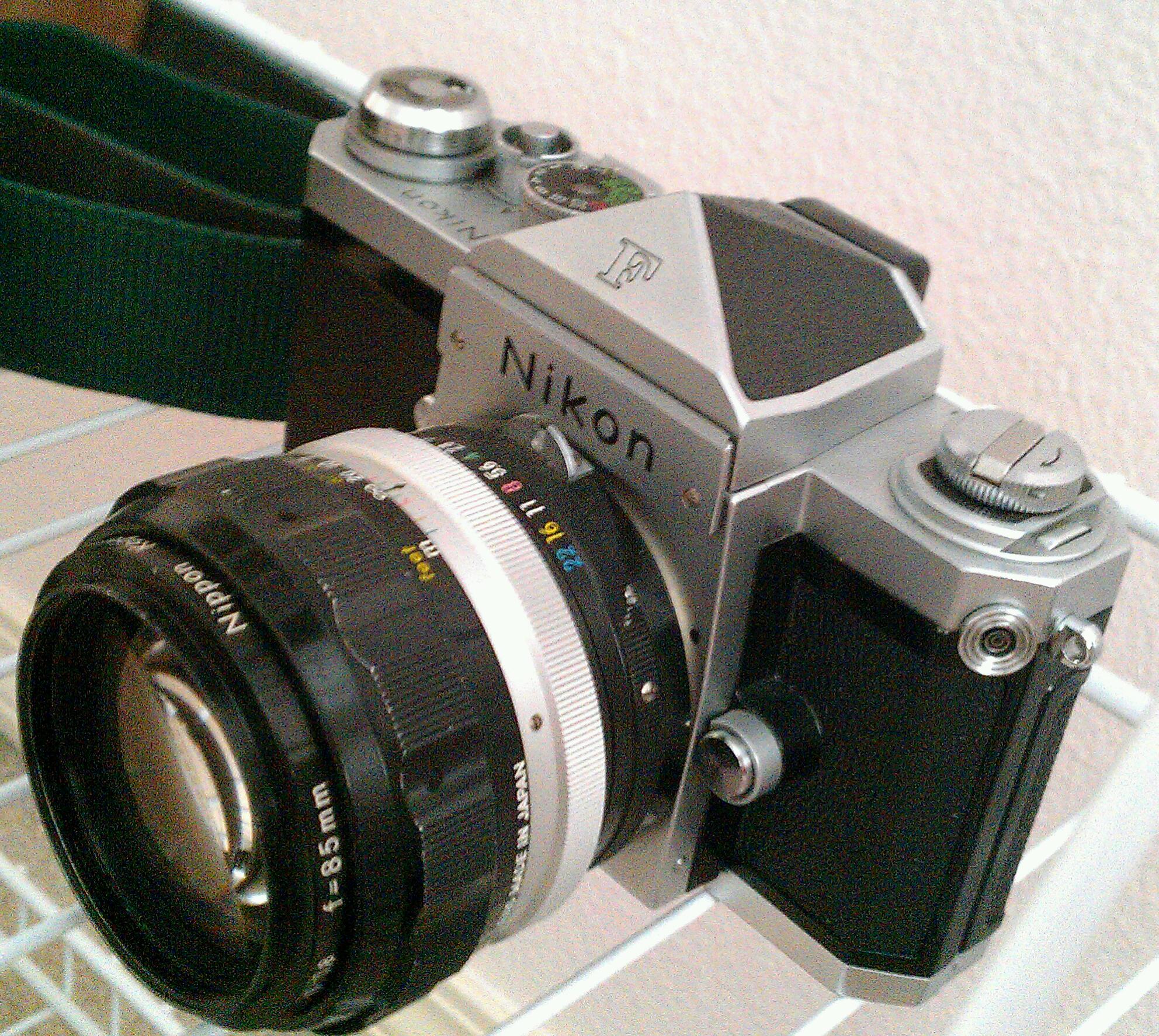

Newer version of this?
In the description on Flicker it says K 85mm /1.8.
The K series were Pre-AI with rubber focusing rings and aesthetics closer to AI lenses.
Thanks. Good to know. I cannot see things on Flicker.
Hmmm, photos are public on my flickr account. So, unless your computer is blocking the IP address for the flickr site, it should've gone through.
But, yes, it's a K-type 85/1.8 with factory AI ring. Currently have it hanging off the front of my F4s.
Most K-type Nikkors are identical to the AI lenses, except for the rubber focusing ring composition (harder rubber on the K-type that's blacker), the aperture ring, and lack of a lens speed tab on the rear element baffle. The 85/1.8 was never available as an AI lens. At least, as a true AI lens. Some late copies were sold with the AI conversion rings installed at the factory before the 85/2 AI was available, though.
