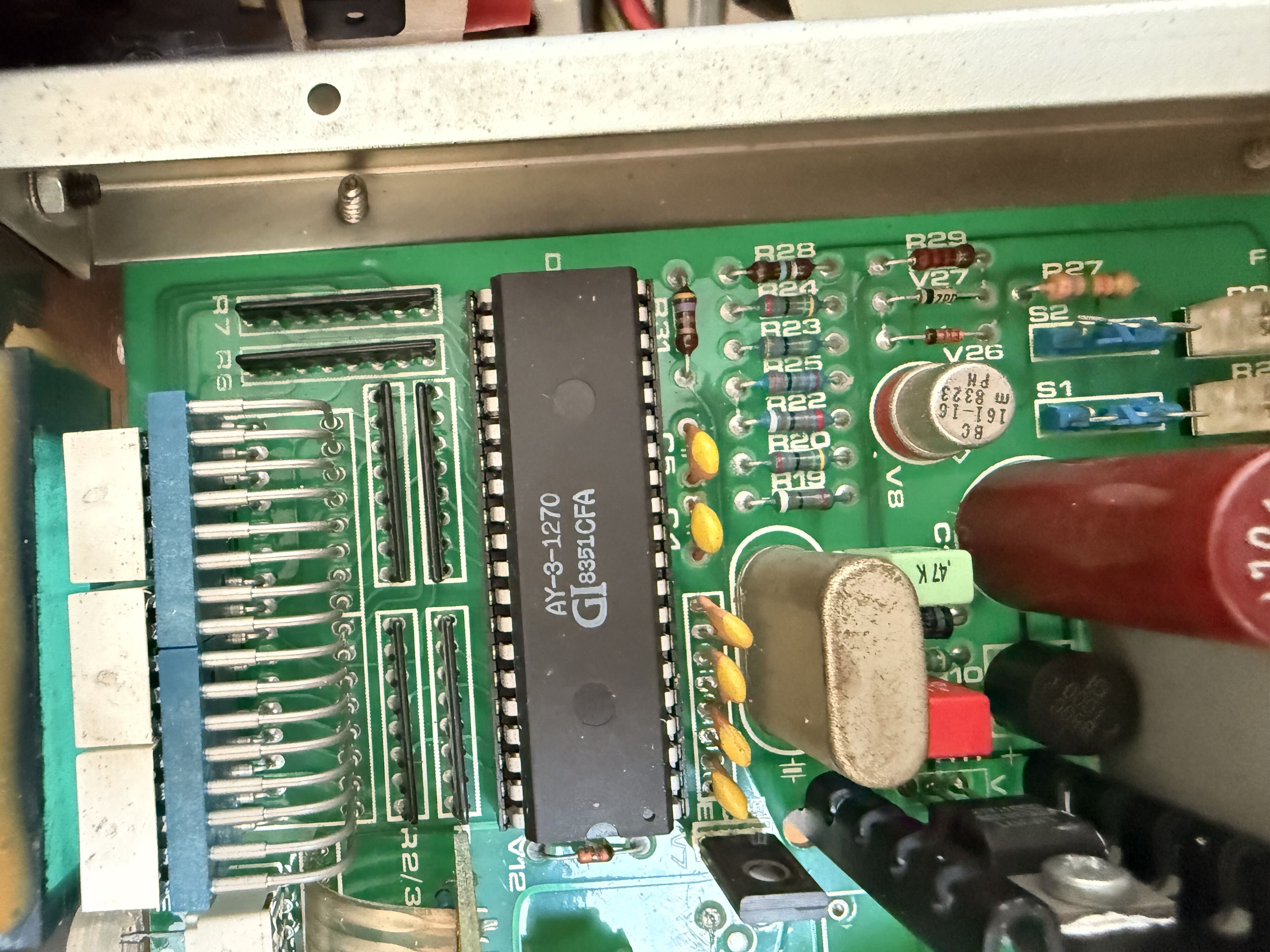

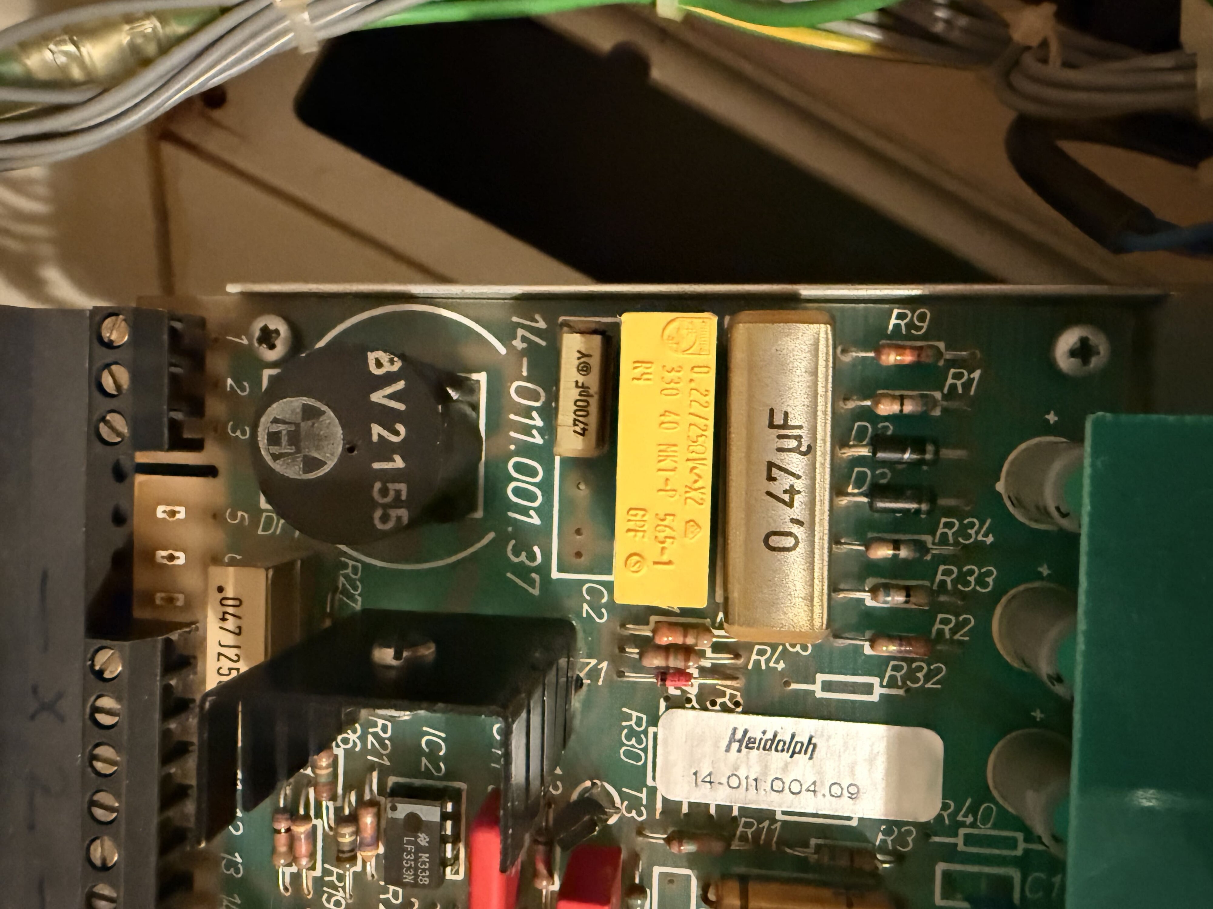

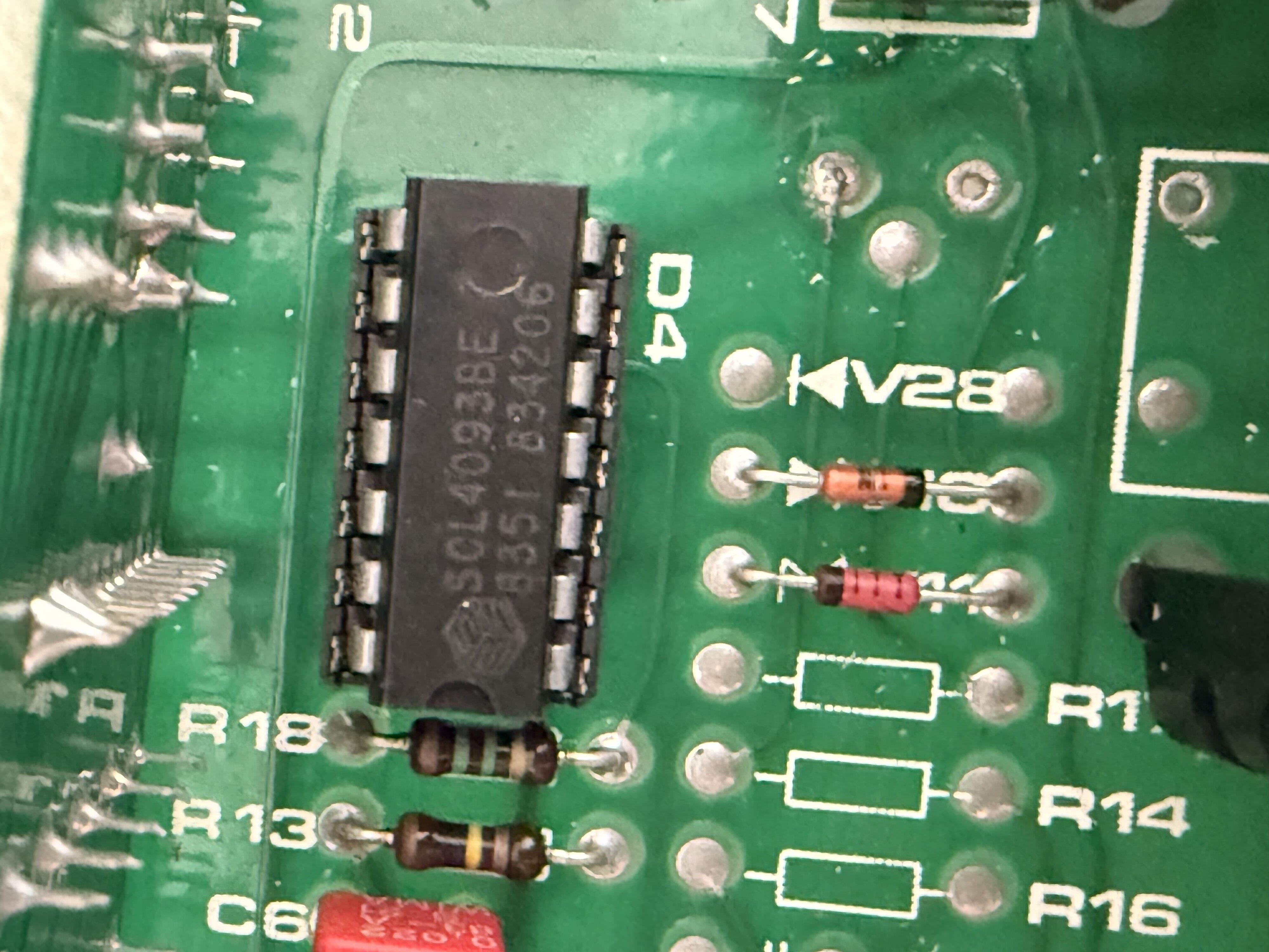

Hi There, i may need some help, i newly purchased a metoform 5040, unfortunately the LED is not working anymore, but the thermostat and roller are working! Is there a way that i can test which capacitor need to be changed?.
I can post some pictures about the main core chip here. I ve changed the 4700nf capacitor also the phototransistor. But still the LED is not working. You can find me in wx: Thecameraguy for a direct chat.

Welcome to Photrio @Luki !
It's unclear/uncertain and not necessarily very likely that a failed capacitor is the cause of a LED not working anymore.
What is this LED supposed to do? When should it light up?
Photo 1 is likely part of the low-voltage logic DC power supply and some filtering on the AC side; the round object top left of the photo is a bridge rectifier; there's likely a voltage regulator just below it (the one with the heatsink). If the machine mostly works OK then this section is likely just fine.
Photo 2 is what looks like a 8051-series microcontroller to me, which is the central 'brain' of the machine. Again, if the machine works fine for the most part, this chip and its directly associated circuitry is likely OK
Photo 3 shows a 4-port NAND chip; its specific function here is unclear.
None of this is directly usable in tracking down this specific defect. What is needed is a set of electrical schematics of the machine; on that basis and your fault description it may be possible to formulate a couple of hypotheses of what might be wrong, then you can do some selective tests/measurements to eliminate these one by one.
Which one? Did it help/make a difference?
the phototransistor
Again, which one, where is it in the circuit and how does it relate to the LED?
Anyway, a schematic would be very helpful. Otherwise it'll be a matter of doing measurements around the LED and then seeing if the problem can be traced back, but lacking a schematic, it can be a lot of work and it requires some basic knowledge of electronics as well as a good deal of patience, and possibly partial disassembly of the machine so you can trace tracks also on the backside of the PCBs.

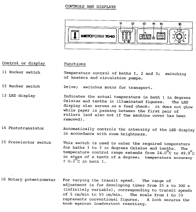

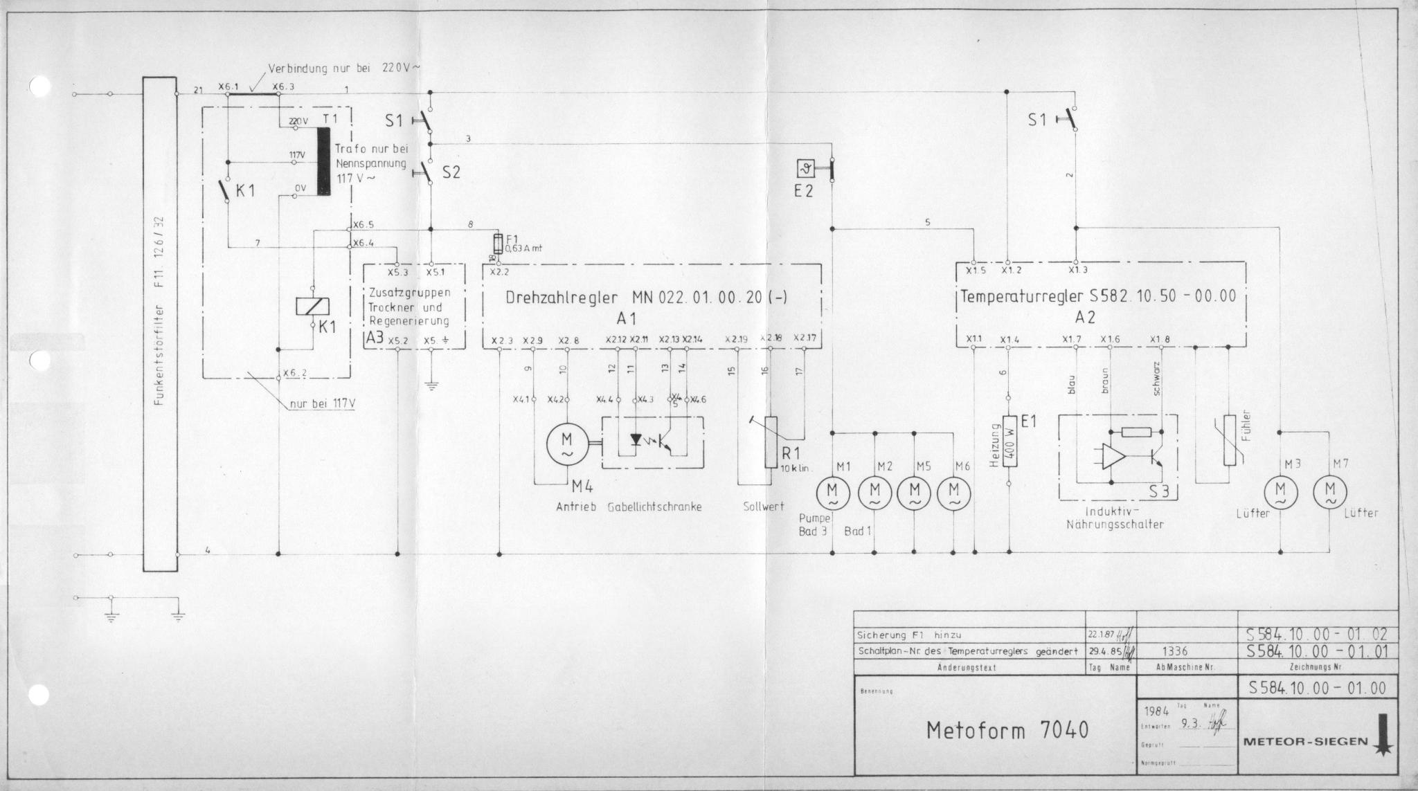

Okay, I've received some documentation on the probably closely related Metoform 7040. Here's a bit that's interesting:
It shows no single indicator LED as such; only a 7-segment LED display. Note that it's designed to not light up if paper is passing through the first set of rollers and also not if the cover is open. So if your issue is related to this numerical display, try it with the cover closed and see if it comes on.
I did not receive any detailed schematics of the actual modules; only a high-level block schematic; again this is for the 7040, but I assume the 5040 is similar or even identical:
