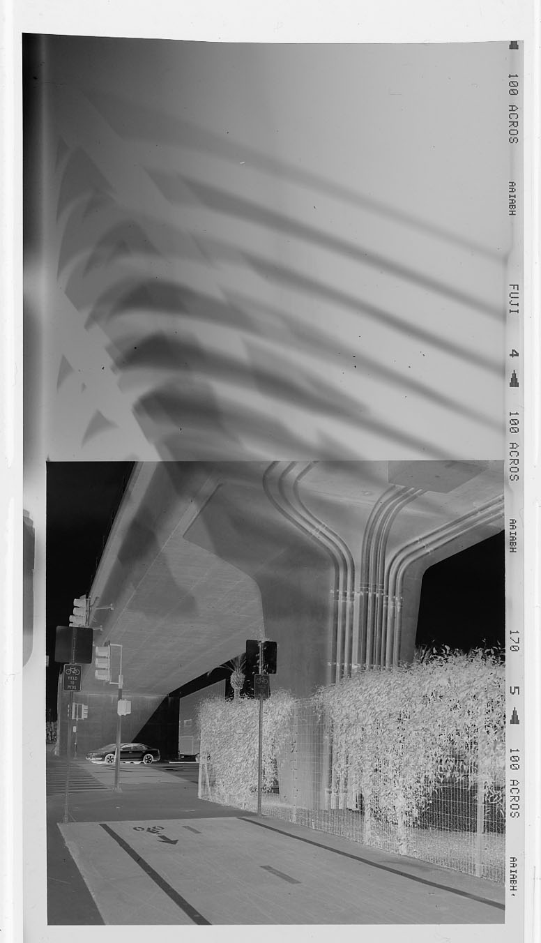

Here is an example of a light leak in a Jobo tank caused by the lid not being seated properly at first when the lights were turned on. Looks like yours.

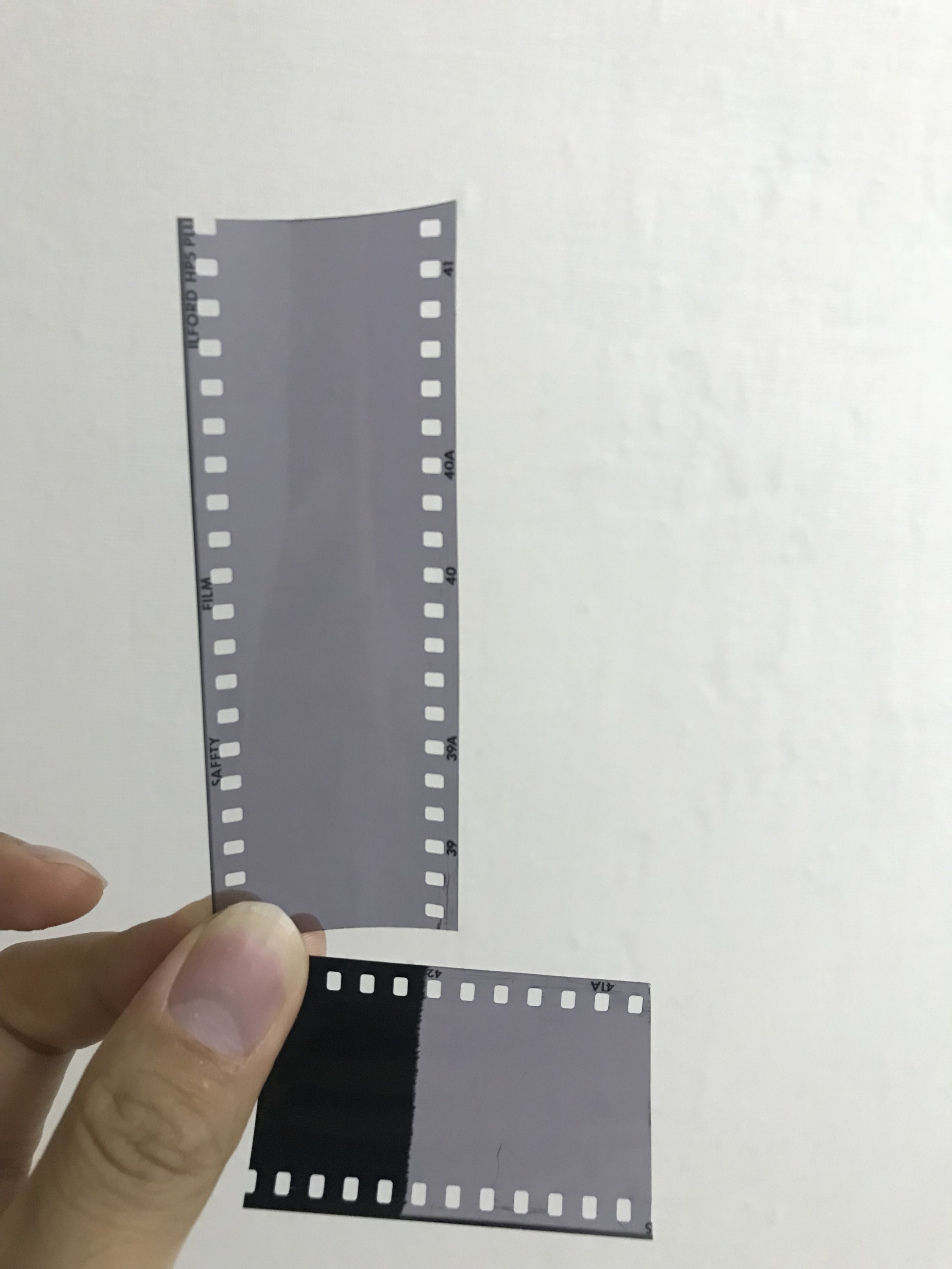

I'll try a piece of bulk film so that to ensure that there is no leak for the tank.

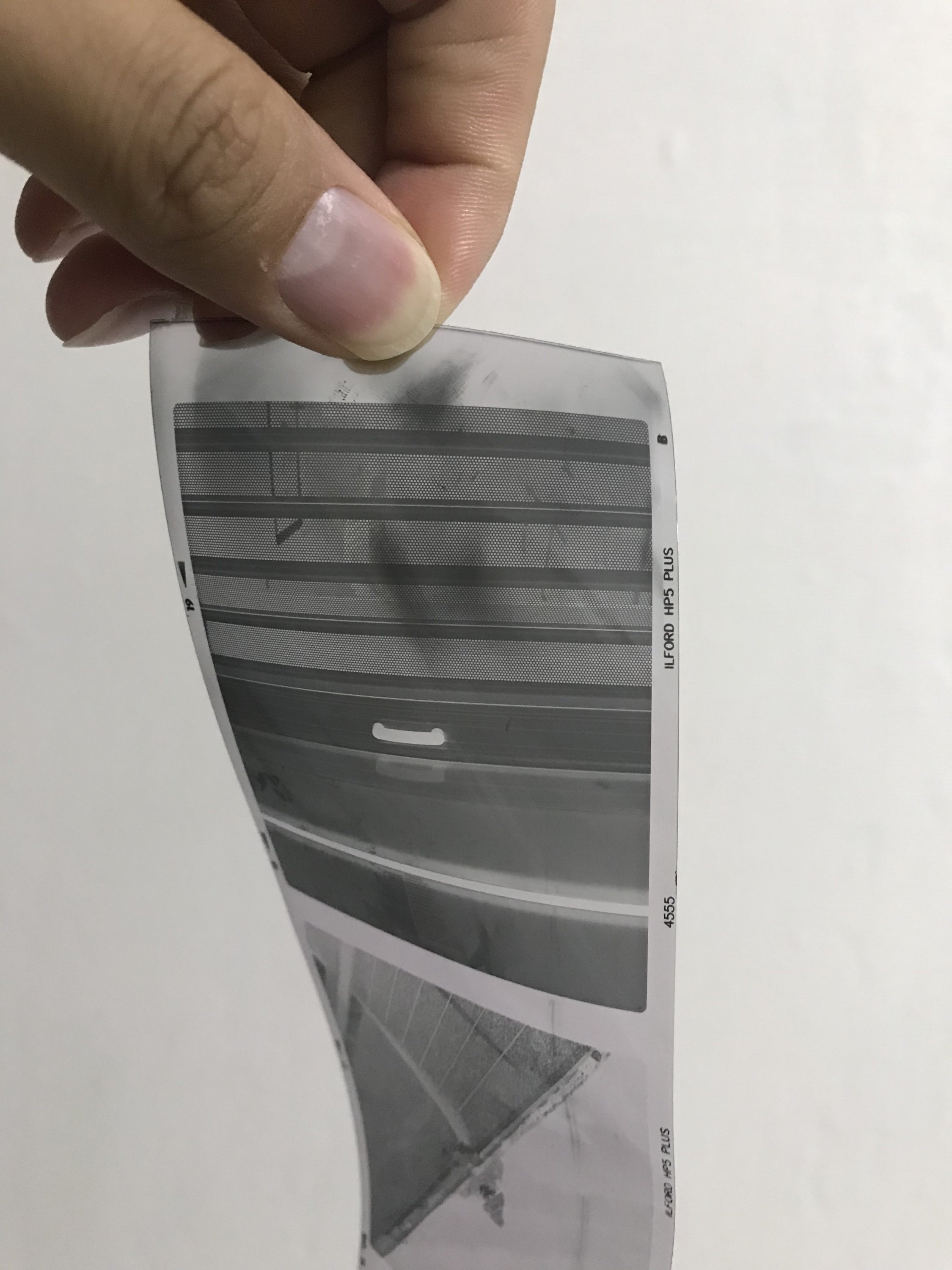

The marks on your film in the first post are the shadows of the spiral, caused by a light leak. I really doubt agitation would give such distinct marks. I agitate by inverting the tank 180Âş and at the same time rotating it along its vertical axis and then returning it to its original position, rotating in the opposite direction. The whole maneuver takes a bit over 1 second. I agitate for 10 seconds at the start of every minute of development time.

You are using a large tank or a small one? Because multitank is really big, when I revert it, it gave strong wave.
Here is the result.
I charge the film in my changebag directly.
7 min D76 stock with pouring time.
I just kick the tank on the ground several times (in this case, I heard waves tapping the wall of the tank) and the black side bars appeared.

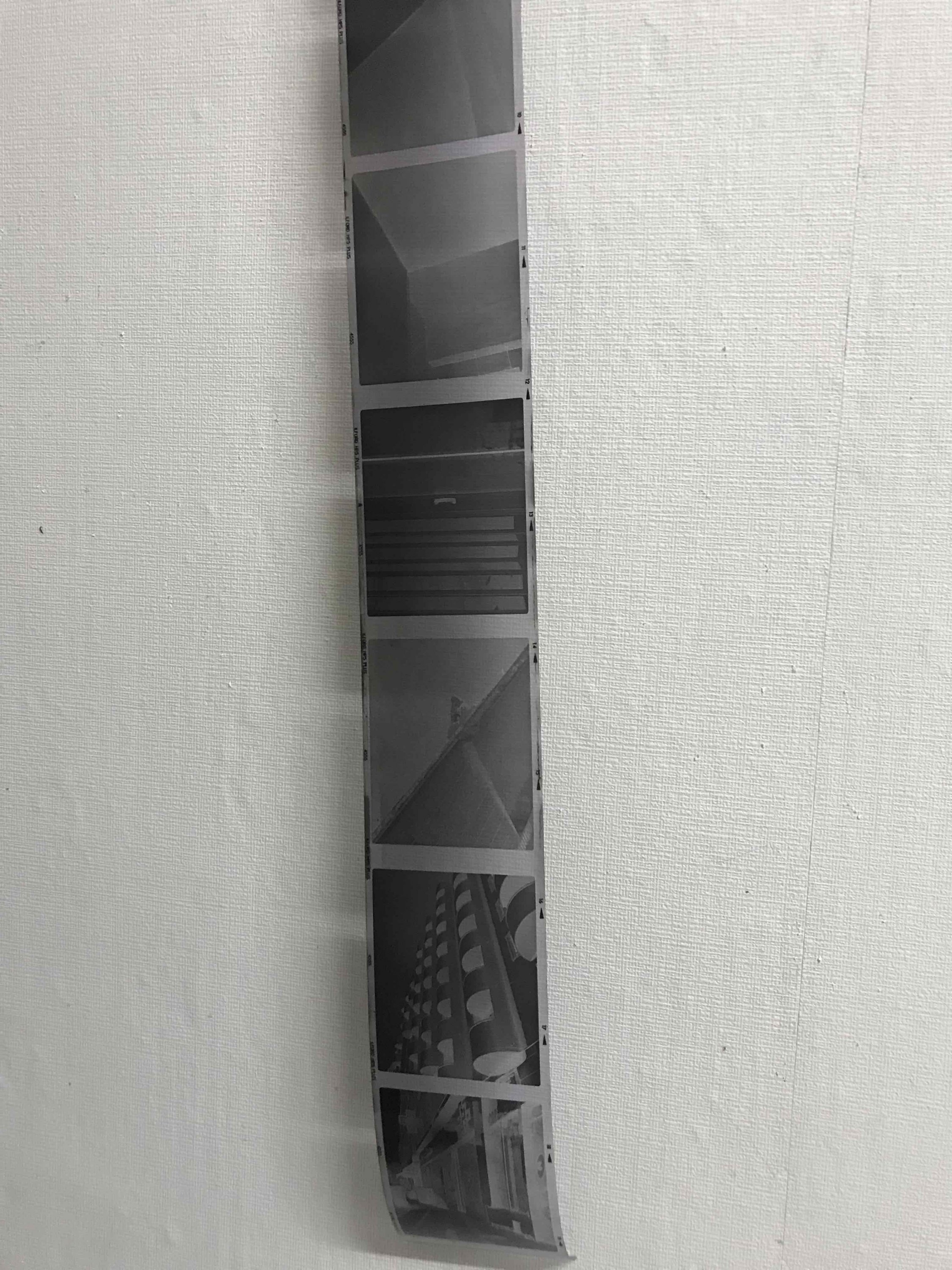

BTW, Yesterday I developed a roll of delta 400(120) in Inox tank charged with the same changing bag. Inverting process, no problem with that roll. The result I posted in #7 img_4769.

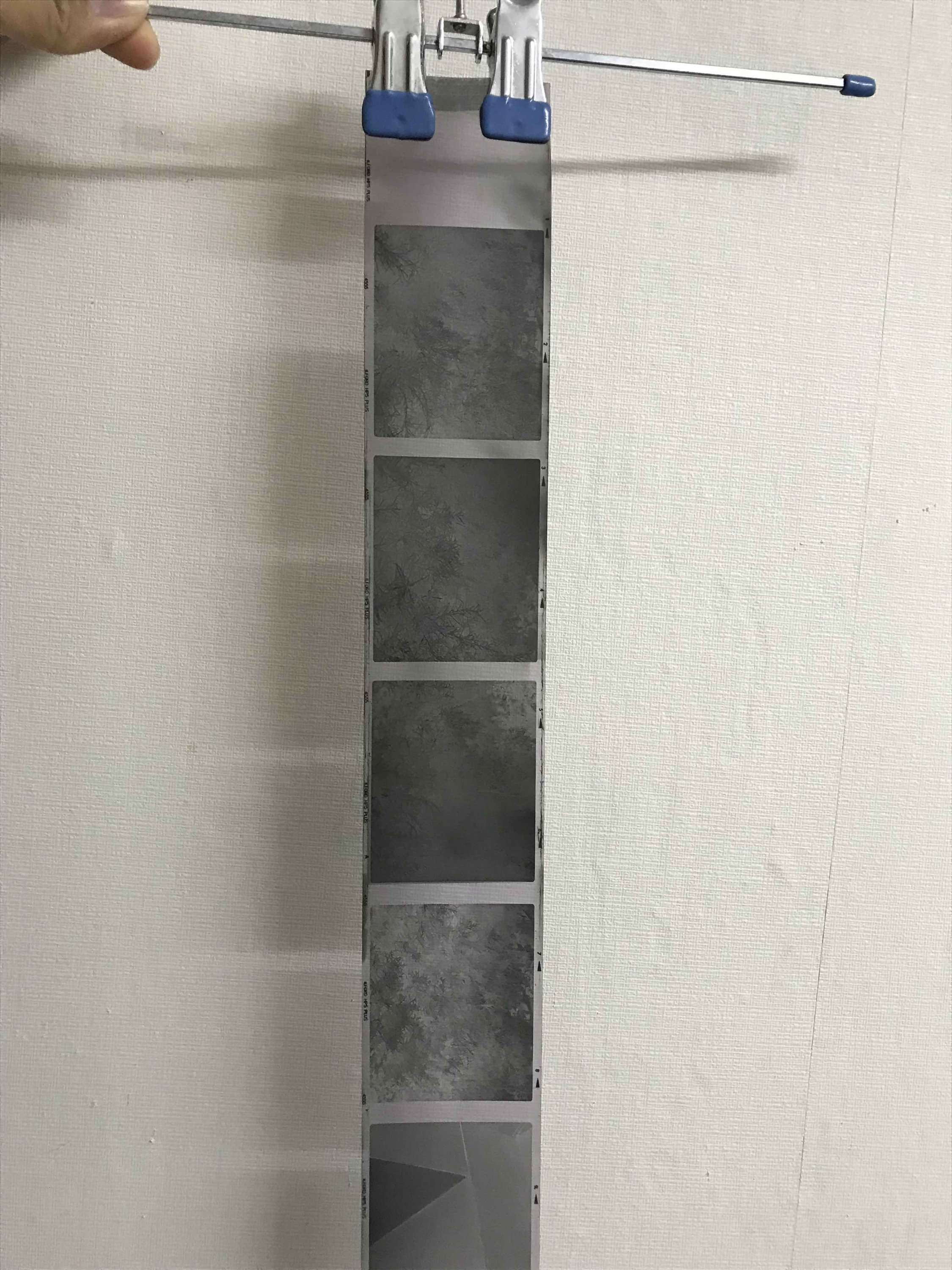

This roll I developed tonight in small AP tank.
D76 stock 1+1 14 mins.
Every mins 4 turns clockwise and 4 turns counterclockwise.
Everything is correct except the end. I think it's a big movement for the tail which is not blocked and then slashed by the chemistry left and right. And the sign appeared.

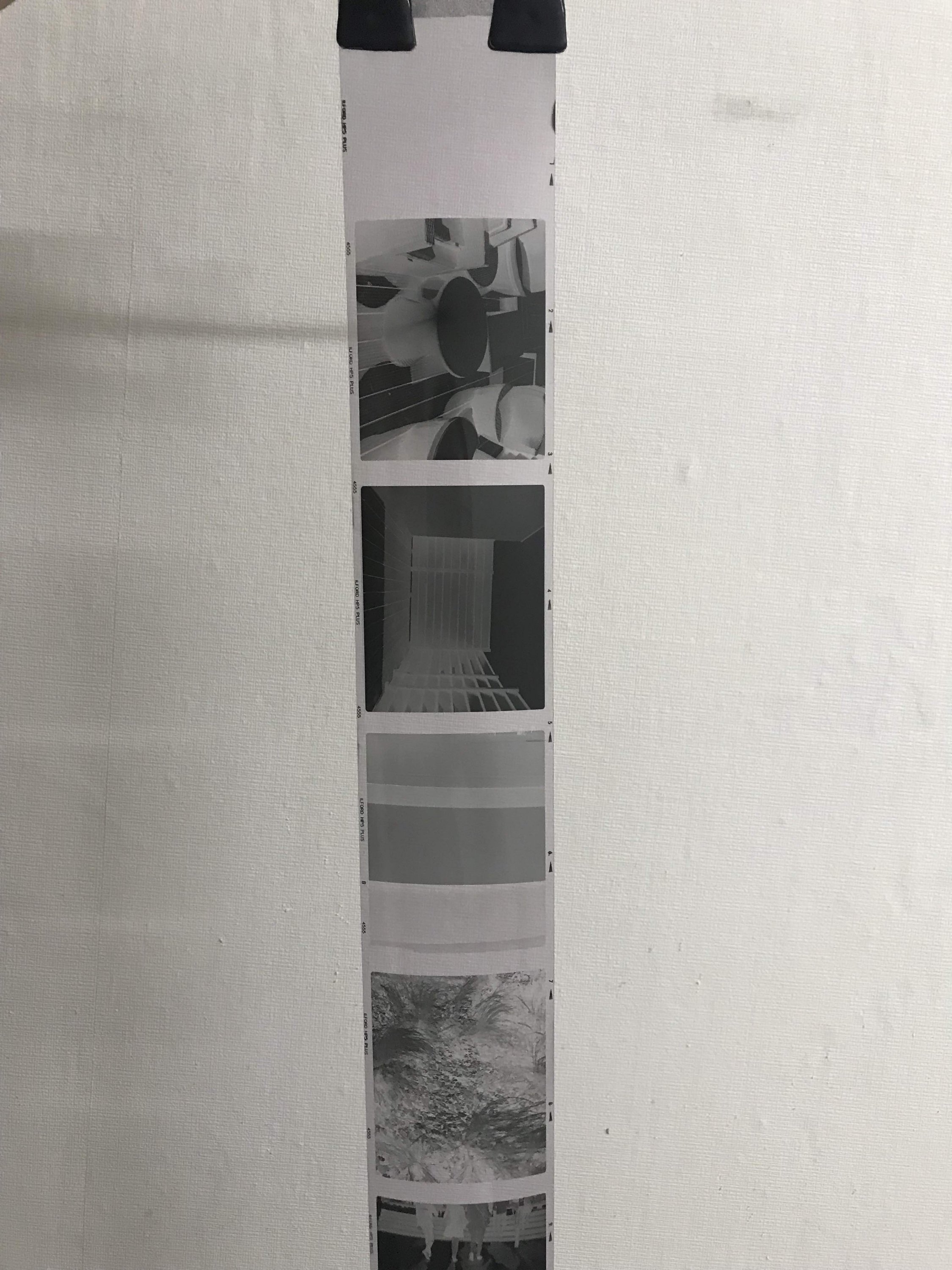

Better again.
I need to be more tender. Develop with "Love me Tender" :D:D:D
I think after thousands of rolls I'll change my temper!
