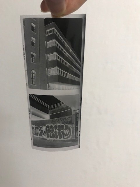

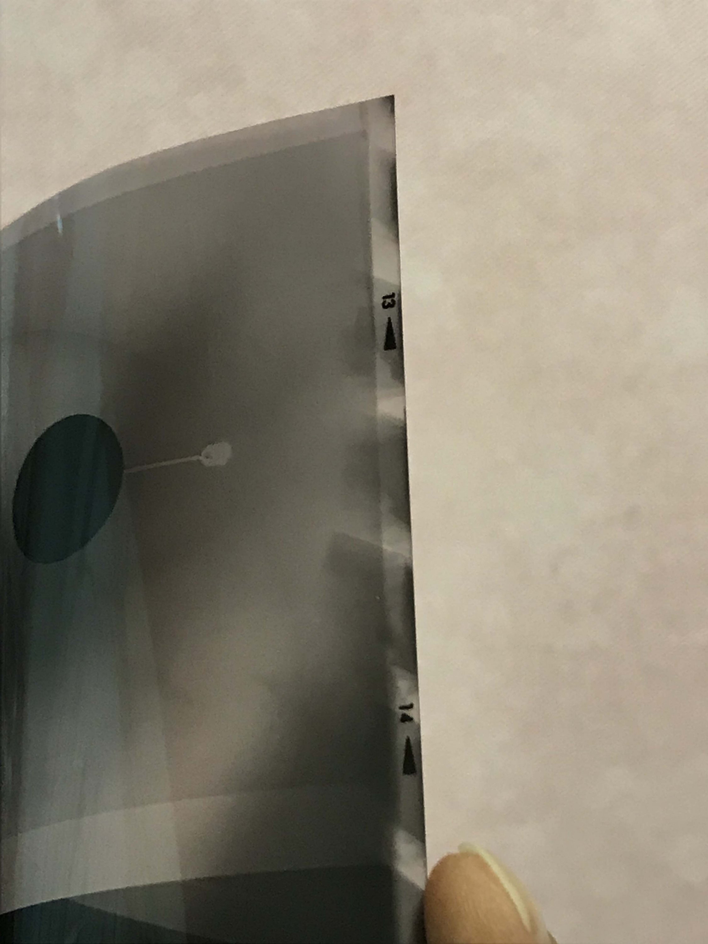

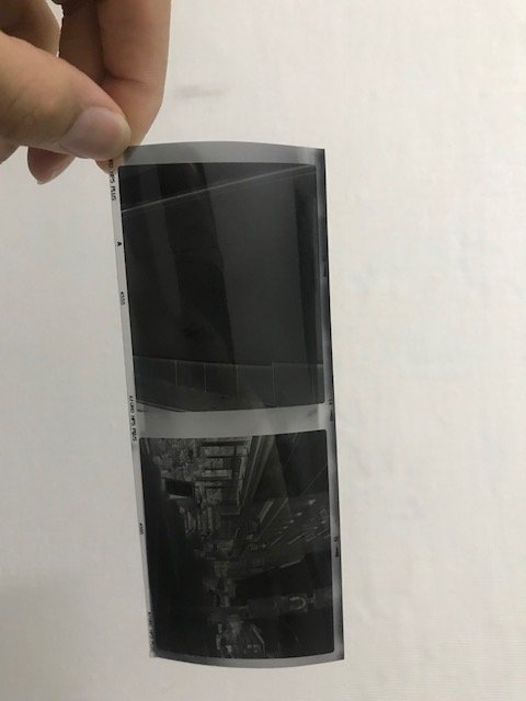

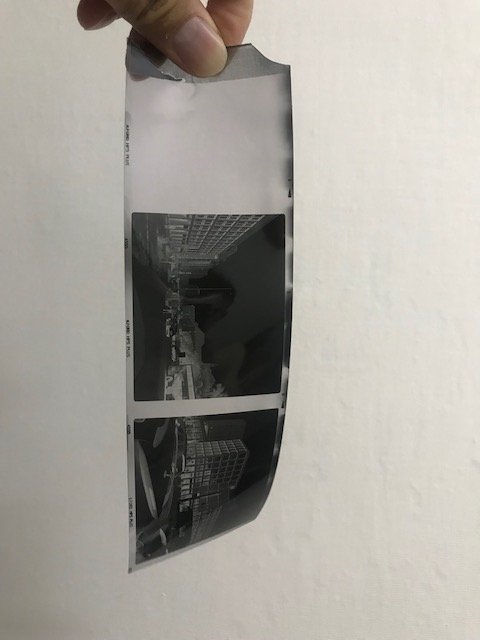

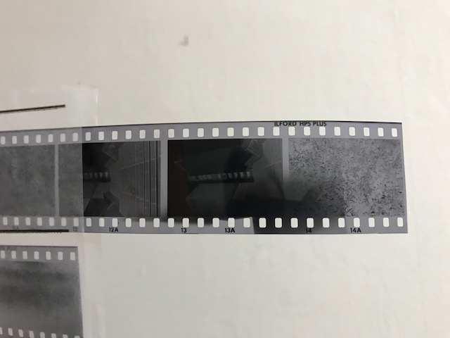

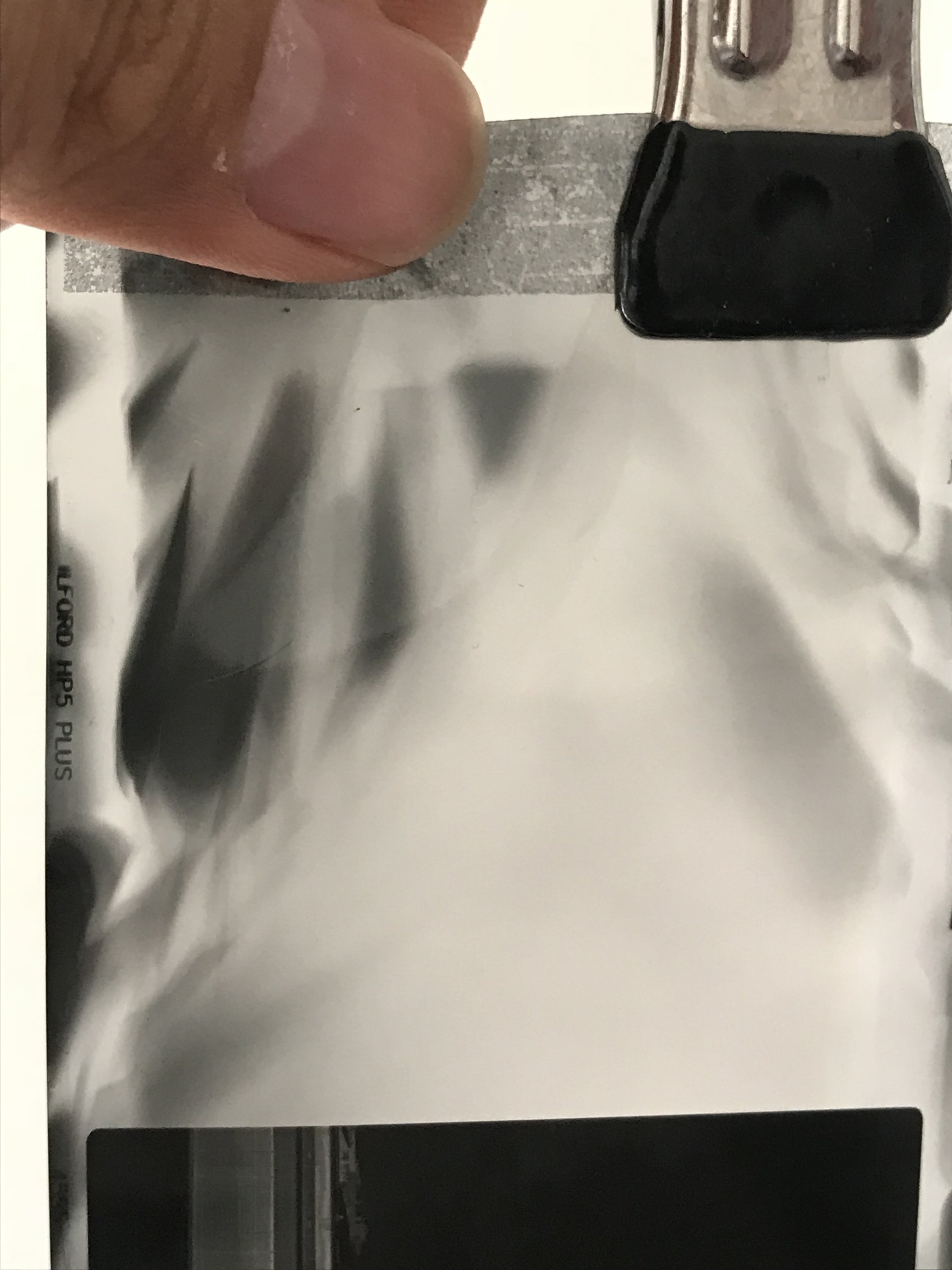

Hi,
I met troubles when updated my development equipment with JOBO 2500 Series Tank.

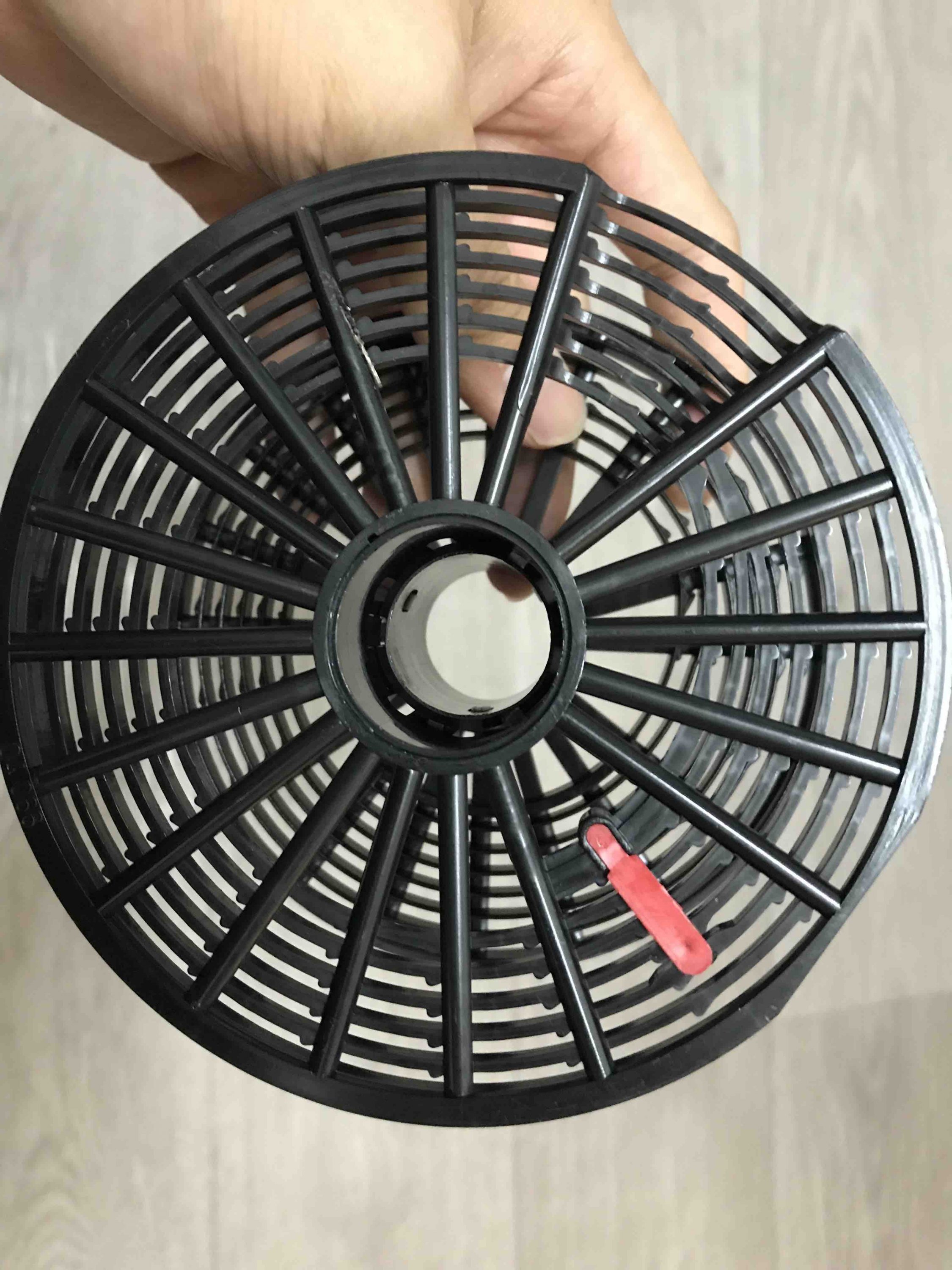

I used the spiral like picture 1. (It's duo set 2502)
It has a capacity of 2 rolls at the same time.
So I developed 4 rolls at a time with D76 1:1 (two spirals).

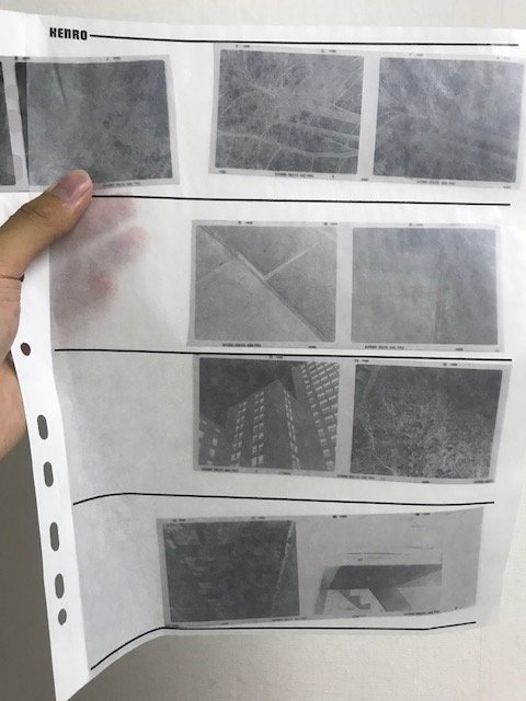

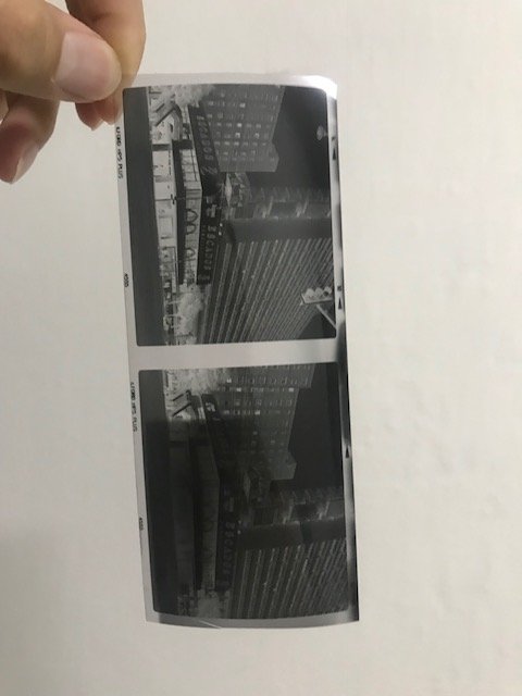

It gave the result as two other images showed. The form of the spiral appear on the film.
And so many espace left with dark irregular signs (like cloud) on the negatives which means bright signs in the picture.
I rotated manually with two hands continuously, acted like CPP machine.
This method didn't gave any problems when I developed color negatives.
But for B&W film, I gave up. So could you please give any advices?
P.S. I'm sure no problem with camera. Film is well installed in the spiral. No leak of light in the tank.
Best regards,
Yann

Looks like light leak to me. Did you install the central tube?
Yes. I installed the central tube. And I verified with my finger that the tube is well positioned. Because I had one time carelessly. Once the tube is not well placed, the light leak immediately and all film turned to dark. So I ensured it's not a light leak.
When I rotated it, I ensured frequently that the cap was well closed.
Thank you AgX!
Well, it sure does look like a light leak to me. Odds are that the incorrect center column was used, it was not installed properly (upside down?) or that the lid (the big one, not the flexible rubber one) was not seated properly.

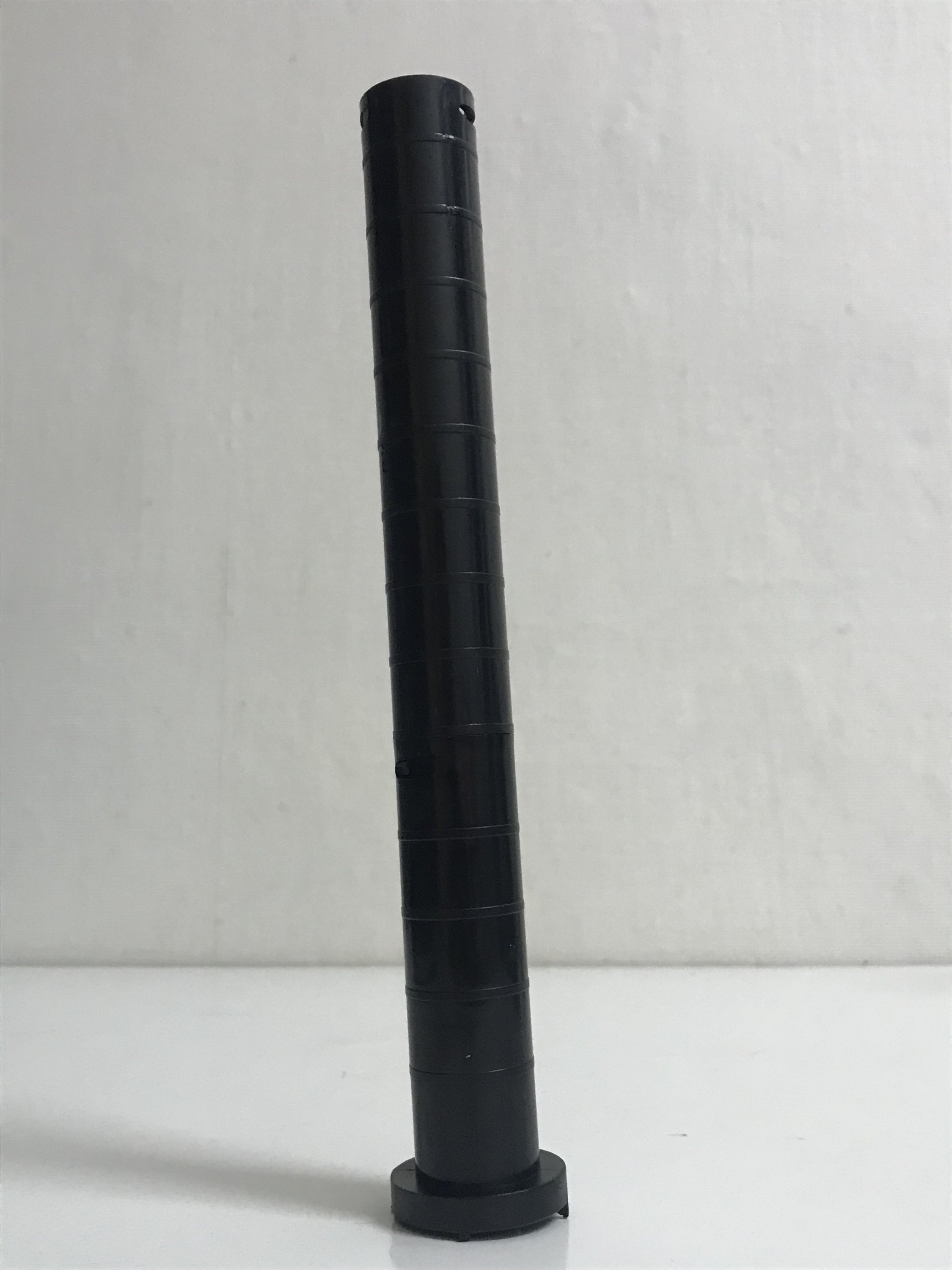

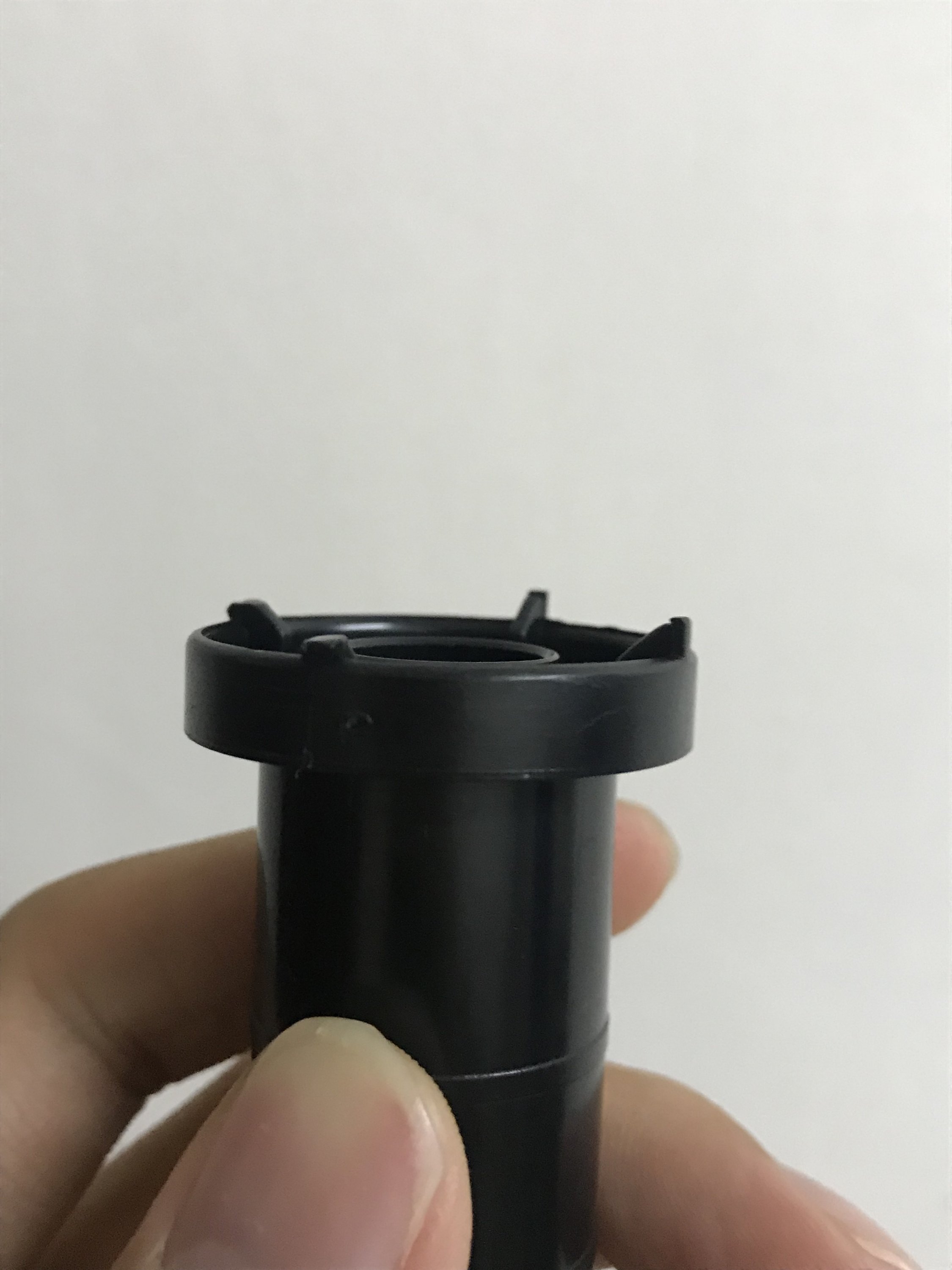

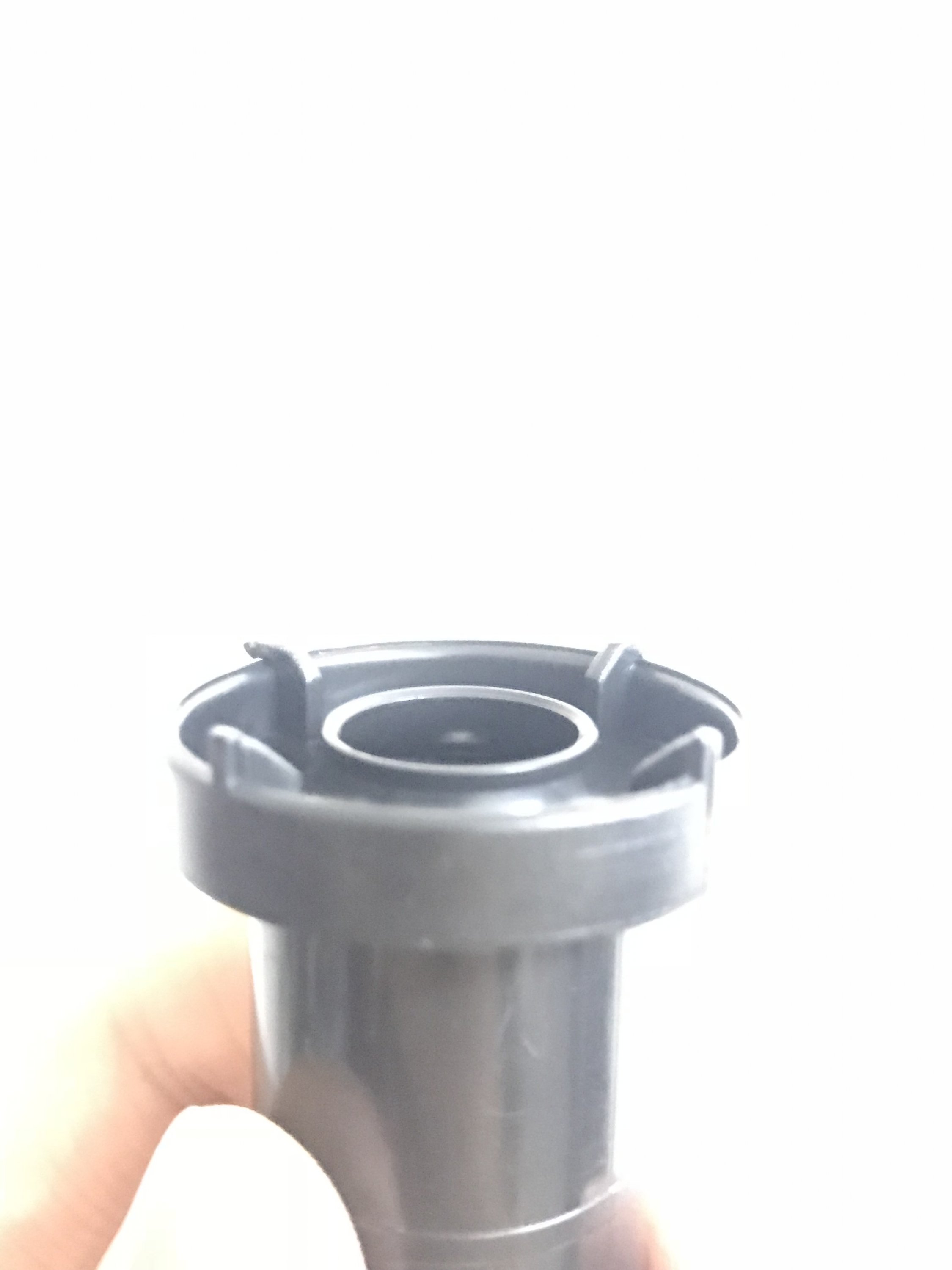

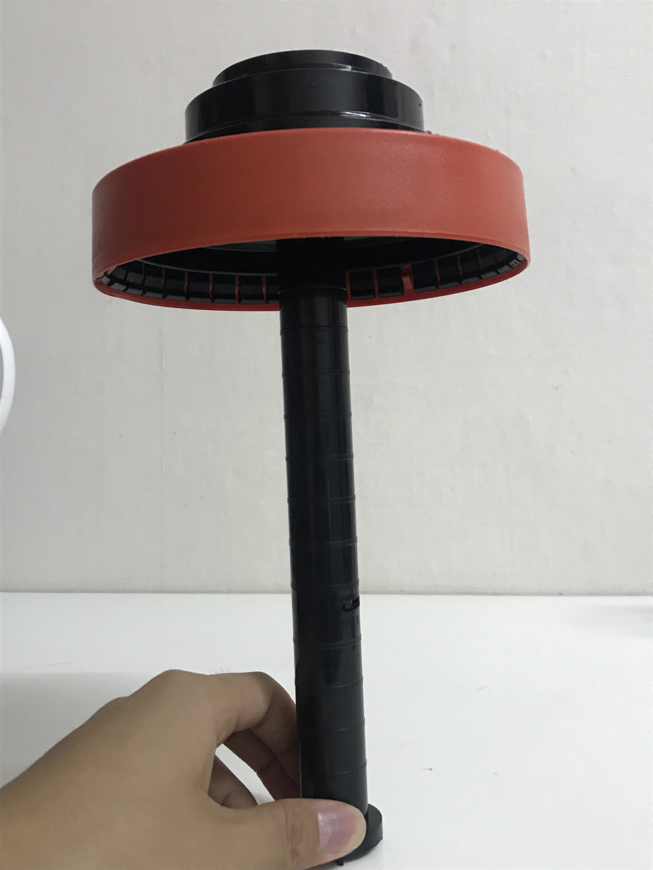

I'd like to verify with you if your column doesn't look like strict vertical?
Please see my column in the picture.
When I closed the tank, I attached the column to the big tab within the holes.
So I took pictures too of the foot of the column.
Will this cause a light leak?

Dear Yann,
You have everything right with the tank and reels. There should be no issues. Are you sure that the fogging could not have taken place outside the camera or tank? Perhaps the roll wasn't tightly wound when removed from the camera?
Neal Wydra
Dear Yann,
Neal Wydra

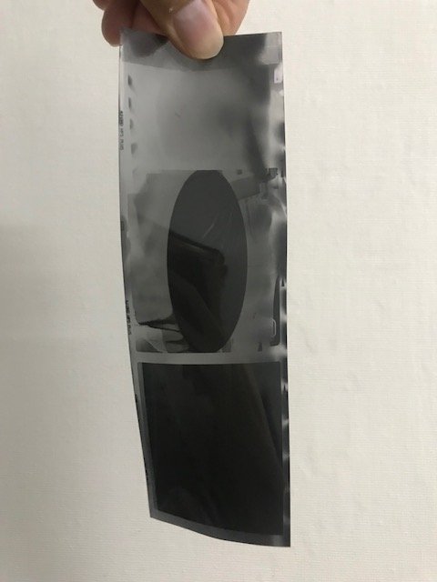

Hi Neal,
Thank you for help.
I can ensure that there is no problem with the camera because I developed another film yesterday night in Kindermann Inox tank and it appears OK.
Please see the attached image.
Yann

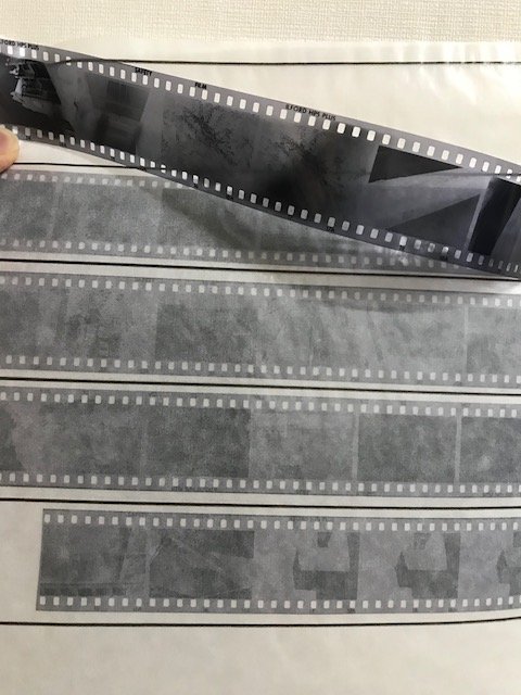

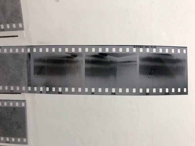

There are signs too when I developed 135 films the days before.
Because it's the roll I prepared from bulk film so I didn't think at first it was the tank problem.
It only appeared at some points, but still very annoying.

Please check if the center column falls into the protruding filler tube of the cap when the cap is put onto the tank. In my 2500 tank, the column has the tendency to slightly clamp onto the protruding filler tube so it is lifted along with the cap upon opening the tank.
Yes. It is lifted with the cap.

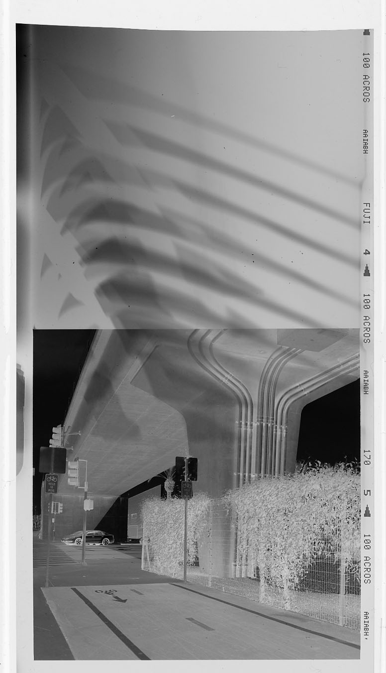

This is a whole roll which shows the affection just from one side. If there is a leak, it's probably from one side, but I'm not sure with the orientation of the reel.
In IMG_4766, you can find easily a dark square which probably the end of the film.

What is the exact number of 2500 series tank you have? The center column you show is for 2550/2551/2553 called multi-tank 5.
If you are using a multi tank 6, 2561, 2563, or a 2830 print tank your column is too short.
I would confirm that the funnel is properly attached to the inside of the lid.

Hi AgX,
Thank you for your help!
I received a PM this afternoon. In his letter, he told me that is an over agitation. The signs left on the film is because I too violently rotated the tube manually.
I tried tonight more gently (but still violently). The effects decreased, but still there. It seems that I need to agitate the tube less frequently and less quickly.
Thanks anyway for your kind response!
Best regards,
Yann
