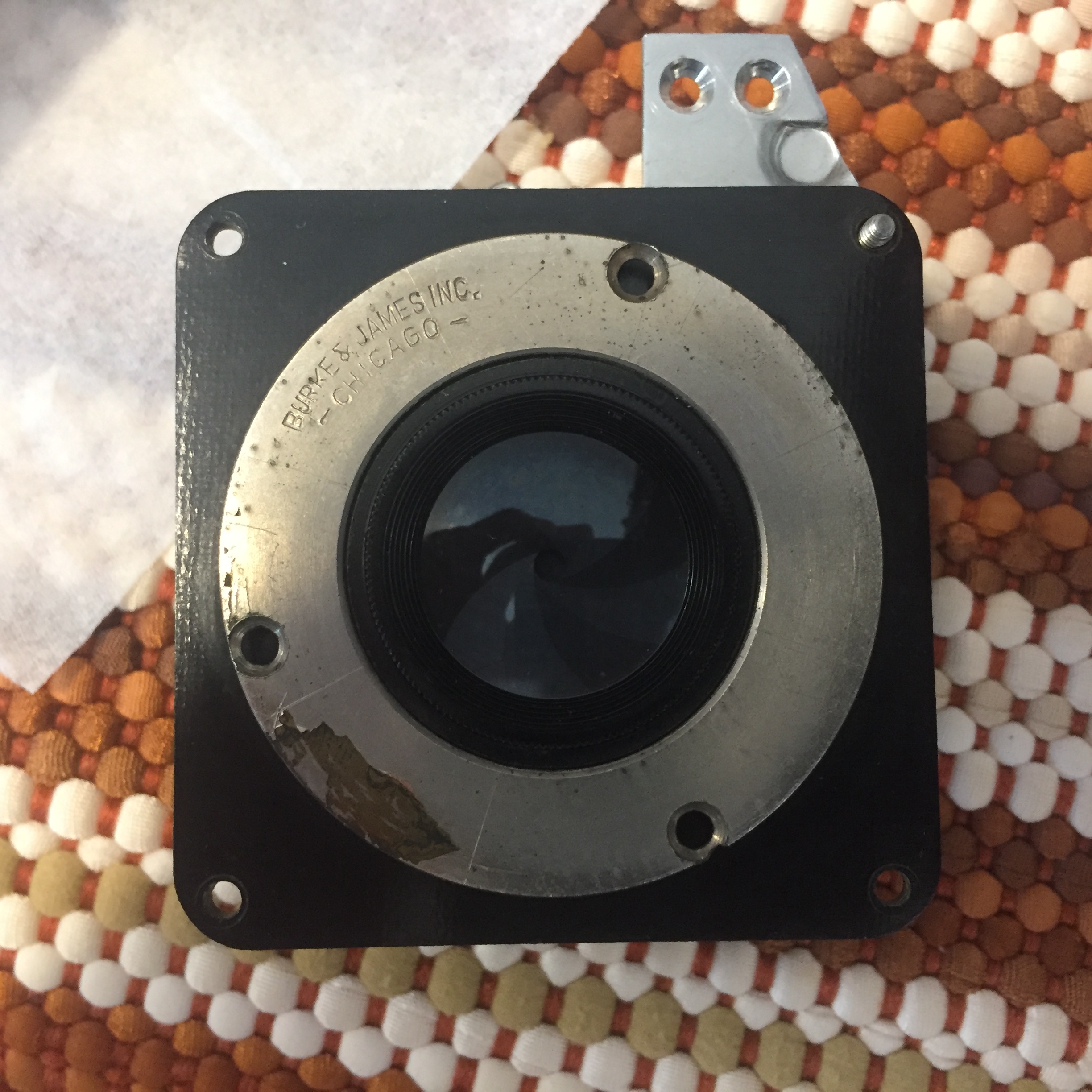

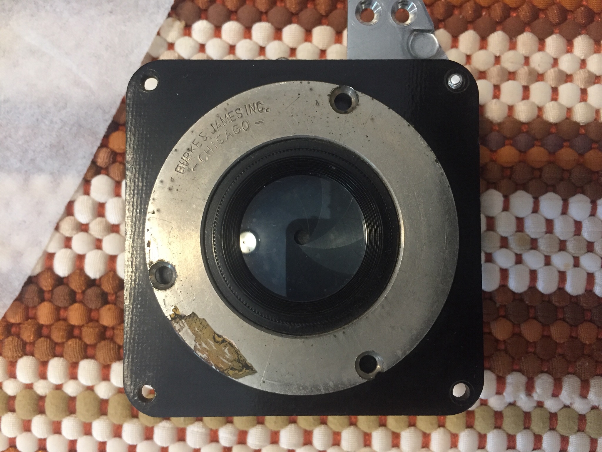

I got this lens already attached to a Busch Pressman lens board, but I can’t get it off! There isn’t a simple retaining ring like on other lenses I’ve seen. I’ve tried to get it off so I can take measurements of the dimensions of this lens board for the past 5 days or so with no luck. Am I just dense or is there no easy way to remove the lens?

Try a lens wrench.
Dan Fromm
Mar 23, 2005
6,823
Instead of a retaining ring it has a flange. That's the disk with three countersunk holes. I'd be tempted to hold the shutter with one hand and the flange with a jar lid remover. Unscrew the flange from the shutter.

Unscrew the lens elements first, and put them somewhere safe. That way you don't scratch them. Then, you can try dropping some penetrating oil around the retaining ring threads, and see if that helps. If that doesn't do anything, try some acetone. Sometimes they glue stuff in, and acetone is great at eating old glue. It's also great at eating plastic and paint, so be very, very careful with it. If you're not sure about using acetone, use rubbing alcohol and see if that helps. Rubbing alcohol is a lot safer, and while it doesn't east as many types of glue, it also doesn't eat as many types of paint or plastic.
If that doesn't work, you can try heating or freezing it. The idea here is to make either the retaining ring, or the shutter metal contract or expand enough to loosen it's grip. Try throwing the whole thing in the freezer (minus lenses) for a bit and see if that helps. If not, try running heating it up with hair dryer. Don't go rapidly from one to the other though. Rapid swings in temperature can cause things to break. Also, if there are any plastic pieces, be careful with the hair dryer. Don't let anything plastic get too hot, or it might melt.
Those are techniques I use to get things unstuck. When working on old cameras, finding things stuck together is pretty common and one develops several techniques to deal with them.
DO NOT use rubbing alcohol, it contains water and oil, use 90% Isopropyl Alcohol.
Penetrating oil on the threads left overnight to two days should do the trick. The mount ring/flange has a tendency to fuse to the shutter after many years and may require 100+ foot pounds of torque to break loose.

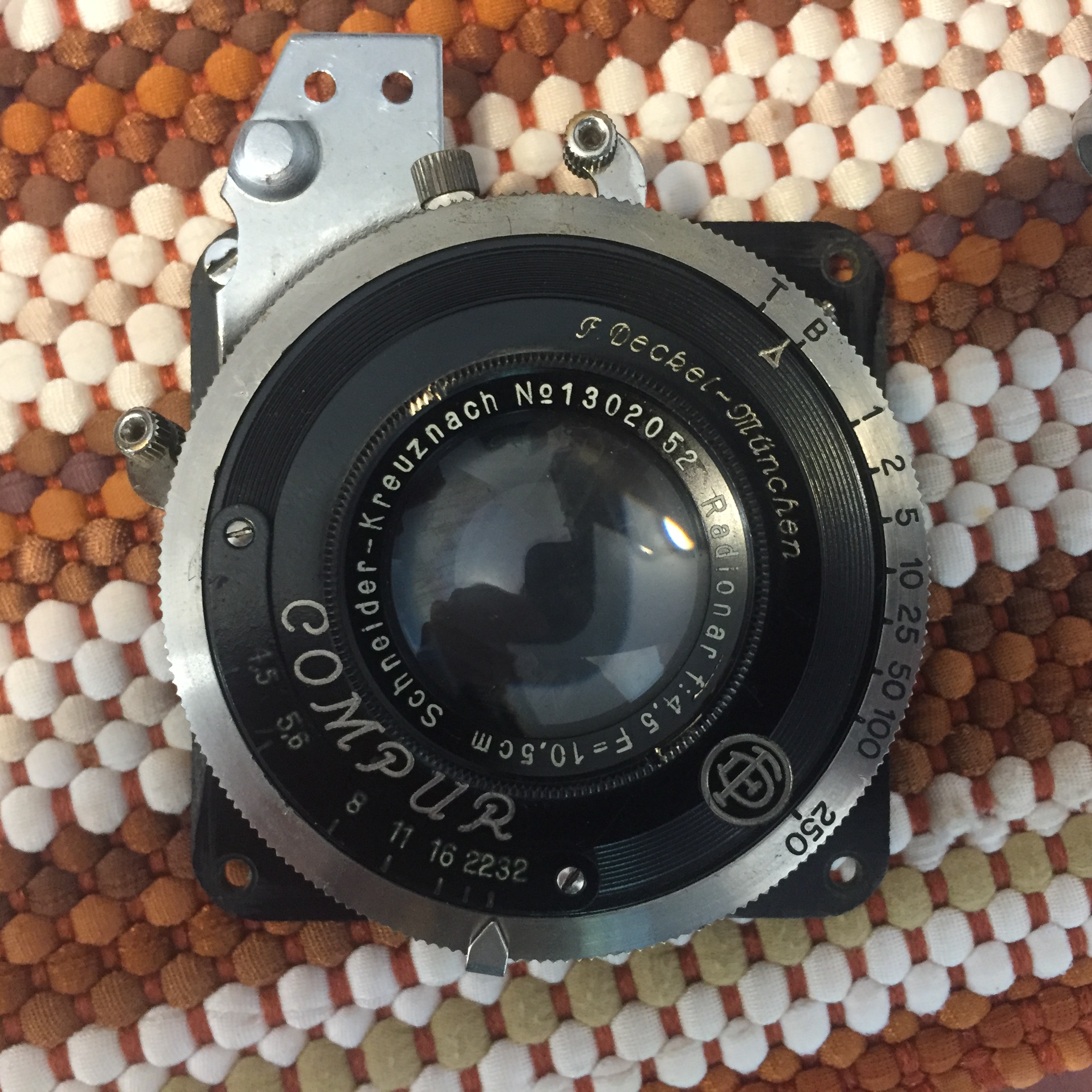

I got it off! I let some 99% isopropanol soak down into it, gave it a few taps with a hammer, then used a spanner wrench in two of the holes to break it loose. It must have been on that lens board for a while because it was really on there.
Got my new lens mounted on it without an issue. Still want to pick up one or two other lens boards so I might give Midwest photo a call.
