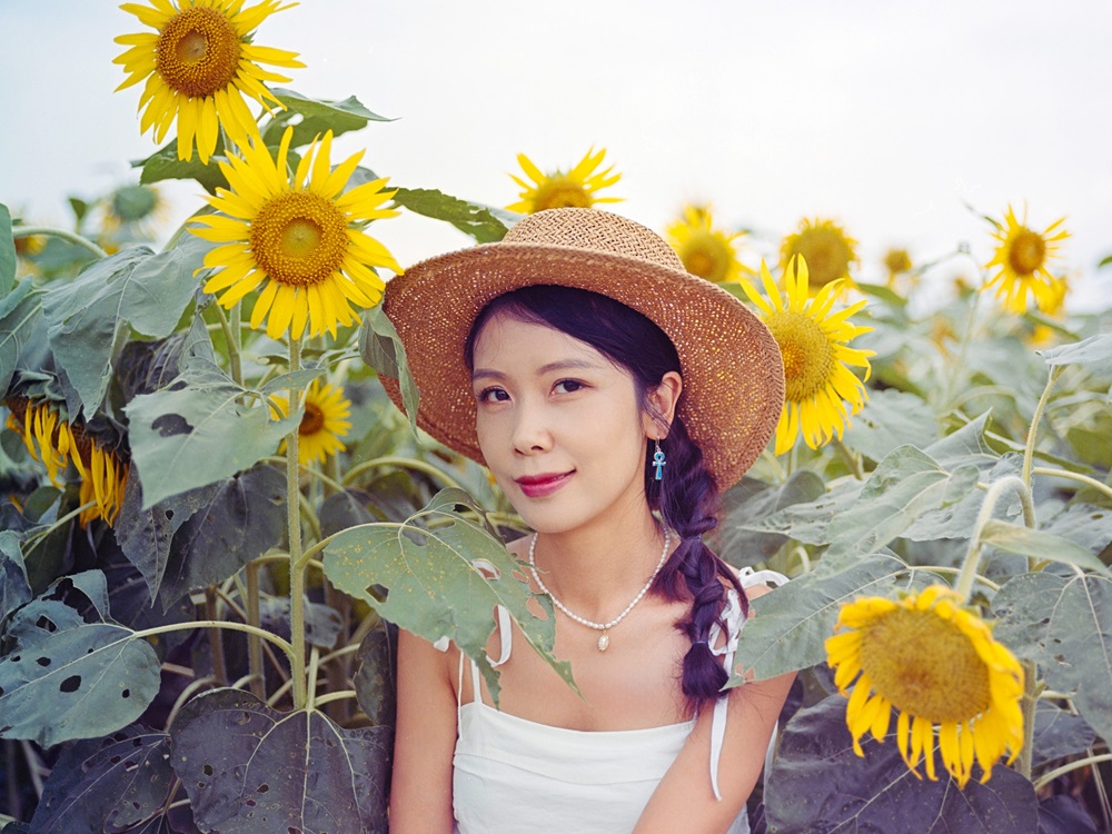

Hi all, first time for me to post here.

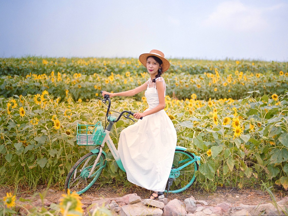

Got an issue developing Portra 400 at home.
I always get a greenish color shift, very difficult to correct in pp. This is the second time already.
This time, in the same tank during the same development was an expired Fuji Pro400, which turned out ok.
I developed Ektar, Gold, Fuji 160 before without any problem. Only Portra has this color shift, which turns me crazy as this is supposed to be one of the best films available.
My processing parameters:
3:30 developing @ 38C
7:30 bleach @38C (a bit long, but first time I bleached for 6mins and had this color shift and it was suggested I lengthen the bleach)
14:00 fix @RT
1:00 stabilizer
Thorough rinsing in between steps, especially between developing and bleach, like 7 times. I used 38C water to rinse before developer as well, like 10 times, until the water became clear.
Camera is Pentax 645N+75mm2.8, C41 kit purchased online.
Scanned with Canon R, pp with Negative Lab Pro.
The following is Portra 400. The girl became a little green alien.

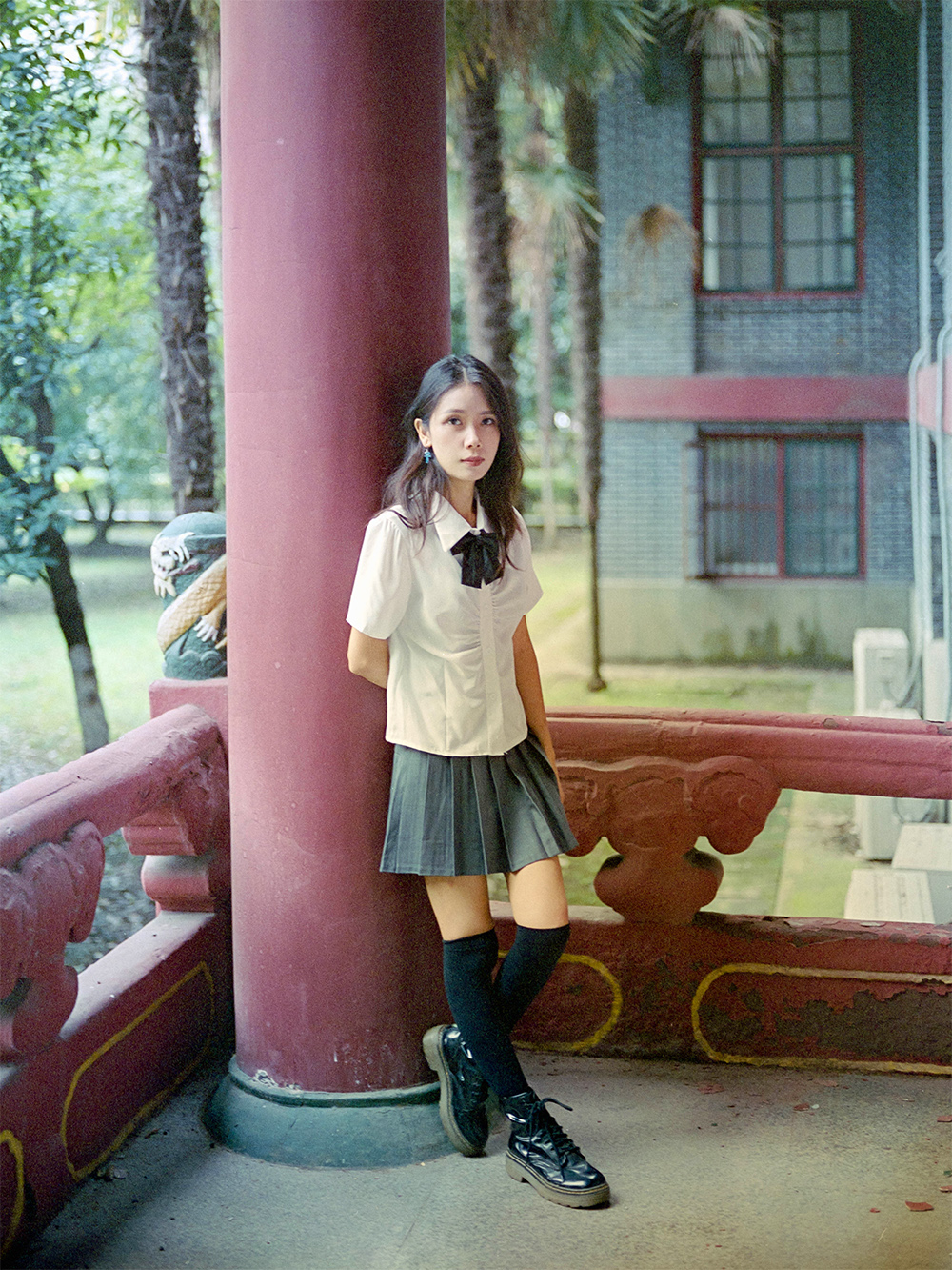

This is Fuji 400, expired, in the same tank during same development, no problem with color
Please advise!

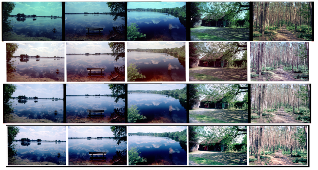

To illustrate, this is the same strip of negatives, scanned in 4 different ways:
Can you tell on the basis of these scans if there was a development problem? Indeed, neither can I! It's impossible.
Taken from this blog on the subject: https://tinker.koraks.nl/photography/all-over-the-place-the-problem-with-color-negative-film-scans/ (I wrote this because this question pops up just about every week and has thrown a large number of photographers for a loop - it's a shame of all the wasted time!)
If you're satisfied with the Fuji negative, that's fine, but I suspect it's pretty bad even based on the scan. Given the rendering of the shadows, it's either underexposed or (more likely) fairly heavily fogged. The latter is likely given the age of the film.
The part to the right of the subject is much warmer than the left-hand half of the image.
Yes, there are gross color balance variations across the frame, in both examples posted. This makes them virtually impossible to color balance well. I suspect these trace back to the camera scanning setup and unevenness in the illumination of the negative.

This expired Fuji400 is indeed not optimal, with a blotch of yellow in the middle, and it is noisy, but the skin tone is much better than Portra.
The yellow blotch is unrelated to the film being expired. It's most likely a light scanning source problem. Maybe you've just overlooked it until now; it sometimes takes a while before you figure a problem out and then it turns out it was there all the time.

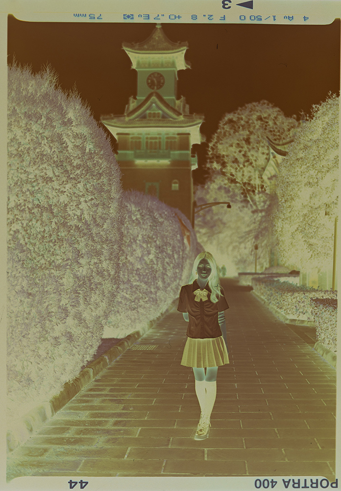

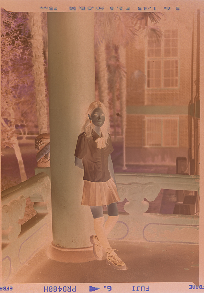

PS: it might really help if you could also post one or two 'raw' negative scans here (not inverted or color-corrected). They don't need to be full-resolution files; you can downsize them so they can be posted on the forum. This will make it a little easier to see what you're actually working with.
Yes, this ^ would be great!

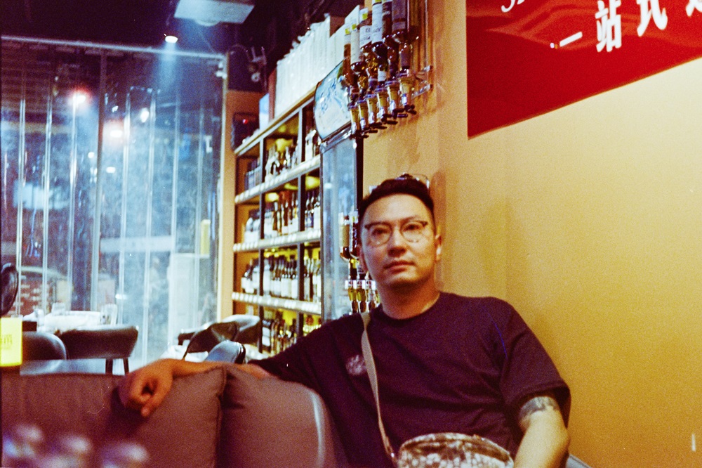

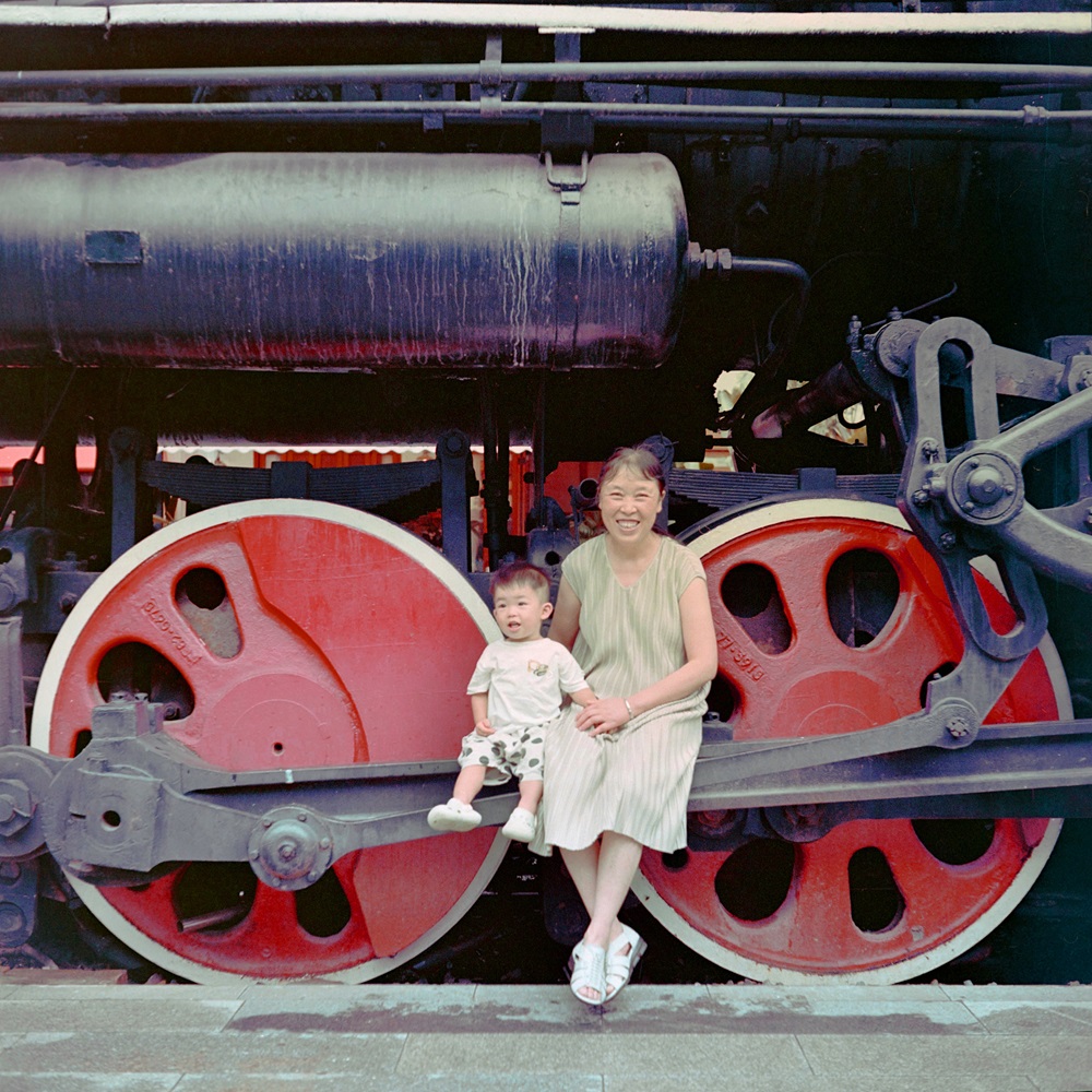

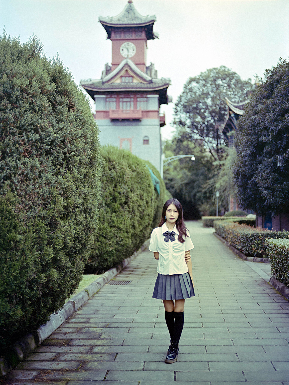

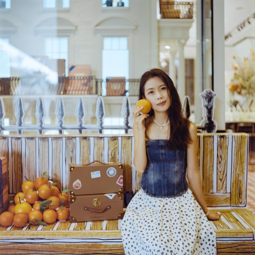

This is last week's Ektar
And this is Fuji160
This was Gold 200 from about 2 months ago, shot with Autocord manual focus, so a bit blurry
And this was the first Portra 400. I already tried my best to balance color, direct NLP conversion was worse

Yeah, all your scans have the same problem with a yellow spot in the center. I think you maybe overlooked it because it kind of looks like a natural vignette.
The color balance on all of your photos shows distinct anomalies; none of them looks right.
In the Ektar example, note the blue band at the bottom of the frame.
On the Fuji example, note how the white dress goes from blue (bottom) to yellow (top).
Both of them have a distinctly brighter center area and darker corners that don't look like lens vignette since they coincide with color balance changes.
The Gold 200 shot is overall wonky color-wise, but that's at least partly due to the lighting in the scene, so difficult to get that to come out right one way or another.
I agree the Portra 400 shot looks especially problematic, but since the problems are occurring in all examples, I think you're dealing with a systematic issue in your scanning setup, not so much a film-related problem.

How about this image, apart from focus error, any color shift issues?
Shot with FE2+Cinestill 800T
koraks
Nov 29, 2018
26,115
Europe
Hard/impossible to tell with the mixed lighting. You've got very warm/low-K artificial (LED?) lighting in the foreground right, something much cooler (streetlights; with typical Cinestill halation) shining in from the exterior and mixed lighting on the wine rack in the middle. The couch is also a mix. Since the lighting is so variable across the image area, it would be hard to notice more subtle shifts across the frame, even if they are there. For instance, if the center is yellow in this particular frame, you'll never notice because the skin tones on the face are very warm due to the light source on the right side and on the wine rack the yellow cast is lost in the color of the bottles.
For reasons like these it's very likely you never noticed the problem - until you start photographing scenes that are more critical and everything starts to crumble. Try shooting a model on a grey/overcast day in a concrete environment. You'll drive yourself crazy to get it to balance shots like those well, especially if you need good shot-shot and roll-to-roll consistency!

I looked at the negatives and did a rescan. This time I put the negative in the middle of the light pad and did manual inversion. These are findings:
1. 120 Portra negatives are greener than Fuji, both 120 Portra 400 I developed at home are like this. I have a lab developed 135 Portra 400 which is brown like the Fuji.
2. Turns out that the yellow blotch in the Fuji image is indeed caused by uneven lighting in the pad. Fuji image improved.
2. Manual inversion yields better results than NLP, for both Fuji and Portra.
3. However, the Portra is still color shifted to green, and very difficult to yield pleasing color.
Conclusion: Light pad is a problem, but Portra is still off.....
Here are the 2 rescanned negatives to play with. Both are under the same white balance of my R6, you can see the color difference.
Do let me know the parameters if you manage to get pleasing colour out of Portra.

So, are you saying that you developed this Portra 400 and Fuji 400H at the same time (same tank) and Portra came out green?!
BTW, lighting is still not even close to being uniform (unless, of course, actual negatives both have higher density on the upper clear part than the lower).
Thanks for posting the actual negatives. You have severe cyan staining on the portra negative. In my experience this is generally due to either optical fogging (e.g. while spooling the film onto the developing reel) or due to incomplete bleaching and/or especially fixing. I'd start by running this film through fresh bleach and fix and see if that makes a difference. If you try one strip of film, you can compare it with the rest of the film to see if there was any change. I suspect that your replenishment method doesn't work well and has left you with dead fixer.
Thank you for the advice. Fuji and Portra were loaded onto the same reel, developed in the same process in the same tank, So I don't think it is optical fogging.
I heard that Portra has thicker emulsion, So demands better bleach and fix. Will try with fresh bleach and fix.
So I put one strip of already developed Portra into bleach and fix again?
