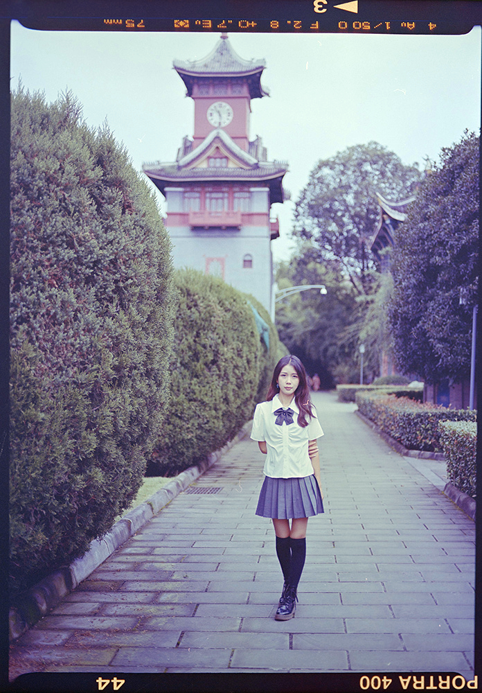

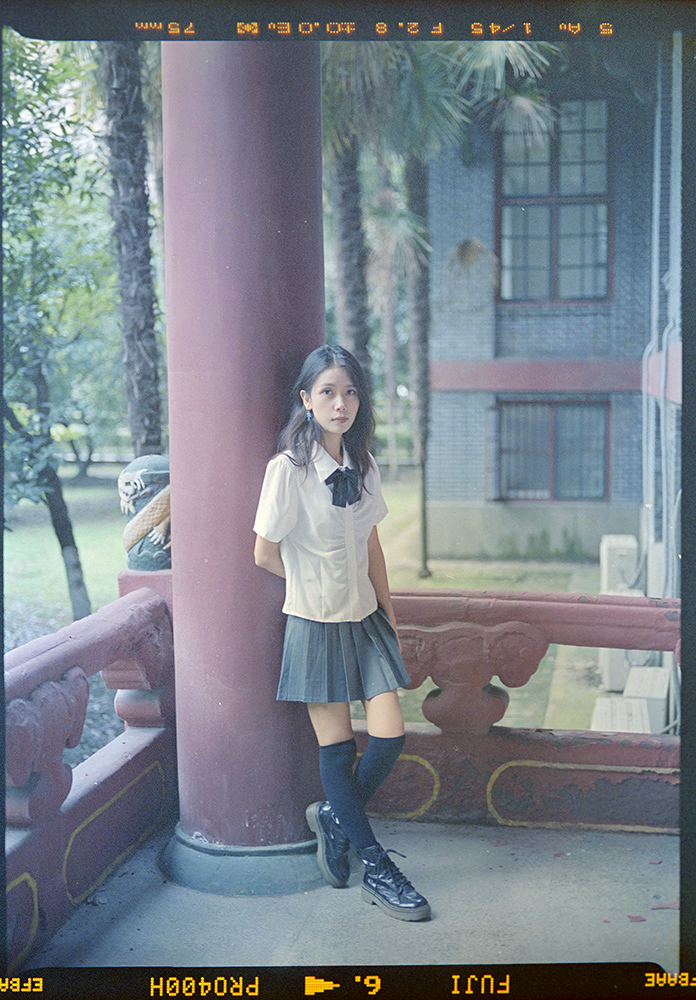

Here are the 2 rescanned negatives to play with.
Note that there is still severe color crossover on this scan likely due to uneven illumination. There are yellow and blue spots all over the negative. Note how the bottom of the white shirt is yellow while the top tends towards cyan. Likewise, the entire top of the frame is very blue. The floor on which the model stands is bright blue on the left side and and yellow/tan on the right side. The entire bottom left corner is very blue, which is not just due to the lighting/shade. There are still issues to sort in the scanning process.
Big problems on the Portra shot as well; in part these might be due to the overall cyan cast, although the pattern is quite similar to the Fuji shot above, so I think most of this is still due to the light source. Note the massive blue area to the right and how all the shadows go deep blue; this is likely where the cyan cast is presenting problems as it throws the curves out of whack.
Note how in both examples the red, green and blue curves are not parallel. Don't attribute too much value to this, because the digital camera etc. play a big part in this. However, in my experience, a well-scanned color negative (scanned as a color slide, so yielding a direct representation of the actual negative) that is properly processed tends to balance with fairly parallel RGB curves. Many factors can play a role in this, including digital equipment and software, but also film age, process variations etc. Again, don't attribute too much value to this, but the degree to which the curves cross over in this case is fairly extreme.
Here's how I did the inversions: https://tinker.koraks.nl/photography/flipped-doing-color-negative-inversions-manually/
I heard that Portra has thicker emulsion, So demands better bleach and fix.
This is indeed possible and I've noticed a similar difference between Kodak C41 and ECN2 film, with the latter requiring more thorough fixing. I once ran into this issue, which is why I'm thinking you may be dealing with the same: https://tinker.koraks.nl/photography/how-i-broke-my-fixer/ In my case, it was trying to get away with too dilute fixer, which would work the same as an underreplenished fixer.
So I put one strip of already developed Portra into bleach and fix again?
Yes, please, give that a try!

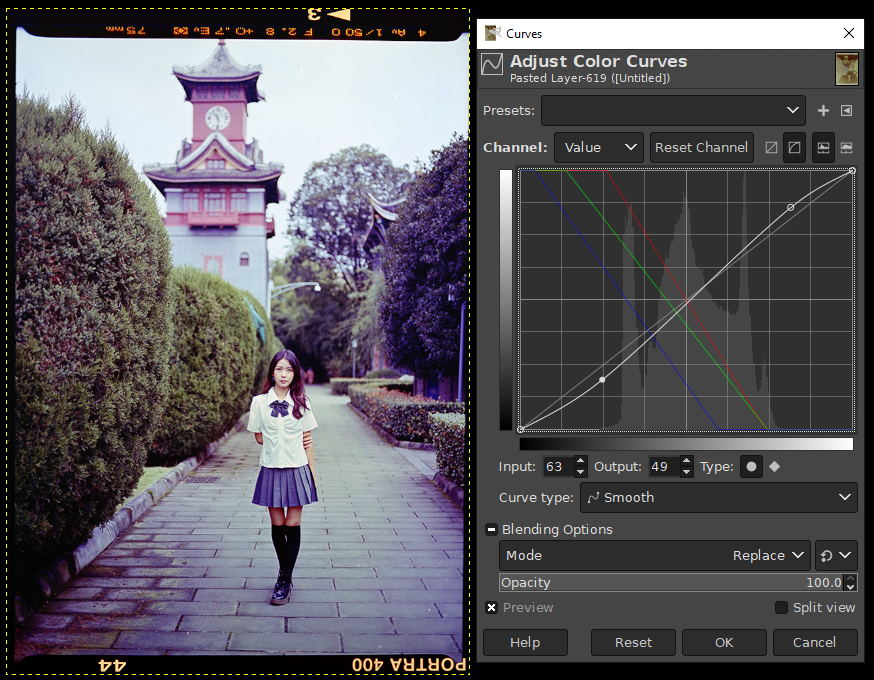

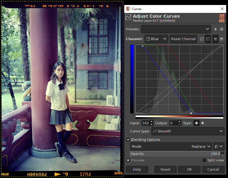

Thanks for posting those.
Here's a quick conversion, about one minute per negative with no additional color correction after converting them. It looks to me like the negatives are salvageable, at least after re-scanning. Working from jpg is a little bit limiting.
Look at the film base top and bottom. To me it's pretty evident that there is an issue with uneven lighting in the scanning setup.

I wonder if it would so obviously be limited to only one channel.
I've had this happen before, yes. What was different in that case was that there was also unevenness across the film, but overall the effect was also much more subtle in my case. But it was limited to cyan, specifically.
Excellent point that illustrates it well.
I doubt the Portra neg will be really salvageable given the cyan problem on the actual negative. In this particular case it's a combination of factors.

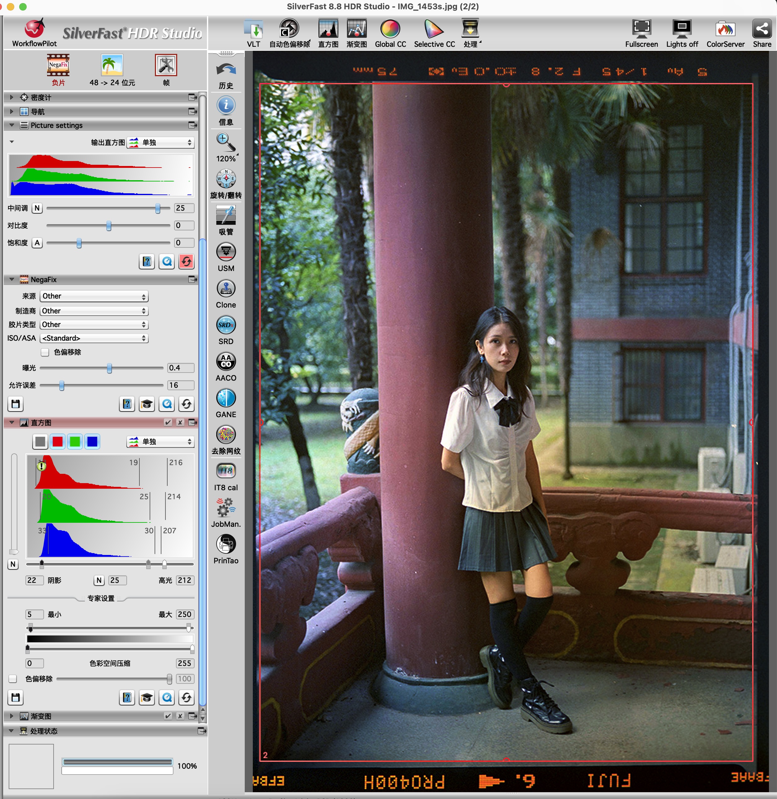

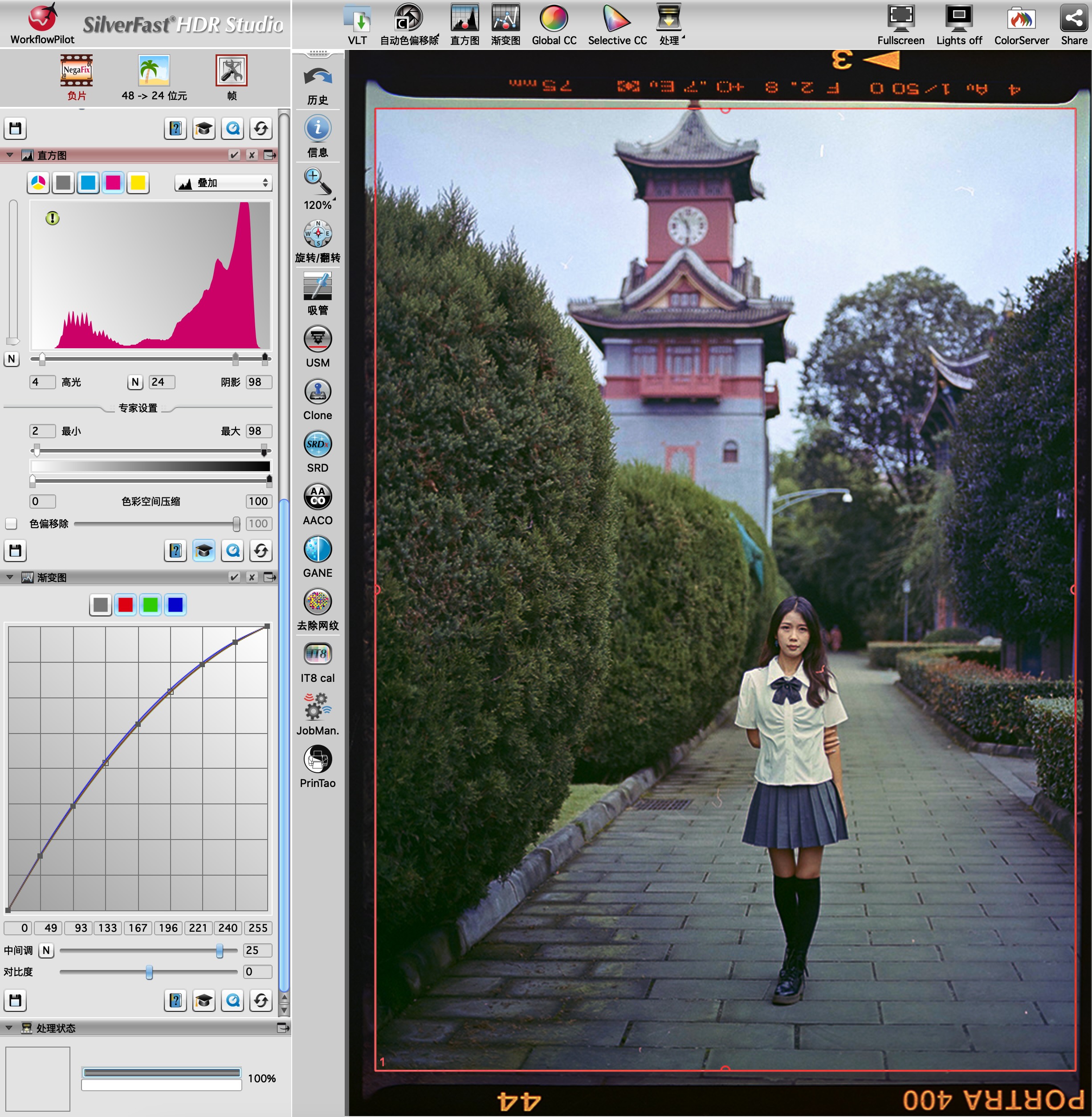

Corrected to the best of my for the example images.It has a color cast but looks much better.
I used Silverfast HDR for the adjustments, I only used the Levels and Curves tools, no HSL.
