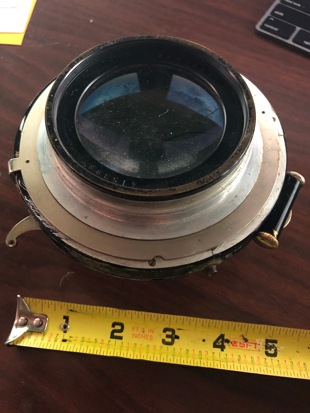

Where can I get Sinar lens boards drill for compound shutter ~3 ⅜" (86mm) and a No.5 Synchro ~3 3/16" (81mm). I need the boards as well. TIA,
MPEX might have them. SK Grimes can make them up new.
Good to see you around John.
Hey Matt, Nice to see you virtually too.
Hey David, I checked MPEX, and your post reminded me of KEH. MPEX has a Sinar board, I'll see if they can drill it out, I was going to have SK Grimes create a retaining ring for the compound shutter. I may ask them if they have a lens board as well, but I wont be asking them to create one. I live in the sticks now, but back a few years ago I lived in Ferndale, where I could find machine shops within walking distance -- a perk of living on the edge of Detroit.
If it’s a large shutter, it may have originally had a flange fastened to the front of the board with screws rather than a retaining ring. MPEX may already have one in a box of old flanges somewhere. If you can find one, it saves the expense of fabricating a retaining ring.
It is an enormous shutter. It may have screwed into a lens board or had a ring that was secured to a board via screws.

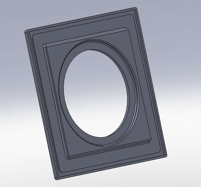

I 3D print my sinar boards in ABS. I place a reinforcement in the back that may be a problem or not, but I would modify it if necessary. If you want to go that way... I attach the STL 81mm and 84mm hole design files that can be printed in any 3D printer service.
Replace the TXT extension by STL, as STL coul not be uploaded
It should be a high density print to be robust. As always, in the printing the part has to be slightly oversized to overcome contraction from the cooling.
  • SINAR_LENSBOARD_81.TXT
  • SINAR_LENSBOARD_84.TXT

138S, One of the lenses weighs over 3 lbs. Do you think the plastic will be strong enough? Do you think a retaining ring could be printed?

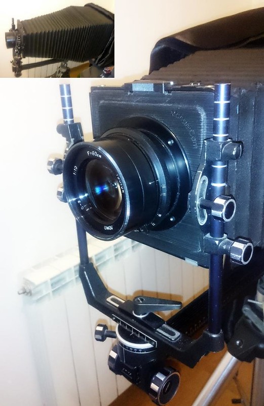

3D prints in ABS should resist well if well made, the first printed lensboard I made was for a LOMO O-6 600mm weighting 1600gr, a more difficult situation because weight is unbalanced as all the lens is placed in the external side.
In the SINAR case the board is thinner, but I have a 1kg Sironar 300 in an ABS board that was not reinforced, the attached files have a reinforcement in the back, but it can be reinforced better. Also some metallic or carbon fiber platings can be bolted in the back or front of the board.
An optimal "top pro level" solution I'm considering is (watter jet) cutting a carbon board and 3D printing the light traps.
PLA material is strong but fragile and unpredictable, best common material would be ABS, but it has to be printed at high density and taking care the print is well made, a 3D print can be quite flawed. I would print one of the boards and make a destructive test, forcing it until it is broken to see if it is safe enough, of course it would be painful if the lens falls to the ground !! Again, an ABS print shrinks around a 0.8%, so the model is scaled up by the printing service people to end in the specified dimensions when cooled, buy later we have to chech they this that job well.
The material used should have no degradation from UV exposure, https://3dprinterly.com/is-pla-uv-resistant-including-abs-petg-more/ if not the part becomes weaker as it is used outdoors.
Regarding the retaining rings nightmare, I found a suitable way to use a thick nylon ring with no thread but with the proper dimensions that allows to make the thread as we turn the ring on the shutter thread, if the hole dimension in the nylon ring is the good one then result is totally safe. I make the first 1mm of the hole a bit larger to help center the ring in the shutter's thread, this makes it way easier.

I found a retaining ring on eBay for the Heliar and talked to Jim at Mpex. Jim is a really helpful guy and with his assistance I'll get this sorted. The next issue is find hoods that will fit these beasts. The lenses will cover 8x10, but I am going to use them in 6x9 and 6x12 so I'll need a way to cut down the image circle so it doesn't light up the inside of my camera like last call.

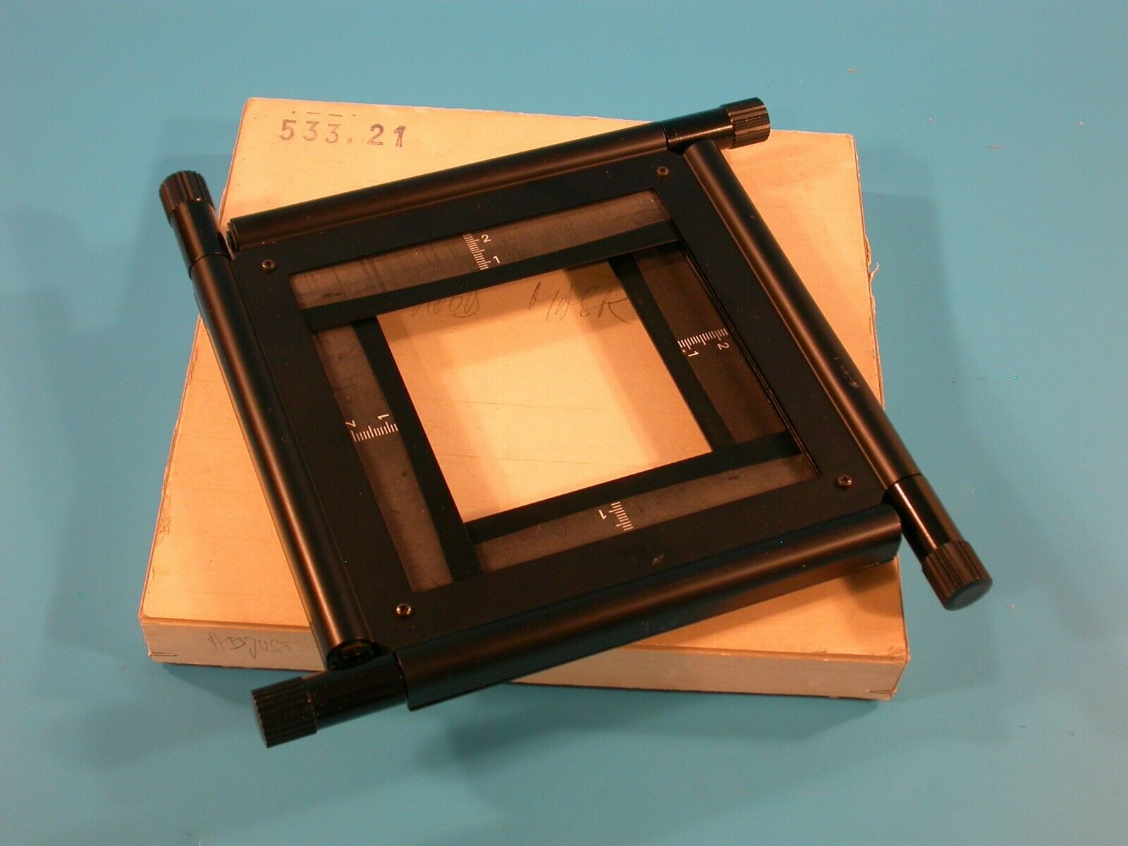

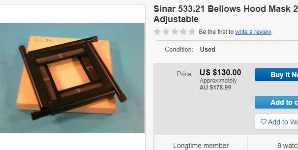

... the compedium shade has several advantages, you can trim the window depending on the situation, for example if you use shift rise movements or if you shot near, and you may also use square filters.
This is probably the ideal shade for View cameras:
Quite cheap for the excellence it provides
Still, what makes difference is not having bellows too compressed or too extended, those are the situations provocating insane flare !
I bought the mask (Thank you 138s), Jim at Mpex is in the process of setting me up with the bellows, clips, lens boards etc... It will be cumbersome, but what the hell its not like the sinar is all that mobile. I'll hand hold the filters for now -- something I've had to do often in the past.
