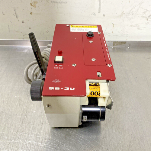

Look on eBay for this: "AP Film Cassette Opener - Bench / Wall mounted film cassette opener"
It'll make quick work of the most stubborn cassettes. You'll feel like a butcher because it's so merciless.

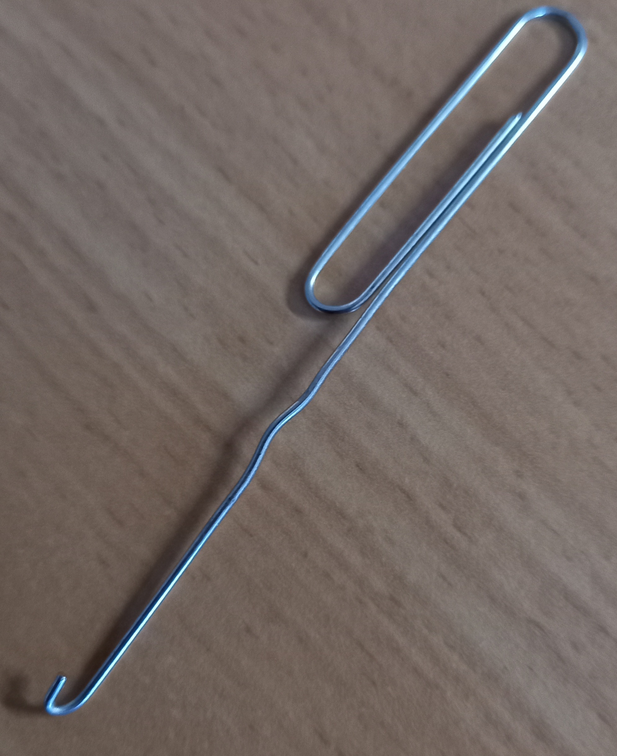

Fancy tools and trinkets?
No, not at all.
Grab a paper clip, the biggies are better, and unwind one of the legs; at the end, use a pair of pliers to make a hook — just a very small one. Insert into cassette and a couple of wiggles and you've got the leader.
If you have a 'reasonably modern' SLR — the electronic wunderkinds that dominated photography in the 1990s and are still highly sought after, for many of these big guns the leader can be programmed to be left out of the cassette upon rewinding (as does my vintage EOS1N). That's the fun part. But it is critical to immediately mark or bend the leader once out of the camera so you can be sure it is an exposed roll! Spoken from early teary lessons!! 😢

I prefer making sure the leader is not being pulled into the canister.
That should work OK provided you don't want to reuse the cassette. If you do, this approach will damage the felt that makes the light trap.
My preferred approach is to just open the cassette with a beer bottle opener. This works especially well on the older/original FUJIFILM cassettes, which can then be re-assembled and reused many times. On Foma cassettes, it also works, but these cannot be reassembled as nicely as the Fujis. Kodak cassettes require a good bit of force to come apart and sadly are one use only. I hang on to my Fuji cassettes for this reason; fortunately, I've got a whole big bag full of them.

Yes, works most of the time, but as I posted after the thread, it is much easier to 'program' the camera to leave the leader out; I realise this isn't possible for many cameras, as evidenced by me continually missing the leader on rewind in my little Olympus XA! I pinch the felt trap to prevent like piping (not reuseable cassettes). Hama made an excellent leader-extractor many years ago (among other very useful trinkets); uncommonly seen now except perhaps at gear swap-meets.

Back in the early 80's when I managed a 1 hour photo finish lab this is what I used.
It works better than 99% of the time. I rarely ever had to do it twice.

I had one of those and sold it.
